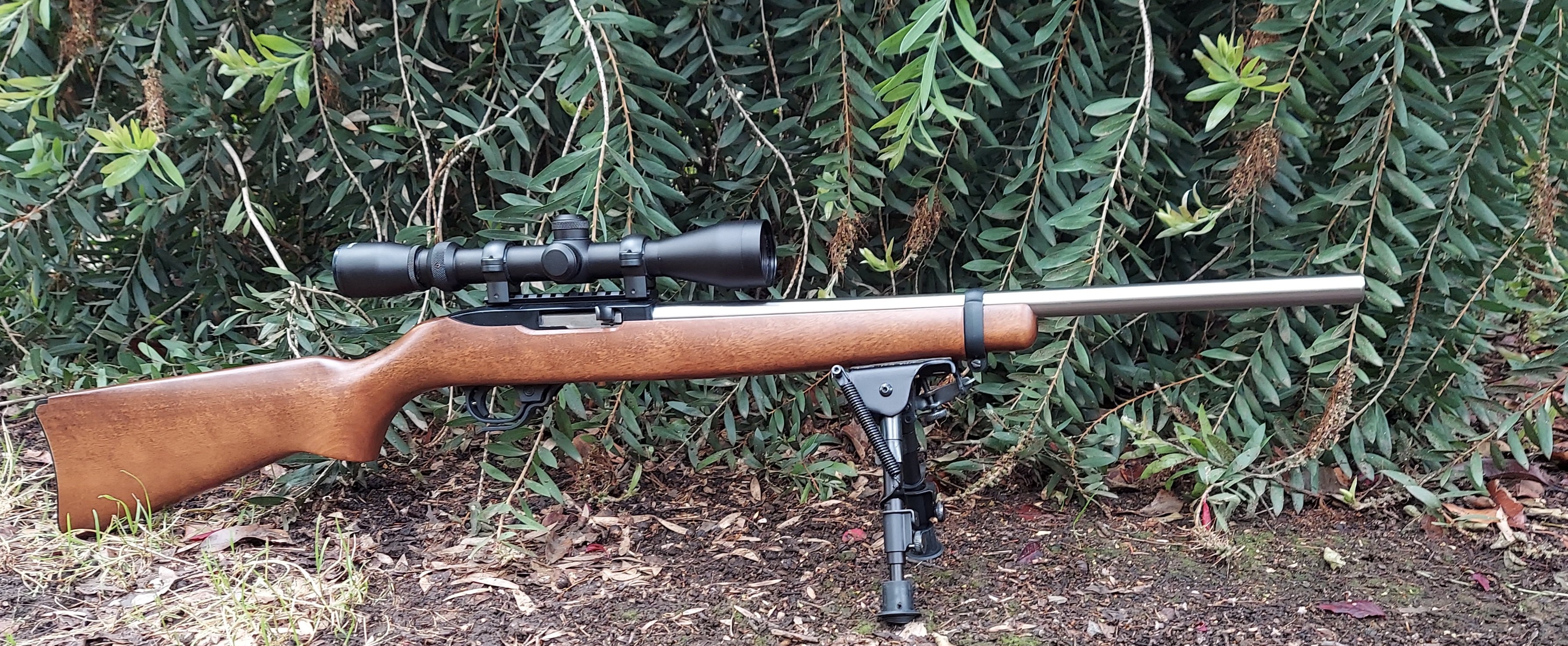

Opened up the barrel channel for a free float and installed a new GM 19" heavy taper barrel. Nice snug fit, had to lightly tap it home. Then bedded the barrel a few inches in front of the action. Opened up the barrel clamp, so as to not touch the barrel.
#3 trigger job. Also added a bipod stud.
Added an Athlon Talos 3-12x40 not shown.
