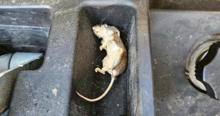

My ZTR mower engine had been running very poorly & unevenly recently. Now, I'm a decent mechanic, and prefer to do most doable DIY repairs myself...But, I'm by no means an expert small engine mechanic. And, after looking into every single thing that I thought might be causing the problem, and to no avail... I finally broke down and took if to someone who fixes all types of power equipment for a living. Here's what he found!
He ran a bore scope down inside the fuel tank, and found a very dead, and well preserved little mouse that had found it's way INSIDE and was blocking the gas flow to the engine. Cost me $80, but I guess it could have been much worse...And, I'll be making for dern certain that the gas cap is on good and tight out in the storage shed from now on!

My question is how did he get in there? Did he chew a hole in the gas tank?
I’ve had a ground hog chew a hole in a tiller tank. Stupid animal.
I remember that I left the gas cap off, but only for a few hours while I ran an errand requested by the wife, and also to get more fuel on the way. That had to be when it happened...And, the only logical explanation, as there's no other way in. Won't make that mistake again!

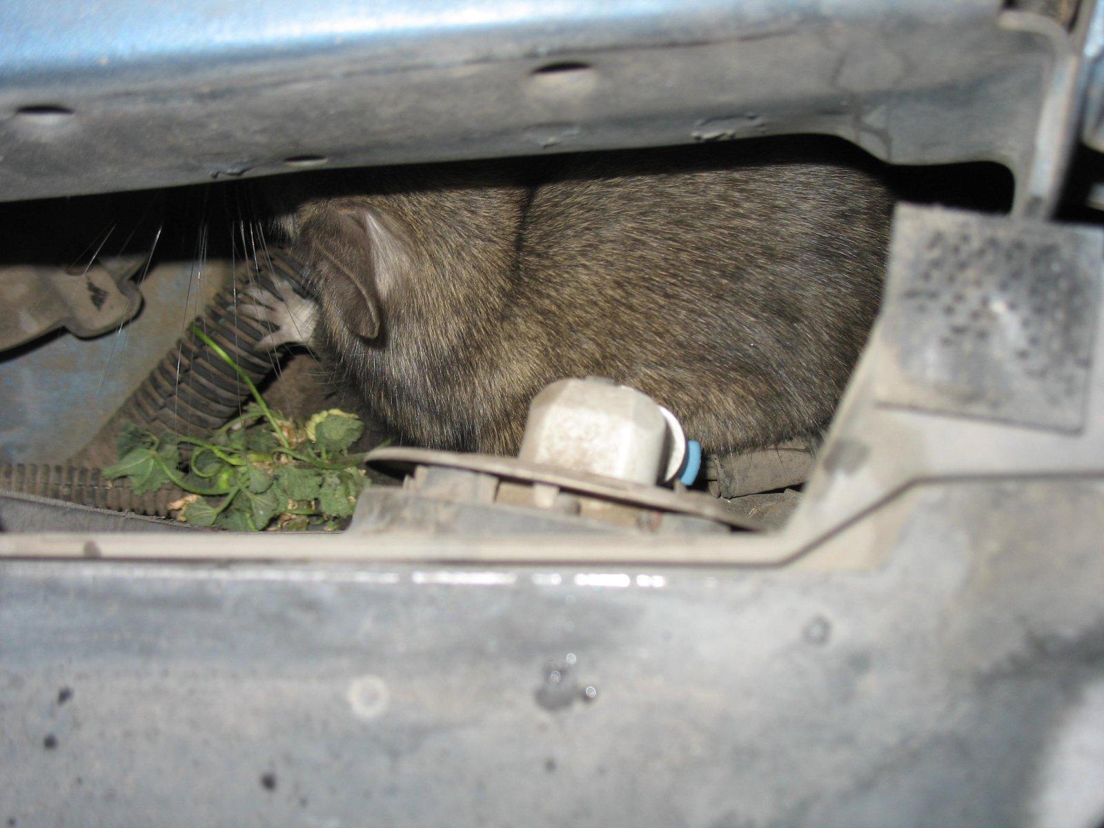

Packrats have eaten the sparkplug wires on my truck twice while I was camped out here in the high desert and completely disabled my Explorer to the point of it having to be hauled out on a flatbed. While I was living in town, one got in behind the headlights on my '88 Grand Prix and stripped every wire in there. I tried all the miracle remedies like peppermint, mothballs, steel wool, etc. (They really liked the peppermint. Kinda like mouse candy) None of those did anything. Now l leave my hood up and covered my sparkplug wires with clear tubing. It slows them down, but it doesn't stop them.
