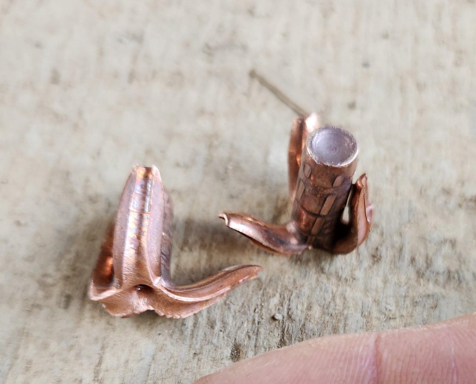

Just for reference, these are 200 grain Maker REX projectiles fired at 1000fps into water jugs at 100 yards. They expanded to over 1.15"
Makers are really good bullets. I have not tried them in 300, but in 350 Legend they are devastating.

Often we find the Lehigh bullets under the far side skin of deer but may be missing a petal or two. Utterly devastating internal damage.
