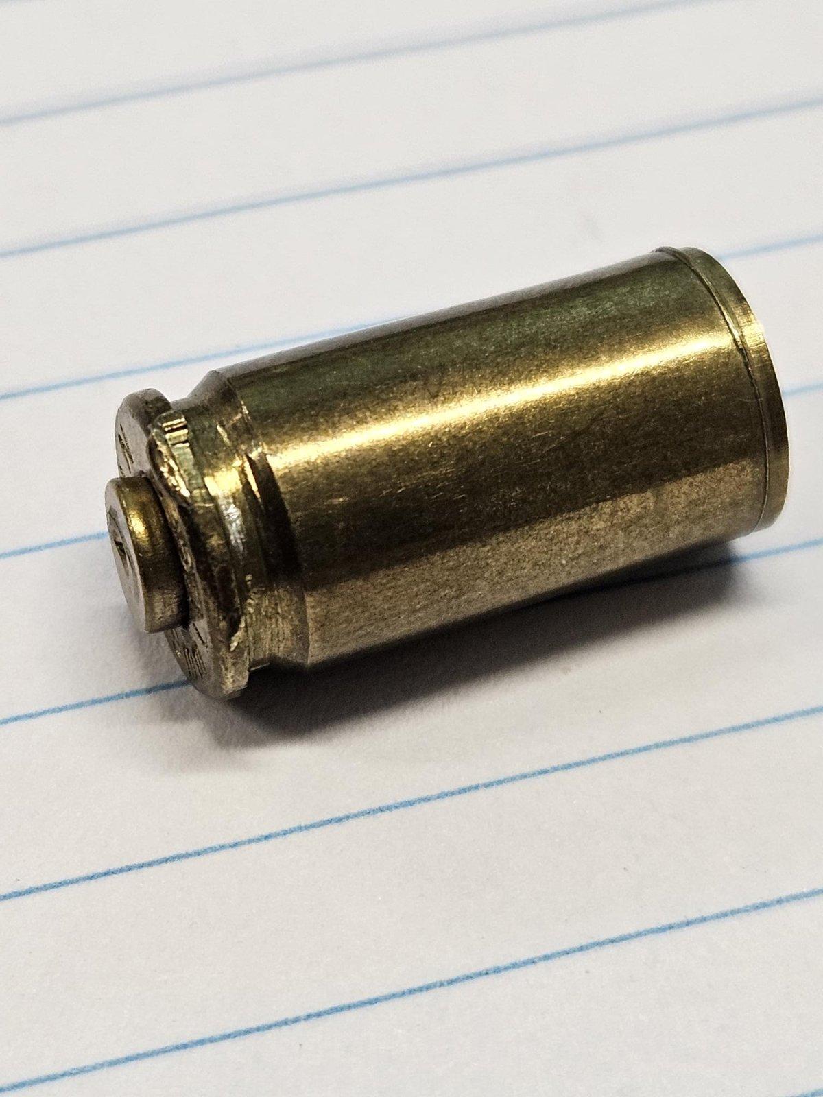

Not a squib, but don't know what to call it.
I was shooting at a range and fired a round that sounded and felt just like a squib. I was shooting a G17 and the slide wouldn't budge no matter how hard I pulled.
I was able to pull the slide lock with some difficulty and remove the slide from the frame. The barrel was still jammed and I couldn't remove it from the slide. I could see a gap about <1/16" between the case head and the breach face and the extractor claw had gouged the rim and was lodged about about half way into the edge of the case rim. I believe that this caused a lot of friction between the primer and the breach face preventing the barrel from unlocking from the slide.
I ended up putting the slide in a vice and using a dowel to drive the barrel down and it came away from the frame. The cartridge came out of the chamber and still had the bullet in the original position. I checked the extractor and firing pin. Everything looked fine so I reassembled the gun and kept shooting.

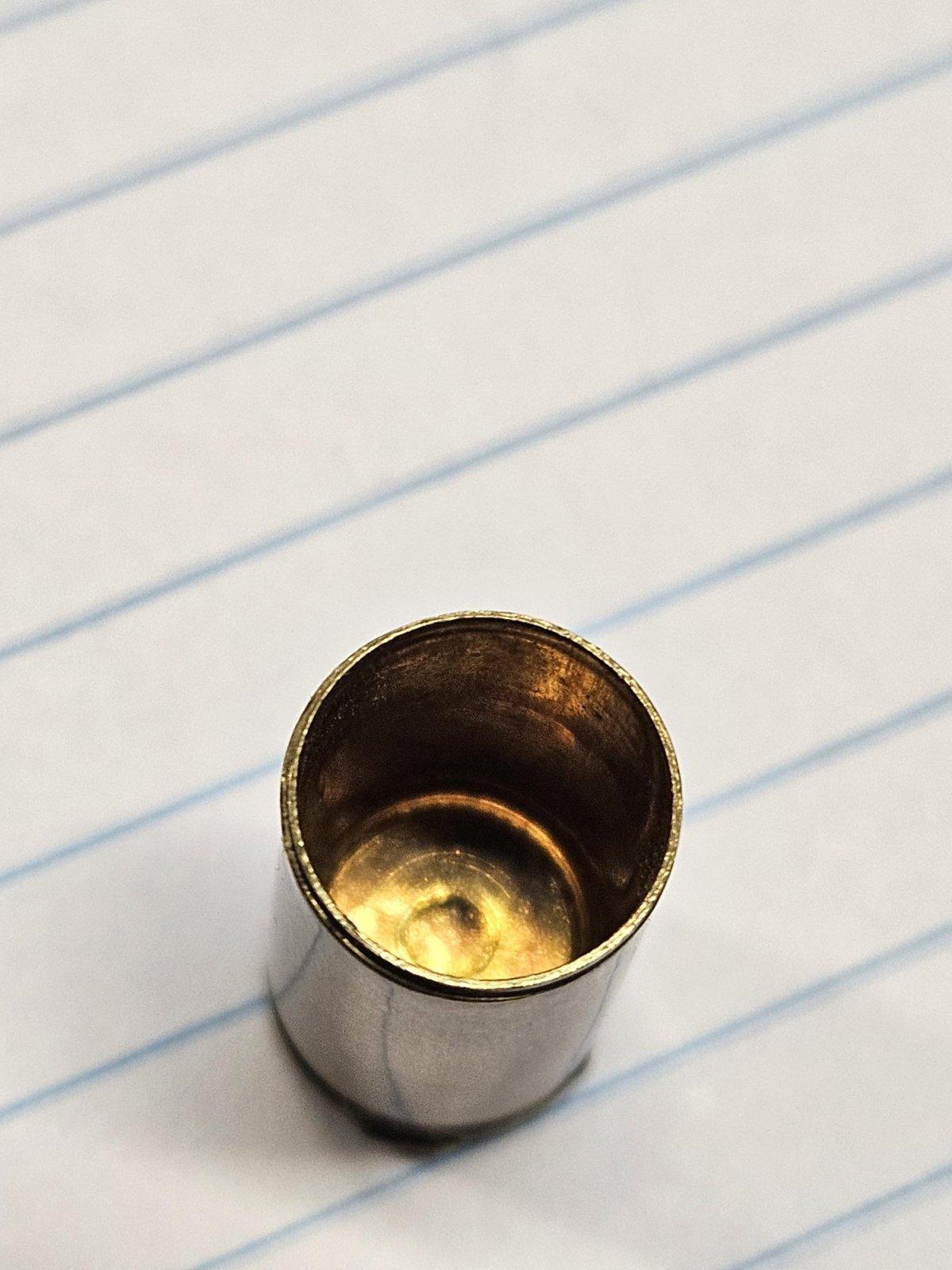

A few weeks later I posted about it and someone said that it sounded like a case with no flash hole and that he had heard that there had been several lately.
I had kept the round as a souvenir of sorts, so I put it in the bullet puller, knocked the round out and found that it had a powder charge, and also no flash hole as suggested.
I hope to never have anything like that happen with premium self defense rounds because if it had happened in that scenario the only backup would have been a second gun.

"A few weeks later I posted about it and someone said that it sounded like a case with no flash hole and that he had heard that there had been several lately."
I have a virgin Hornady 6.5Creedmoor case on the shelf above my loading bench. There is no flash hole. OOPS at least it didn't make it through the loading process.

I presume this "flash hole in the case" y'all are talking about is in the primer? These are just terms I've never heard of... I don't reload.
The flash hole is supposed to be in the case between the primer pocket and the main side where the powder is. You can also see that the primer and case were being pushed apart with enough force to partially press the case past the chamber into the barrel (see below). You can also see where the extractor deformed the case rim.
