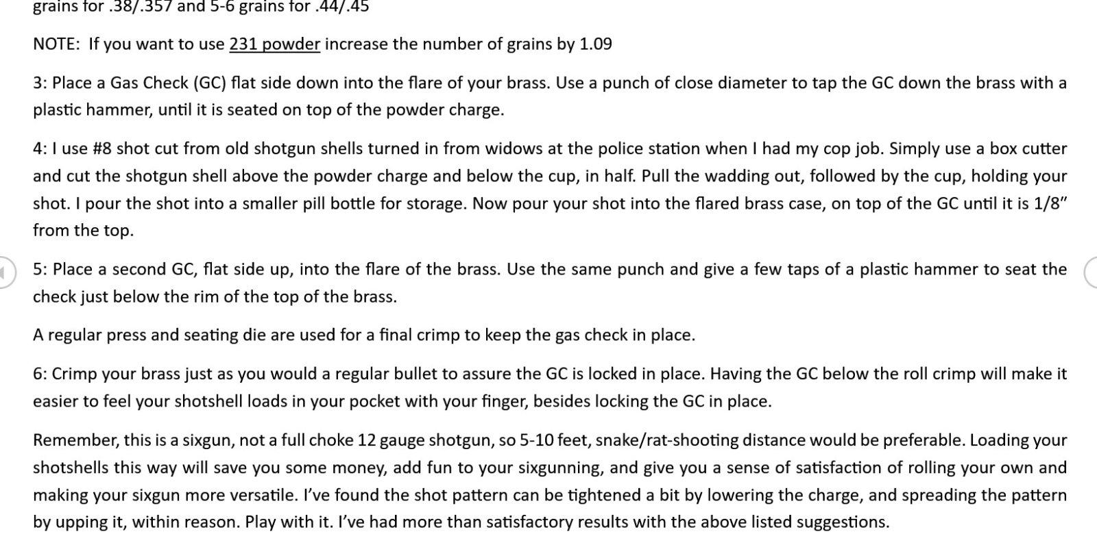

Attempted to call Speer this morning. After dialing their number five times and ending up in voice mail all five times, I finally gave up. Decided to make my own .357 shot cartridges the old way using gas checks. Originally did it this way back in the late '60's. They worked then and certainly should work now. The Hell with Speer!
They work better in my opinion, you can get more shot in the case by using the gas checks.

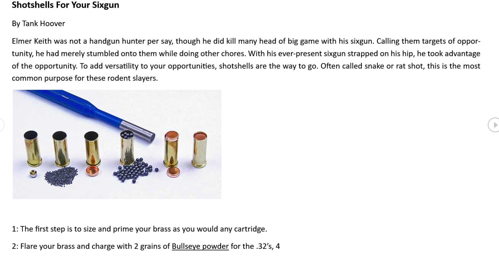

Had the following as a DOC file so had to convert to JPG in order to post. IMO another option and no waiting:

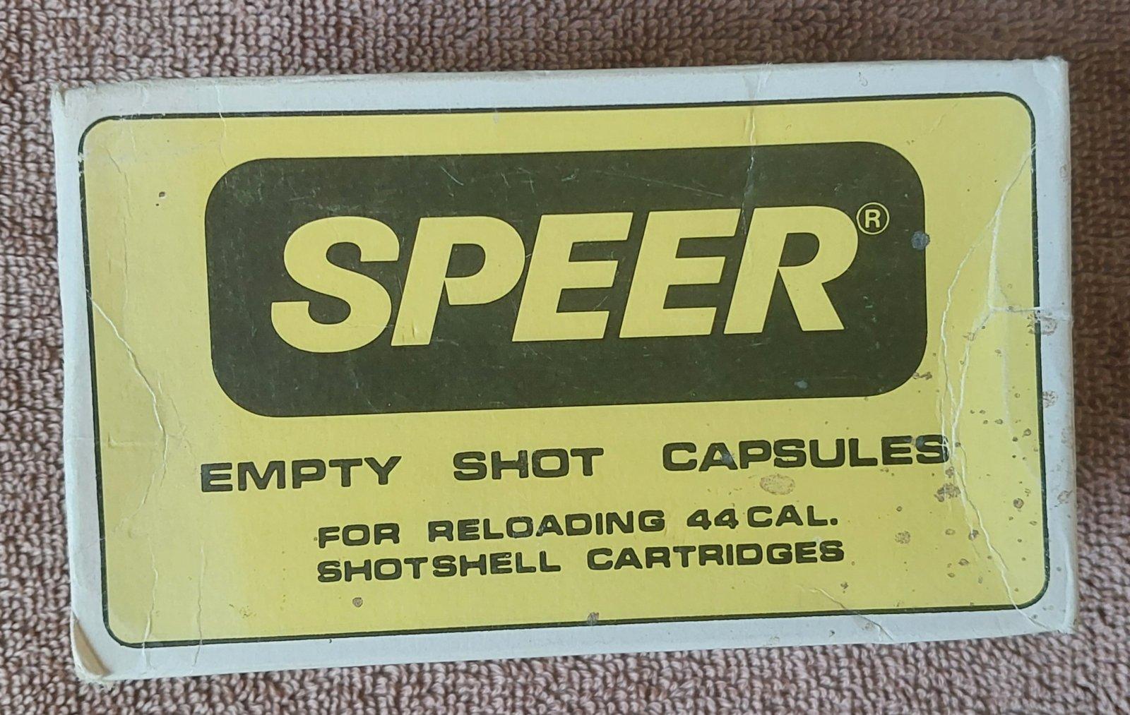

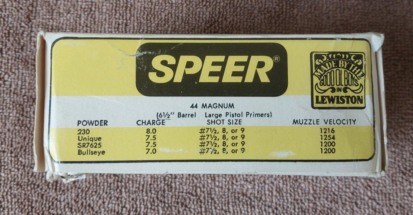

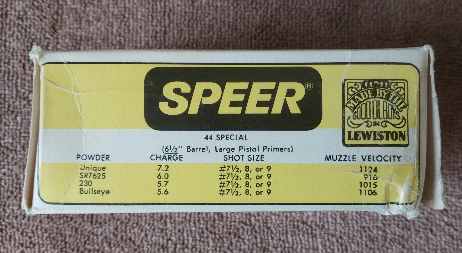

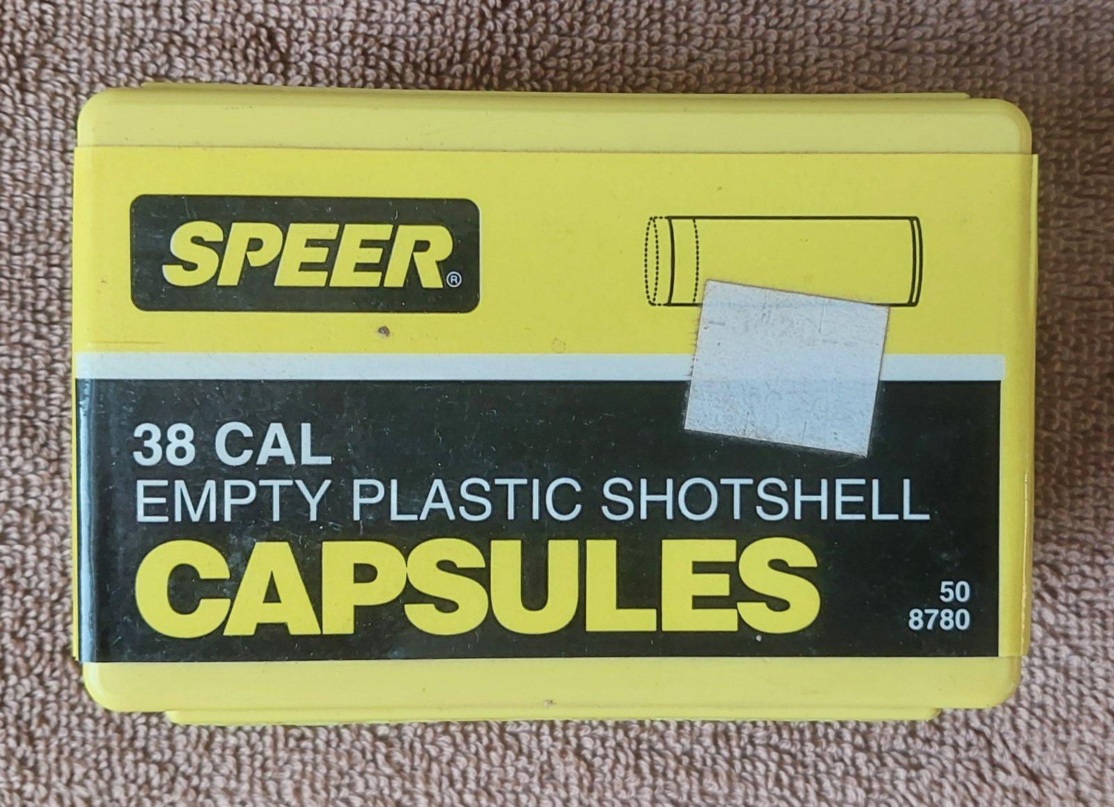

I have 1 box of .38 and 1 box of .44 stashed away. $25 @ plus $10 shipping.
I think there is a box of .38 on GB.
