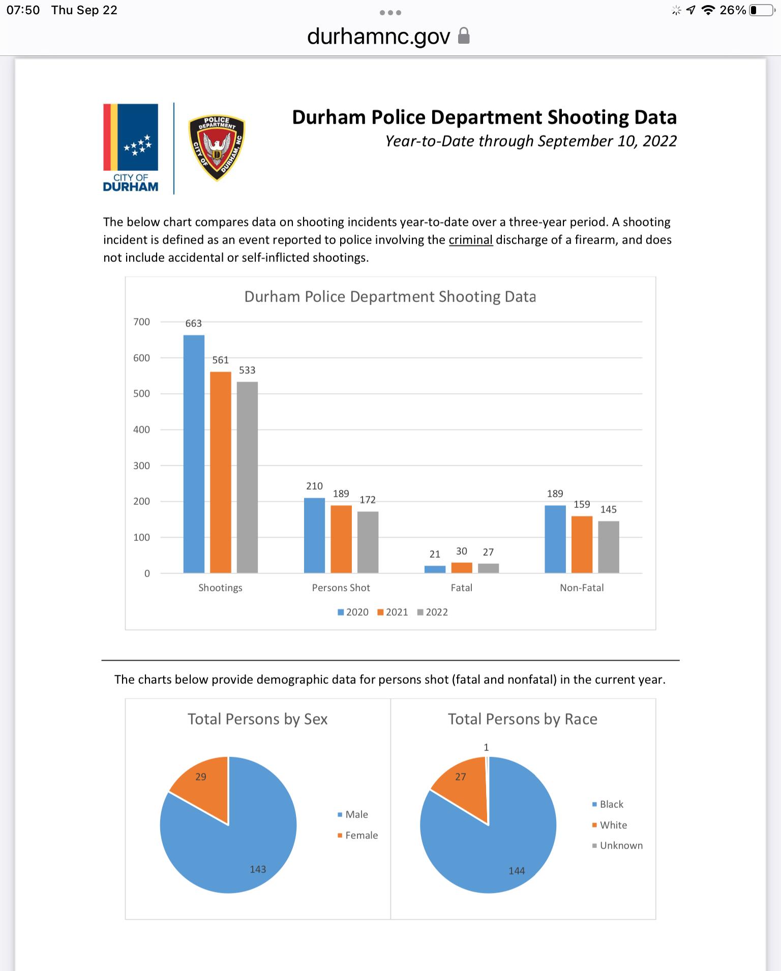

Thanks. it mirrors the FBI data base. Out of 172 shootings where someone was shot, 144 committed by 12.5% of the population, 84%! It is the same on a National basis.
