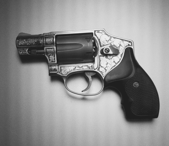

The S&W was bought new many years ago. I had a friend who was getting into engraving do the work on this when things were slow for him. I shot Buffalo Bore hard casts in it one time and they locked the gun up. Too much recoil I guess. I had a gunsmith go through it and no harm done thankfully. I sent the cartridges to Buffalo Bore and they said the pressures were ok. Lesson learned, very light weight revolvers may not function reliably with very stout loads. Some few years back I was able to buy a big supply at low cost of factory XPT bullets and have loaded them with good results.
