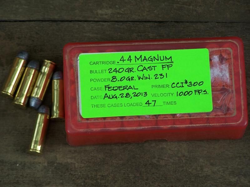

Why are your empty .38 Spl. and .357 Mag. cases even onthe ground? Mine go either back into the box, or into my pocket. I loke for the empties to go back into the box as I keep a count on how many times those cases have been reloaded.
After cases have been loaded ten times I use those only for mild plinkin' loads.
