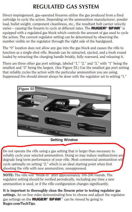

I'm new this forum and the proud owner of a SFAR 308 win 16.1" barrel. So far, I've run a couple hundred rounds through it and it functions well but seems to be hard on brass, it gouges the base of the case head. I've seen lots feedback that this is due to over-gassing and recommendations to set the gas block to the #2 setting to prevent over gassing. When I set it to the #2 setting the gun has ejection and feeding malfunctions. I've run several different factory loads and handloads through it and it malfunctions frequently with all types of ammo on the #2 setting. I don't mind leaving it on the #3 setting but don't like it damaging my brass.
I'm thinking that the gas block may not be perfectly aligned with the port on the barrel. Any recommendations on what I can do to fix this?

Yes, I ran most of the 200+ rounds with the gas block set to #3 as it frequently malfunctions at #2 setting. Ruger recommends using the #2 setting in their manual.

They say “Most commercial ammunition will …..” not ALL.
So, it’s not an exact science. Be interested to hear what Ruger thinks.

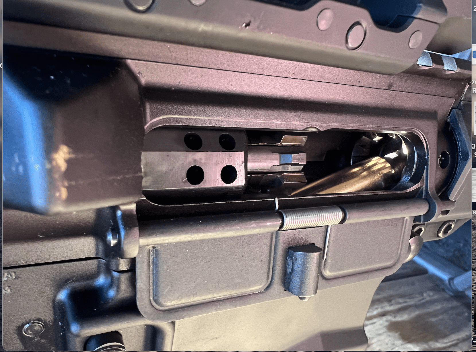

My SFAR doesn't reliably cycle. The bolt rides over the cartridge around every ten rounds and won't hold the bolt open after the last round at a similar frequency.
I've cleaned the gun, disassembled the BCG, lubed everything, and tried different magazines. The bolt in my SFAR is super tight in the carrier, which may contribute to the issues. The fact that Ruger describes a break-in procedure is troubling, as any firearm should function reliably from the factory.
Bringing a sub 7lb AR in .308 to market for $1k has got to be a challenging engineering feat, but the gun should run right out of the box. The issues I'm having have been reported by others so I don't think it's a one-off situation.

The pics shown are fairly classic failure to fully cycle the bolt. Did you try a few drops of CLP in the little holes in the side of the bolt carrier?
The usual suspects are a mis-aligned gas block, wrong size gas hole in the barrel (or obstructed gas port), or roughness on the interior of the bolt carrier.

I expect it's the bolt and or the machine work on the carrier. The bolt is very tight in the carrier.

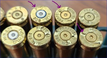

Is there any recent (2023) news from Ruger on the SFAR issues that many owners have experienced? I am nearing 250 rds in my 16" SFAR and still not able to get to #2 setting on the gas block without jams. I also experienced a lot of brass head gouging in the 1st 100 rds but that has eased now and is occasional light extractor marks. . I also initially had frequent failure of bolt hold open, with and w/o mags. I replaced the bolt latch with an old AR15 latch and that worked so far. I have recently started experimenting with buffer weights with an ODIN adjustable buffer but too soon to know if it helps any.
I have not contacted Ruger as I am not eager to send the gun in and also not eager to start over on break-in requiring hundreds of expensive rounds.
I have owned a lot of different guns over many years and never heard of this kind of breakin requirement.
Sure would like to hear recent experience from others....

If I were testing the rifle, I'd call this under gassing. I just looked at the pictures posted of the case heads and you have a serious problem with your bolt face. Pull the bolt and look carefully at the bolt face(or post a picture). There's something badly wrong. If it was just the circular imprint of the ejector, I'd say your ammo is over pressure but it seems there's several brands of brass (factory loads?). That tearing (gouging) shouldn't happen.
Shoehorning a .308 system into a .223(ish) platform has some drawbacks and handling the consequences can be tricky. One of those issues is; how much gas is enough and how much is too much. Gas port size, gas tube length, buffer weight, BCG weight--all these things ride a very fine line of works/doesn't work.
Again, look closely at your bolt face and determine just what is digging into the brass.

Actually... I read an earlier review of the SFAR. The reviewer said pretty much the same thing about the gouging of the brass when on the "factory setting". Fortunately, he turned the adjustment to 2, his rifle continued to function, and the brass gouging went away.
To clarify the pic I posted... All were factory rds, no reloads. The most damaged rds were in the 1st 100 fired in the new SFAR, and the Perfecta 308s show the most damage. Recent tests (nearing 300rds) show almost no marks on brass...

Here's a photo, gleaned from the internet, of cases ejected from a SFAR. From this handful of cases, they don't all share the same disfigurement. But then, in this handful of cases, they don't share the same headstamp, either.
