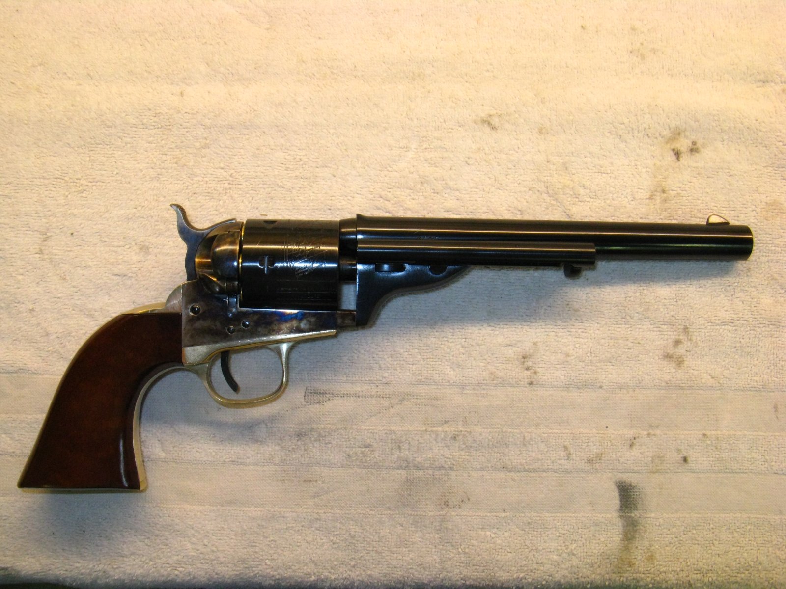

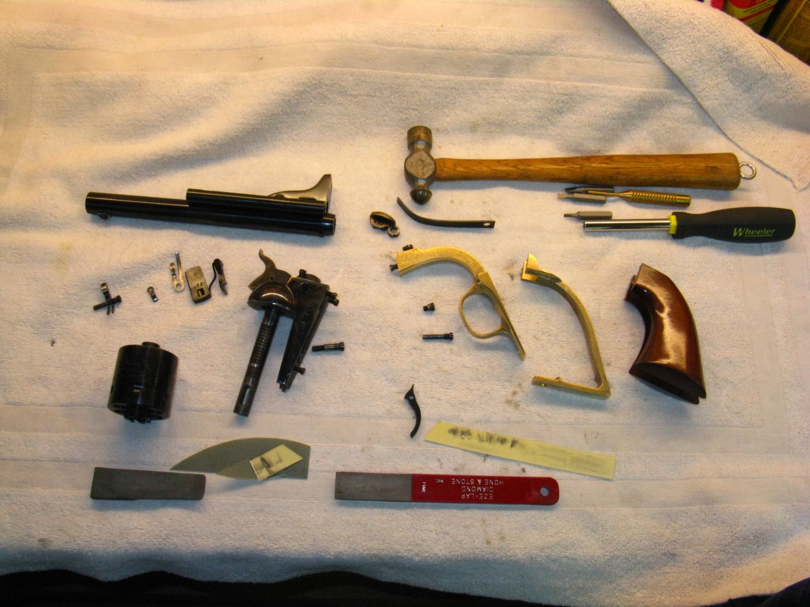

I bought a Cimarron 1872 Open Top Navy in 38 Special that was pretty rough internally. I disassembled it, inspected each part under a magnifying glass and carefully smoothed each surface with the tools and components shown. Very helpful was the fine diamond encrusted "hone and stone" since most of the parts were hardened. The result is one of the smoothest action revolvers I own.
