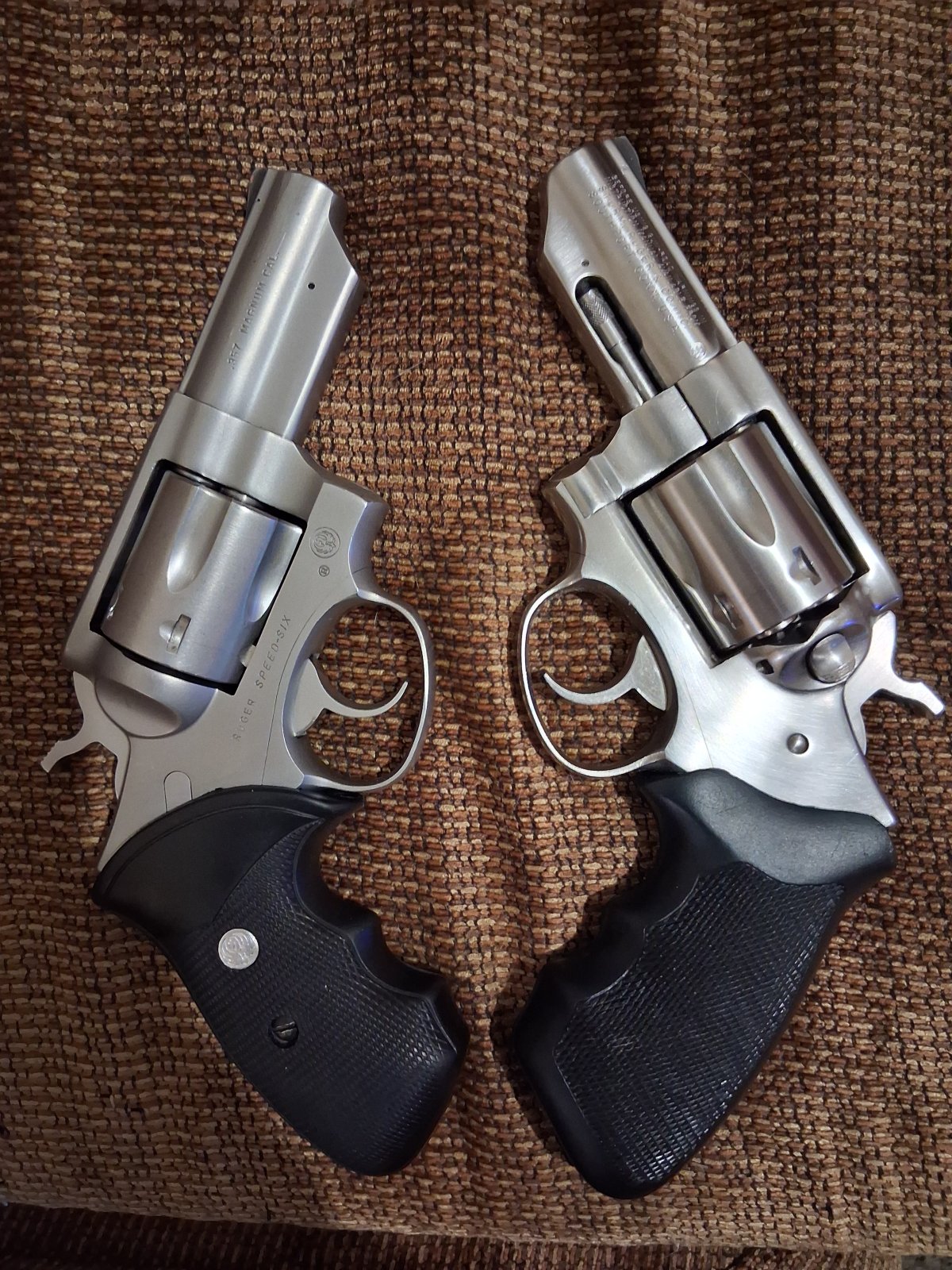

I'm a sucker for the true 3 inch guns, they're my favorite of the Sixes! I managed to find a GF-33 a few months ago, I have a USPS model too. What's really interesting is the barrel profiles are different on my two, the barrel on the PS is sharper while the barrel on the Service is smoother. I noticed this in pictures before, I've seen both barrel types on the PS models but the others (GF-33, 83-NYCPD) all have the smoother profile. I'm guessing the design was changed early on but so far haven't been able to find anything concrete. The only other thing I can think is maybe some 4 inch barrels were to cut down to 3 but I doubt it. My money is on the design being changed.

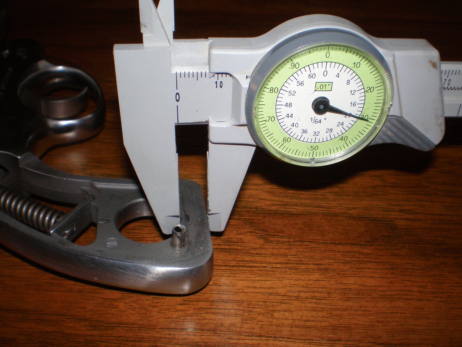

I knew about the material being moved to the top strap, I'm not 100% on this one but I believe the square butt frame and round butt frame have slightly different dimensions. The bottom of the grip frame where the SN is stamped is just a hair shorter (bottom of the grip to the bottom of the circle) on the round butt than it is on the square. If one were converted from square to round at the factory my guess is the conversion would be done before the SN was stamped and the dimensions would at least be close to a legitimate round butt. If it were done outside of the factory the SN would be stamped already and the bottom ledge of the grip frame would retain the square butt dimensions. Thats just a guess but I have a feeling small differences in the dimensions have something to do with it.
I know measuring the bottom of the grip frame is how people were able to figure out the round butts marked PSS were originally square and converted but I never looked into it too much. Normally if it's not one of the known ones like the PSS I just assume it wasn't done at Ruger. I saw one recently that was really disappointing, a GF-33 someone round butted.

Here are my two 33s, can you see what I mean about the barrels?

Hitman is referring to Speed Six round butt guns mis-stamped as "Police Service Six". They letter as Speed Six and the grip frame measurement, see my previous post, above, confirms they are actually factory round butt guns and not "homemade" (by grinding off the square heel of the square butt) round butt.
We've identified approximately a dozen mis-stamped guns. Rare, indeed.
Two were included in a shipment to the San Francisco Sheriff's Dept. as part of an order of Speed Sixs. They were shipped nearly 4 years after manufacture. One wonders if quality control set them aside and then included them with a shipment to a police agency figuring the agency wouldn't mind or notice. I have one.
