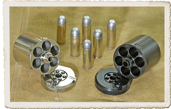

While stocking up on some shooting supplies recently, I noticed Kirst Konverter LLC now manufactures a cartridge conversion cylinder for the Ruger Old Army in .45 ACP.
And it is rated for any non plus P .45 ACP load, including using jacketed projectiles.
The Kirst unit has a non rotating cylinder back plate and one robust firing pin.
The other conversion cylinders on the market have rotating cylinder back plates and six less than robust firing pins.
I had seen some online chatter about the firing pins on the rotating cylinder back plate style having firing pin problems. (mushrooming from hammer strikes)
All of the cartridge conversion cylinders on the market in the .45 Long Colt chambering require "cowboy action shooting" power level loads and lead projectiles.
That, along with .45 Long Colt being a cartridge I don't use or own any firearms chambered in that cartridge, convinced me that .45 ACP was the more intelligent caliber choice.
I stock plenty of .45 ACP ammo, and reload for it as well.

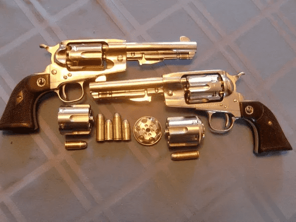

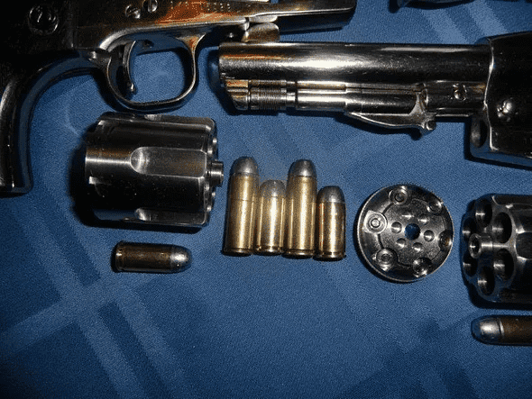

I have shot many rounds of 45 colts both BP and smokeless with no problem out of these along with cap and balls in SASS. Having lighter hammer springs may help the firing pin (18#) problems you speak of.
Wow some of you make this cleaning way to hard. ;) ;)
