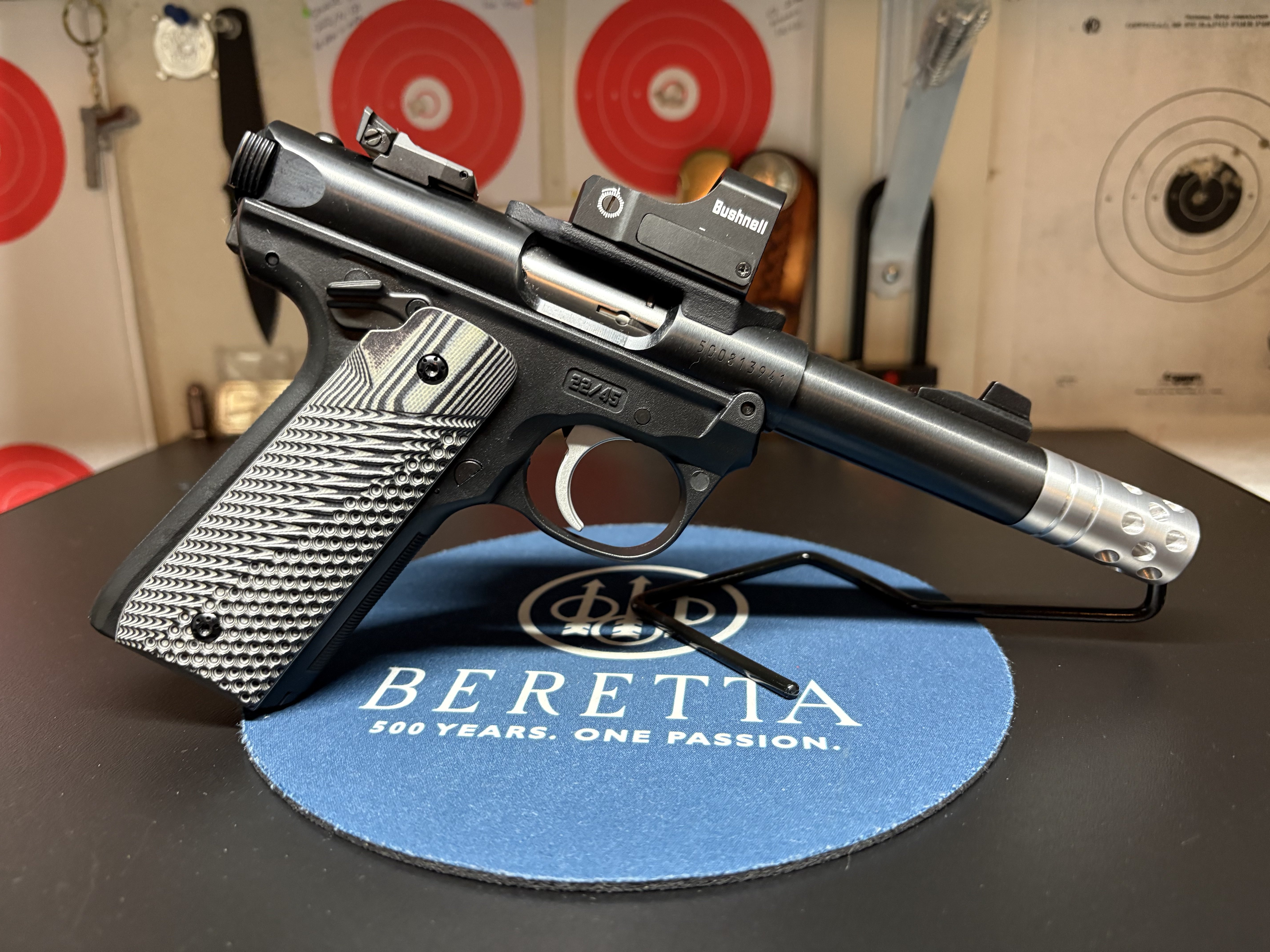

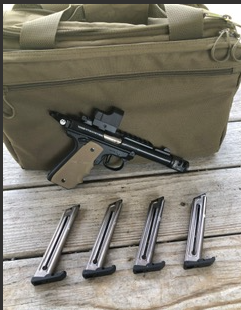

Just picked up a 22/45. Ordered a mounting plate from armadyne for holosun 507c. Will post pics once mount arrives. Pretty excited to take it out
Just picked up a 22/45. Ordered a mounting plate from armadyne for holosun 507c. Will post pics once mount arrives. Pretty excited to take it out View attachment 99099

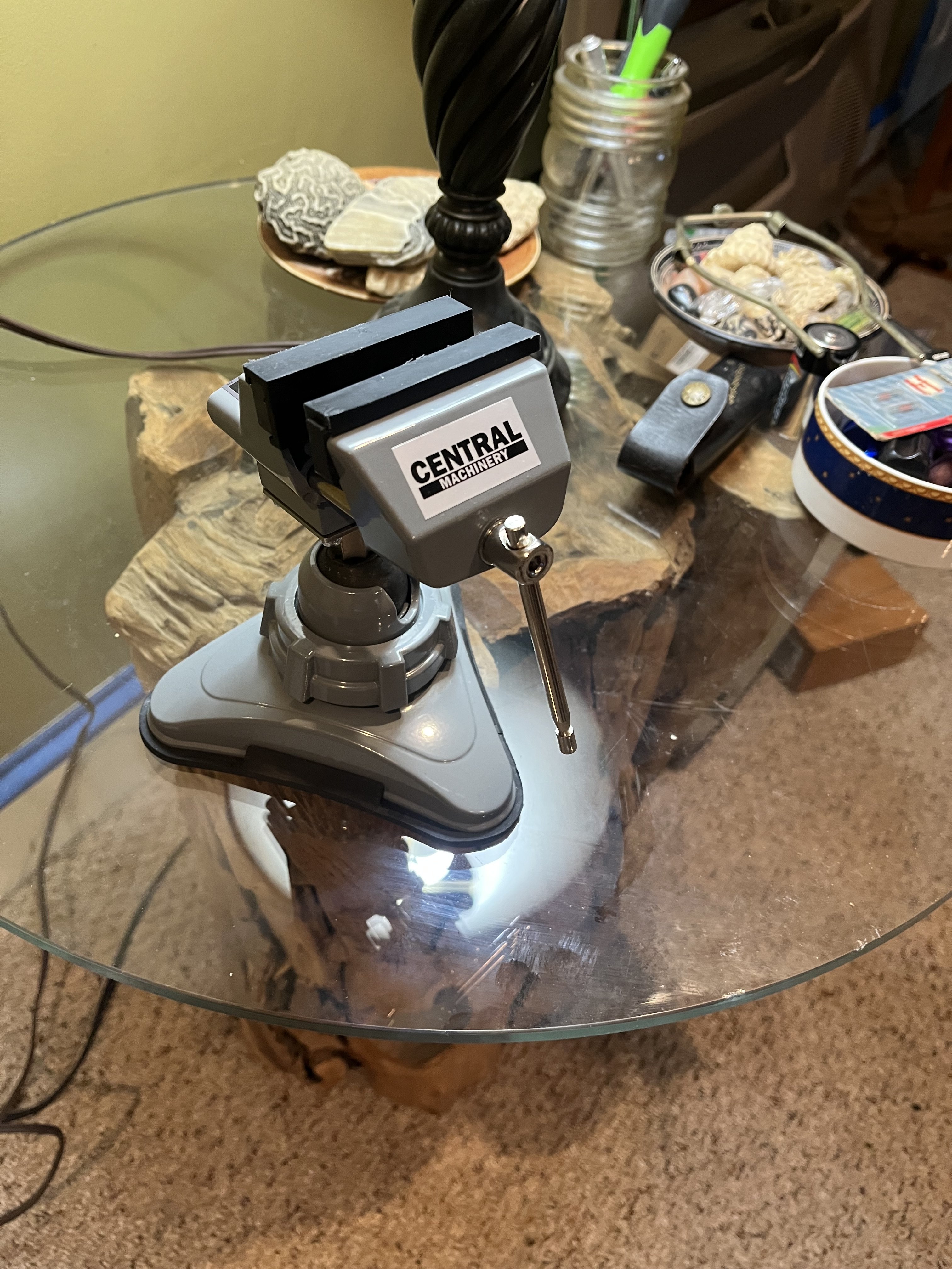

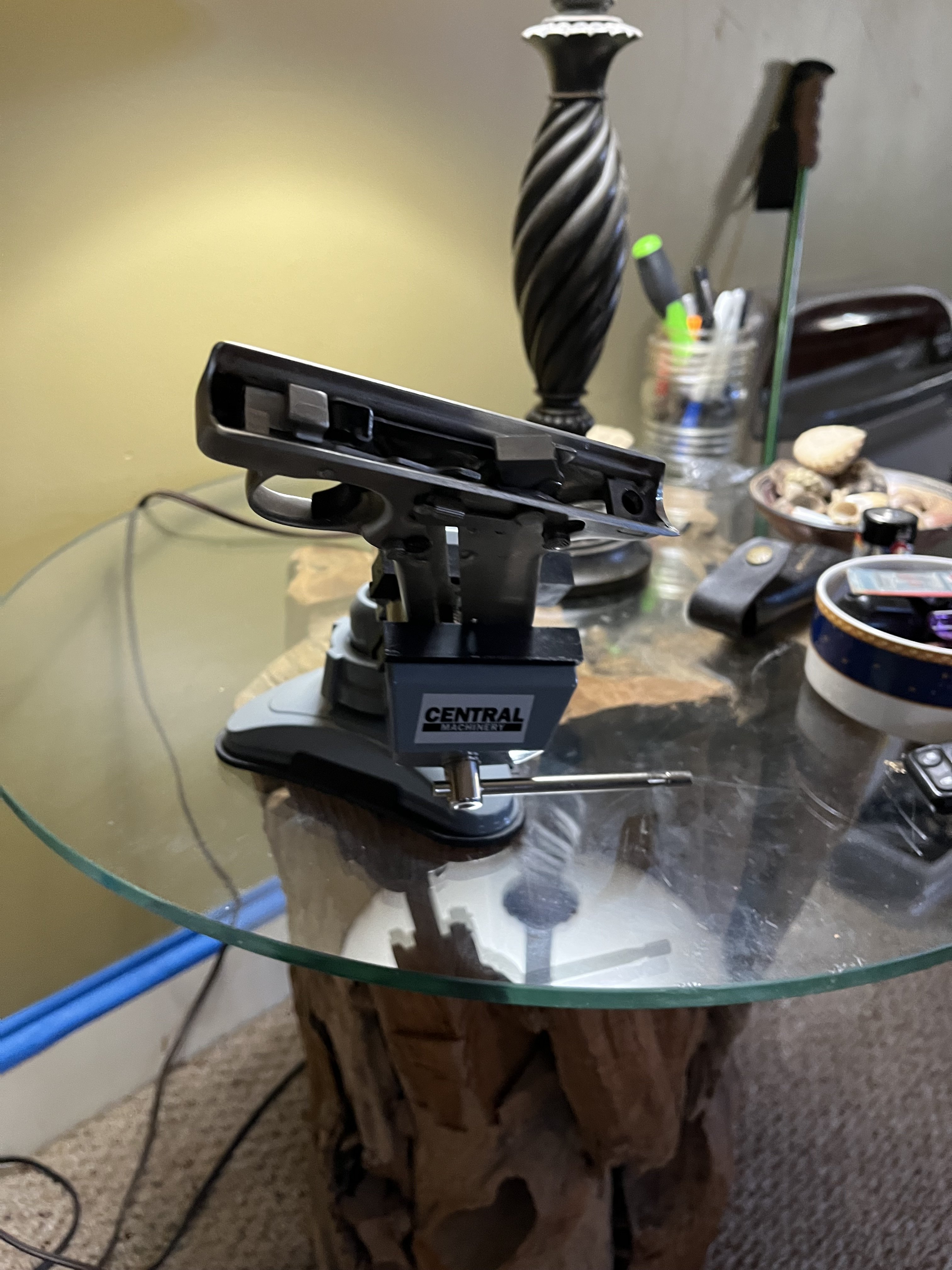

When installing the VQ.., You will want a small articulating vise like this hobby vise from Harbor Freight for $25.

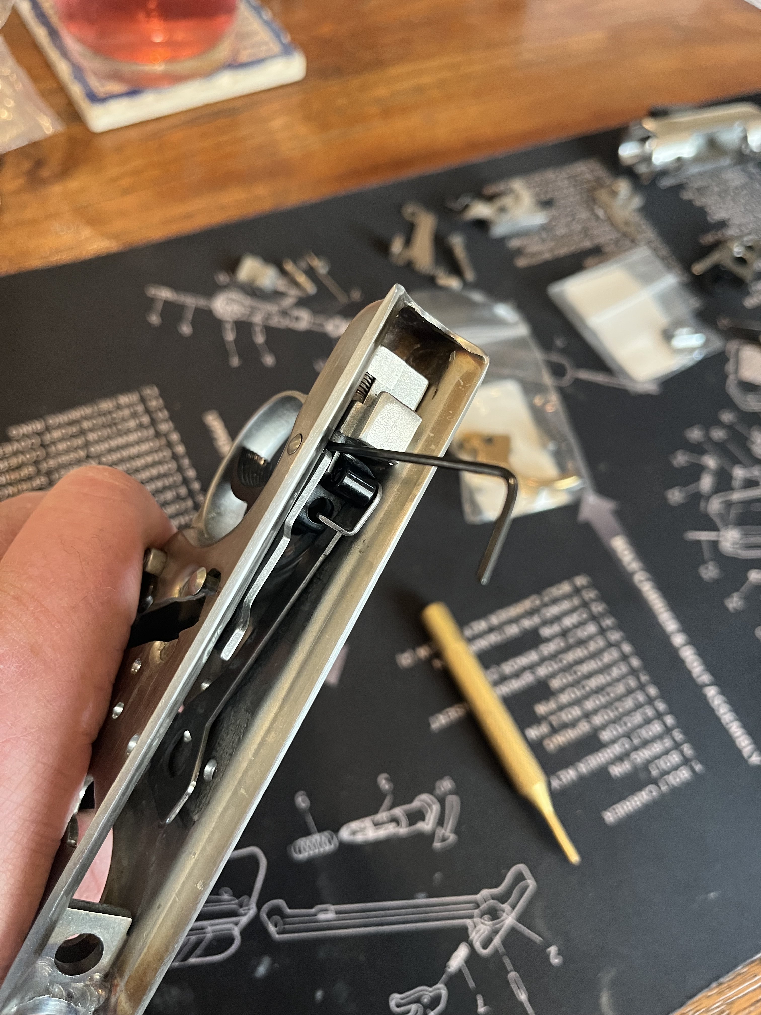

It is very very tricky#1. #2.. We are not kids like the boy in VQ’s installation video is. #3.., VQ used a professional video company to make that video and there was much editing to make it look easy.
#4.. Do NOT put your gun parts back together dry like that!! Use grease in every pivot hole and joint.
Coat bolt catch plate to sheet metal body frame as well as same with safety.
GREASE safety detent and TINY plunger or you WILL lose it in installation process.

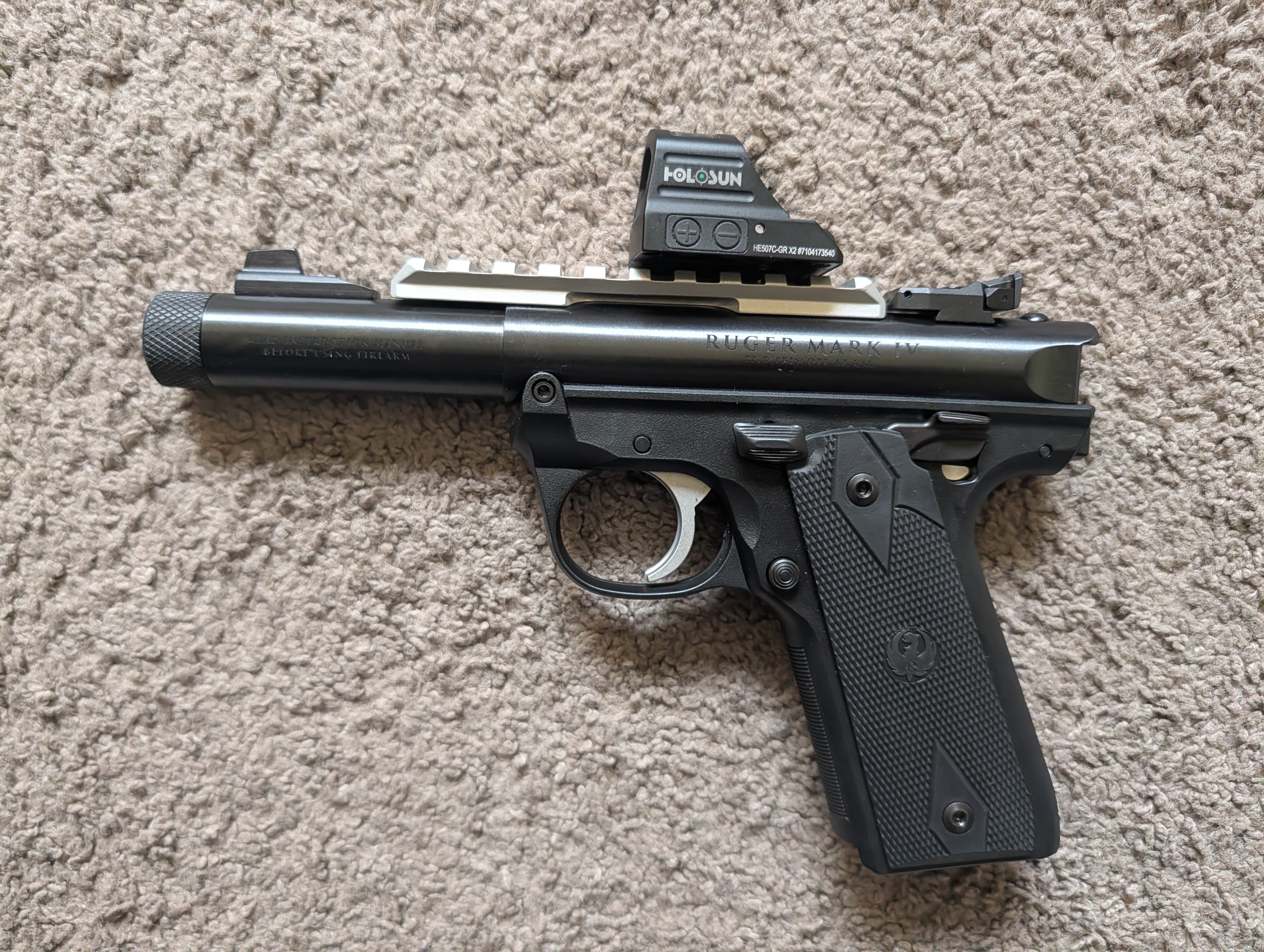

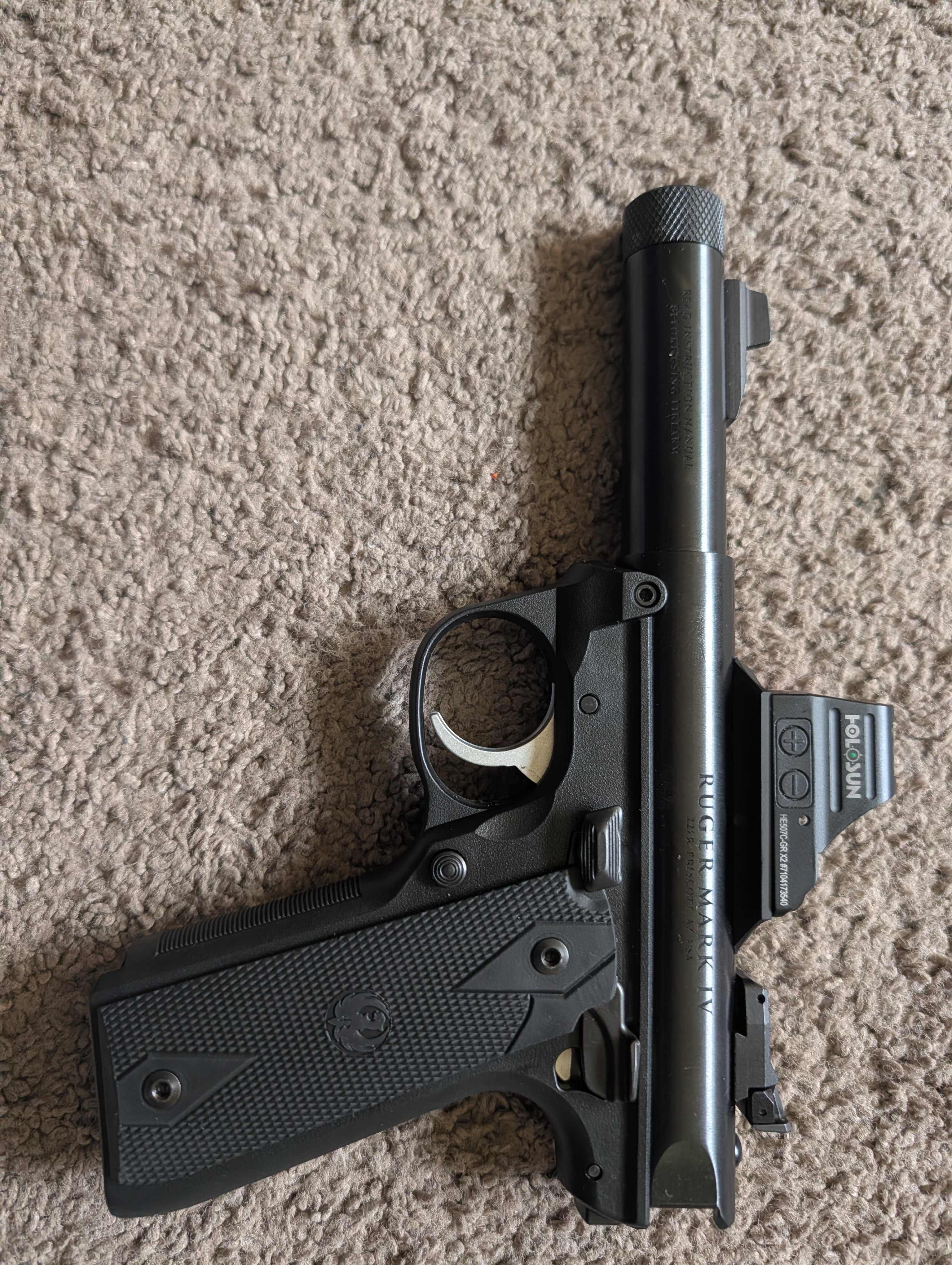

Optic plate arrived. Removed the aluminum rail. I kind of don't like the ugly without the rail with an exposed hole in the upper...Will be buying a pic rail mount from holosun.
