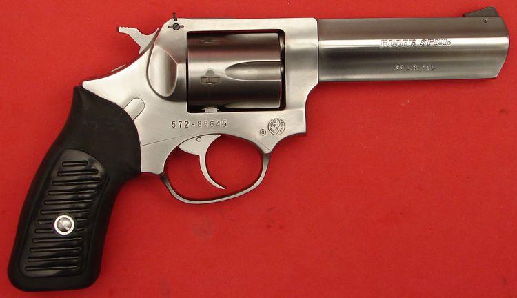

Picked this up on a whim the other day. Very little info on line for this gun. Looks to be fired very very little. Guy advertised it as a safe queen. So may not have been fired since factory. Does have a very faint turn ring. Now I am curious as to it worth and scarcity.

Of the original SP101 revolvers (6-shot, windage-only adjustable sights), your 4-inch full-lug model was the most common.
They also made a 4-inch half-lug, and a 2-inch(?) snubby. Those two are a little harder to come by. I have accumulated a complete set, just by stumbling upon them individually over the years.
I gave maybe $400 for my full-lug about two years ago (don’t have my records in front of me). It was NIB, or possibly LNIB.

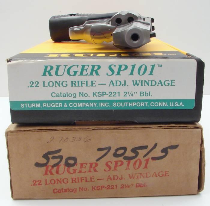

What I recall of the "X" is that was used when the frame was "eXtended" so that the .357 Mag version could handle longer bullets. The original SP was just offered in .38 Special, then subsequently in .22 LR and 9mm. Then the .357 came along but with the 125grain bullet restriction because you couldn't close the shorter cylinder with longer projectiles. There was a significant stock of shorter frames on hand, so they were used up on shorter cartridge models for several years, then the extended frame became standard.

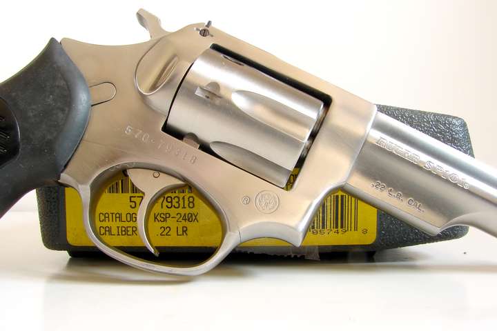

Short and long (eXtended) frames appear to have been made (cast) side by side for close to 200,000 ser. numbers. In my opinion, way too many for a "significant overstock" of short frames when the long frame was introduced.

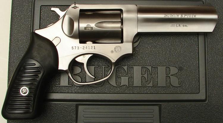

The 6 shot .22LR, in the 3 barrel variations, by model number, were all made in both the short frame and long frame. I believe the 2" long frame is the least common, followed by the short frame 2".
Then, of course, there are the factory high gloss versions which I think are very rare.

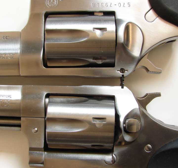

I measured the length of my KSP-241 cylinder and the OAL was 1.565. My .32 has a OAL of 1.584 and my Kelly special has a OAL of 1.579.
So,, just a small difference,, but enough to warrant a different model marking.
