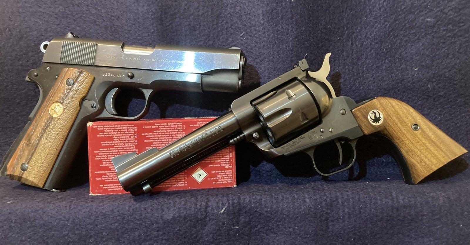

Just picked up a Flat Top in 357 Magnum, unfortunately it was converted. I've gotten hammer, cylinder bolt and spring. Pretty sure I'm correct in that the converted trigger can be used when the dogleg is clipped. Any suggestions on where I can track down a hand, or anything "cross fits"?
Picked up both in Reno while going to this weekend's gun show.
You've come to the right place dsf; the gang will probably be able to help you with the parts you need once everyone wakes up and gets on line.... Super nice gun(s).... the BH will be a LOT better once you get her converted back to the way she should be; looks brand new and beautiful to me.
