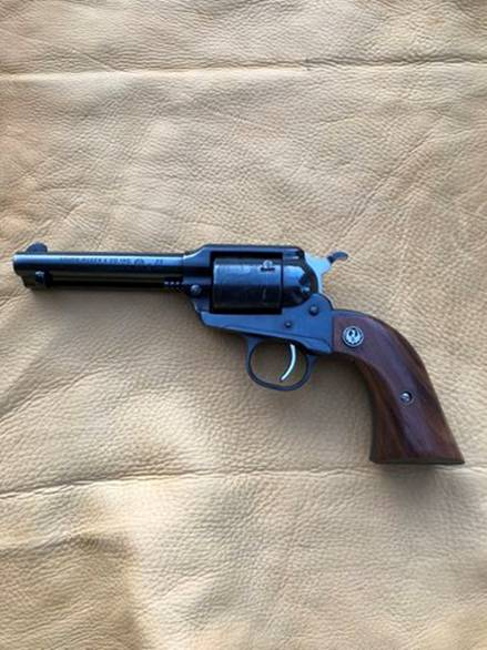

My '73 Old Model Super Bearcat with retrofit transfer bar kit hammer only* installed. The square top grips are homemade.
* with a very slight modification made to the hammer nose, the wide spur hammer can be used in old model Bearcats without all the other transfer bar safety kit parts.
thats a really nice bearcat , i passed on one today i felt condition didnt warrant the sticker , serial put it at 1969 , its gone already so now im wondering if i goofed

Thanks.
