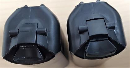

I am shooting a 2016 Ruger American in .223 Rem and have issues with the magazine release breaking. Is it just me or is this a common problem with these plastic magazines?
It seems that these magazin releases are even more fragile during colder temperatures. Are there any better after market mags available?

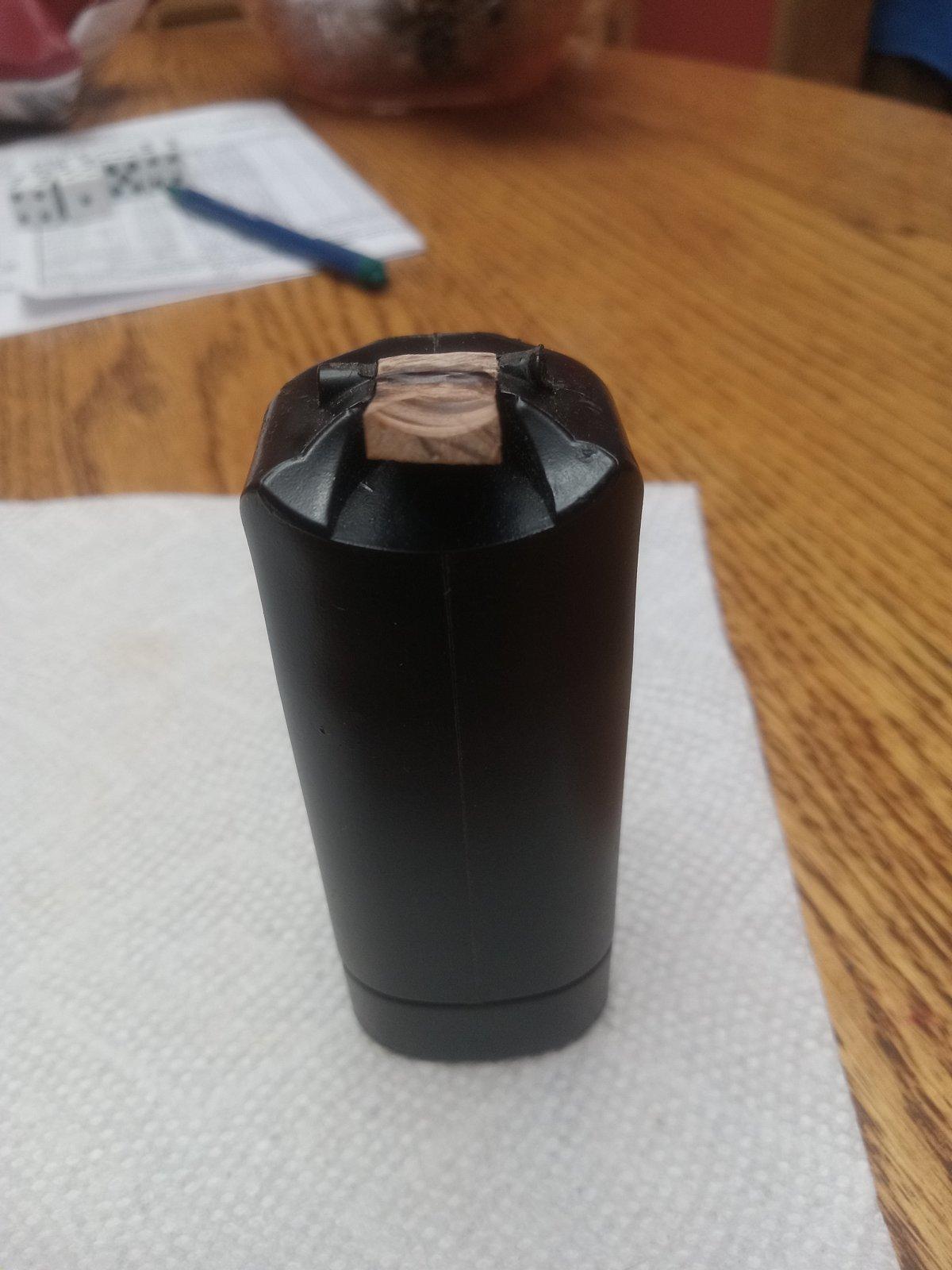

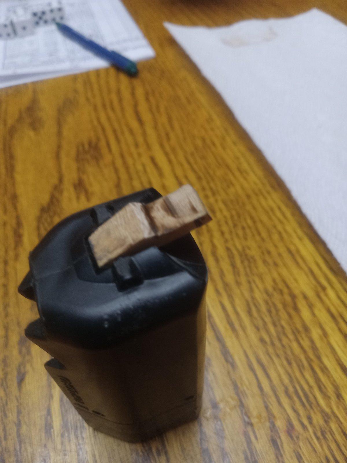

I've just recently broke mine ! Since I'm retired $$ is tight. So I took a piece of hard wood and made one ! I know it's not pretty, but it works for now until I get a new one!!

I contacted the service department because I had just had them correct the head spacing, they had the rifle. Complete with the magazine, I got it back, loaded the mag, went to reinsert it and it fell apart. They told me that it was fine when they had it ! I was outside and it was 20 degrees! But it should've never broke. So I did use a piece of hard wood to make one. I'm now making the latch out of aluminum, that won't break ! I just wish they made the mag out of aluminum!!
