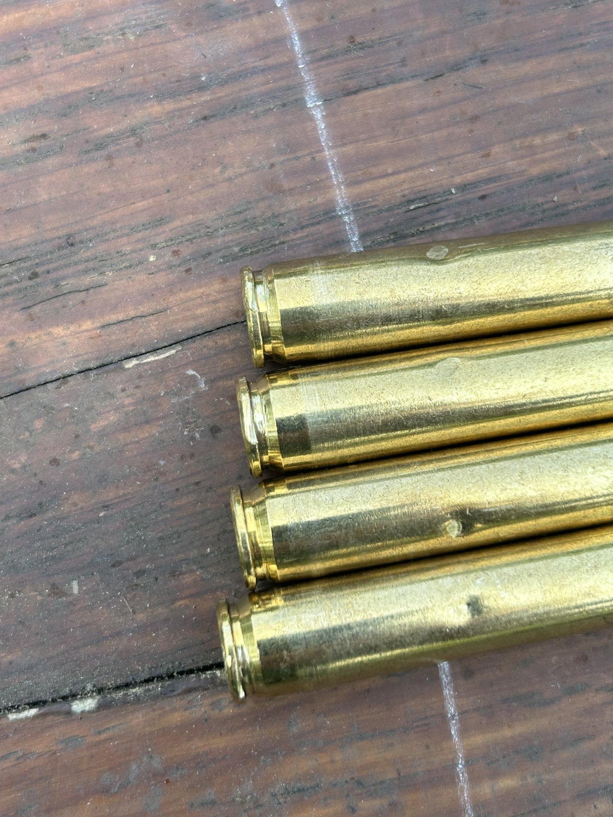

I have a new Mini14 5.56/.223 with less than 500 rounds through it and have been experiencing damage to the casing on ejection. The middle of the casing is getting dented, the primer end is getting burrs and the projectile end is being crushed. It started out with just a small marring on the casing and by the time I got through 90 rounds it had progressed to the above description.
Does anyone have any ideas for what is going on?
I just want to thank everyone for all of their information and suggestions. After evaluating everything I went with the Accuracy Systems Mini14 bushing kit. I went with the.045 bushing. The bushing’s length was oversized so I ground it down to match the original bushing’s length. After putting about 50 rounds through it I was very happy with the results. The casings are now consistently deposited 12-14’ away. There is still a ding in the side of the casings but the crushing of the neck and burring of the primer end has ceased. I may install the.040 bushing in the future but for now I am happy with the way it is working now.
