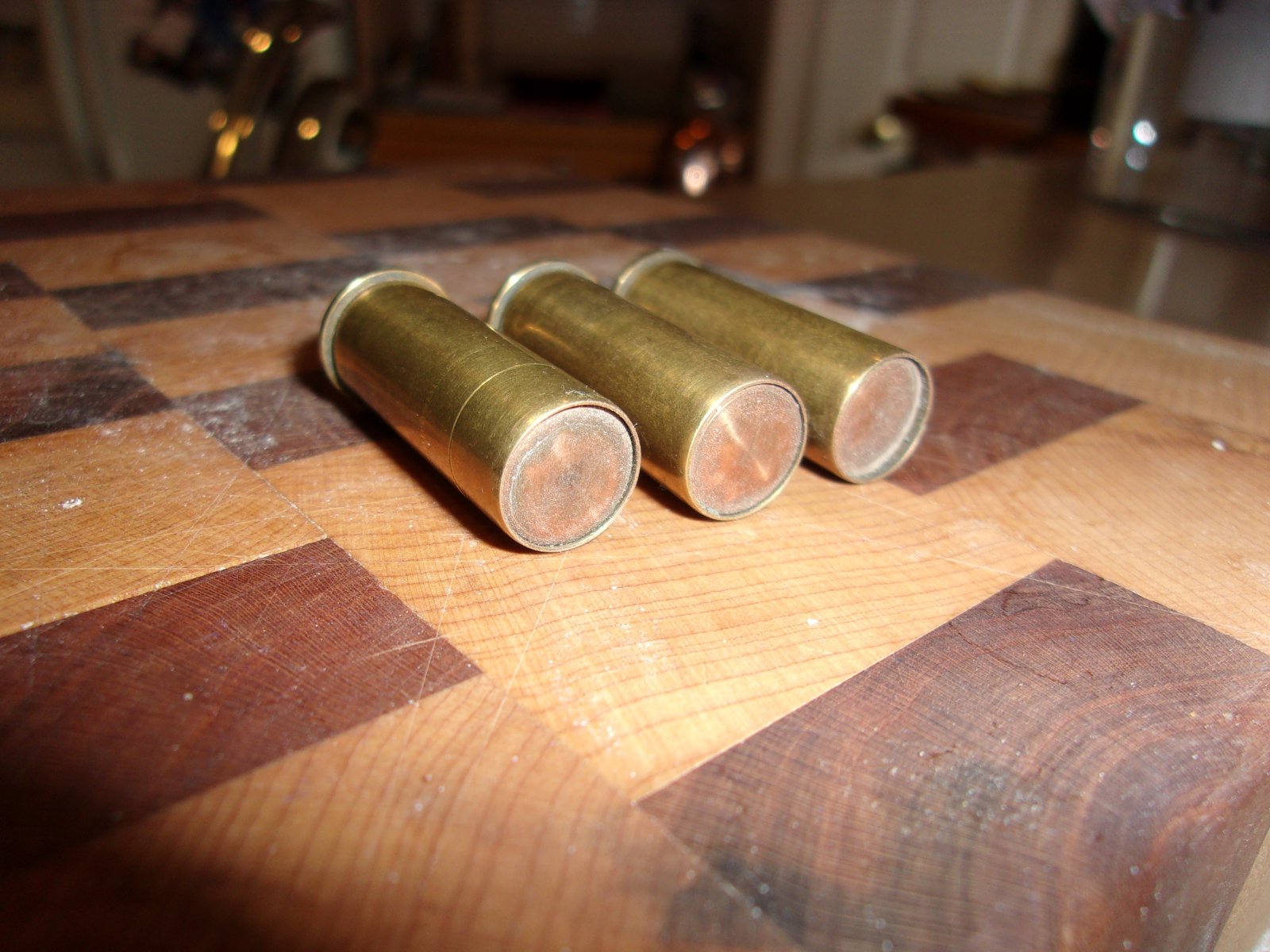

When I get a ground squirrel invasion, I trap them then dispatch them with .22 cal shot shells, shooting right through the trap. I can't get .22 cal shot shells anymore so I've used up some .38 cal shells I had on hand. Now, I can't even get .38 cal. shot shells so I'm in a pickle.
I suppose I can start loading my own .38 shot shells but knowing nothing about number sizes for shot, can anyone tell me what size the shot is in revolver shot shells.
Most over the counter shot for .38 that I've seen is number nine.

Many of the commercial handgun shot shell ammo types use #12 shot. And yes,, #9 is also used. I'd never go larger than #9 though.
Custom loading your own shot shells in my opinion is great. But also, you can select what size shot & why it may be your choice. #12 might be great for ground squirrels,, while #9 might be better for snakes, which may be further away from you & need more energy.
And custom loading your own isn't hard either.

Don't forget guys that I'm dispatching ground squirrels through the bars of a Havahart trap so distance is not a thing. I just don't want to damage the trap.

Ok guys, I have an RCBS auto primer tool that I used for making my .45 cal blanks. I need to get a shell holder for .38 cal. They sell these things by numbers but they don't say what caliber case that number fits.
What number shell holder do I need for .38 cal cases?

I load these. for revolvers. They come with some load data. The tricky part is crimping. Too much crimp and you crack the capsule. You will not see the crack. When you fire, a unfired round can break dumping shot in the works. When crimping listen for a tiny "click" sound. You have cracked the capsule. I would try a light glue (school glue) instead.Don't over fill the cap. That can crack it also. You won't need a press or dies just a way to prime. They can be pressed in by finger into your form fired brass.. https://www.midwayusa.com/s?searchTerm=speer+shot+capsules More options latter. Need more coffee.
Ground squirrels at close range inside a trap, and I'd choose #12 shot to reduce the chances of damage to the trap.
As noted,,, the #6 shell holder works for .38/.357.
It won't take a lot of powder or shot in a .38 spl case for just ground squirrels at close range. A light charge, a cardboard wad on top of the powder, (cut from waxed cardboard if available, such as a milk carton. Using a sharpened .38 spl case to cut some.) Add shot,, then a few more pieces of cardboard wad on top. A light roll crimp, and I like to add wax as a sealer.

To get a bit more technical,, you can weigh out shot to give you a "bullet weight" to match the powder charge you might need. I normally use 148 grn wadcutter info, and weight out a similar (close) amount of shot. Also, after you put in powder, and add a wad, then add the shot,, you aren't "full" you can easily add a little more shot to fill it up closer to the top. I've also done this,, and after I reach a "full" case,, before adding the top wads, I weigh the shot again. If necessary, I reduce the powder charge a bit. But I usually have a powder charge that's well within the safe specs of a little heavier bullet. Remember,, these are designed to be "light" loads.
I use 44 mag cases starting with primer then a few grains of Bullseye then a 44gas check then fillerup with reclaimed traprange shot then upsidedown 44gascheck and heavy crimp. I am sure that can be adapted to any smaller revolver strwalled cartridge. I am guessing that this combo has velocity of 1000-1200fps and is good for Grouse at at least 15 yds outofa OM SBH.
