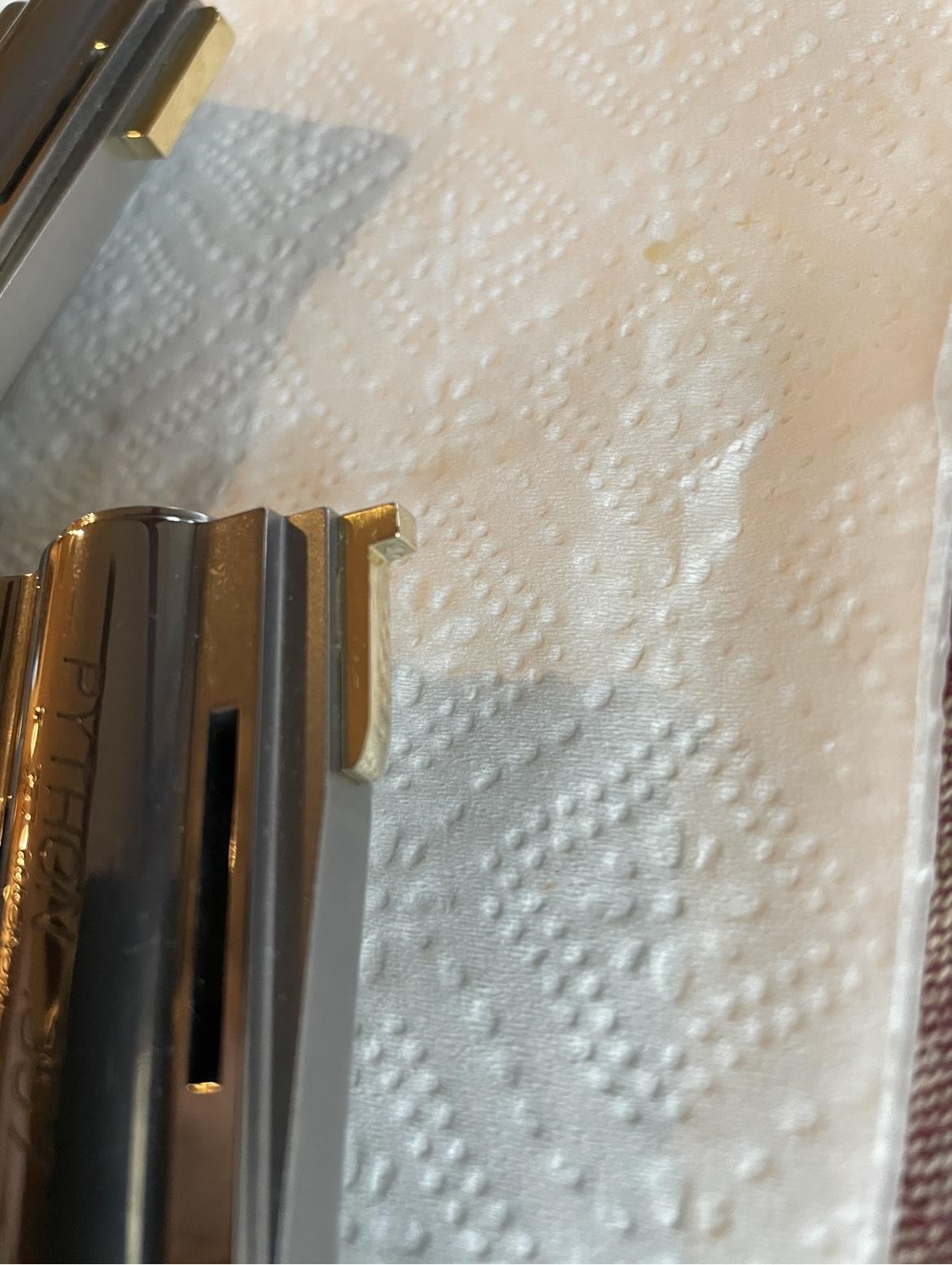

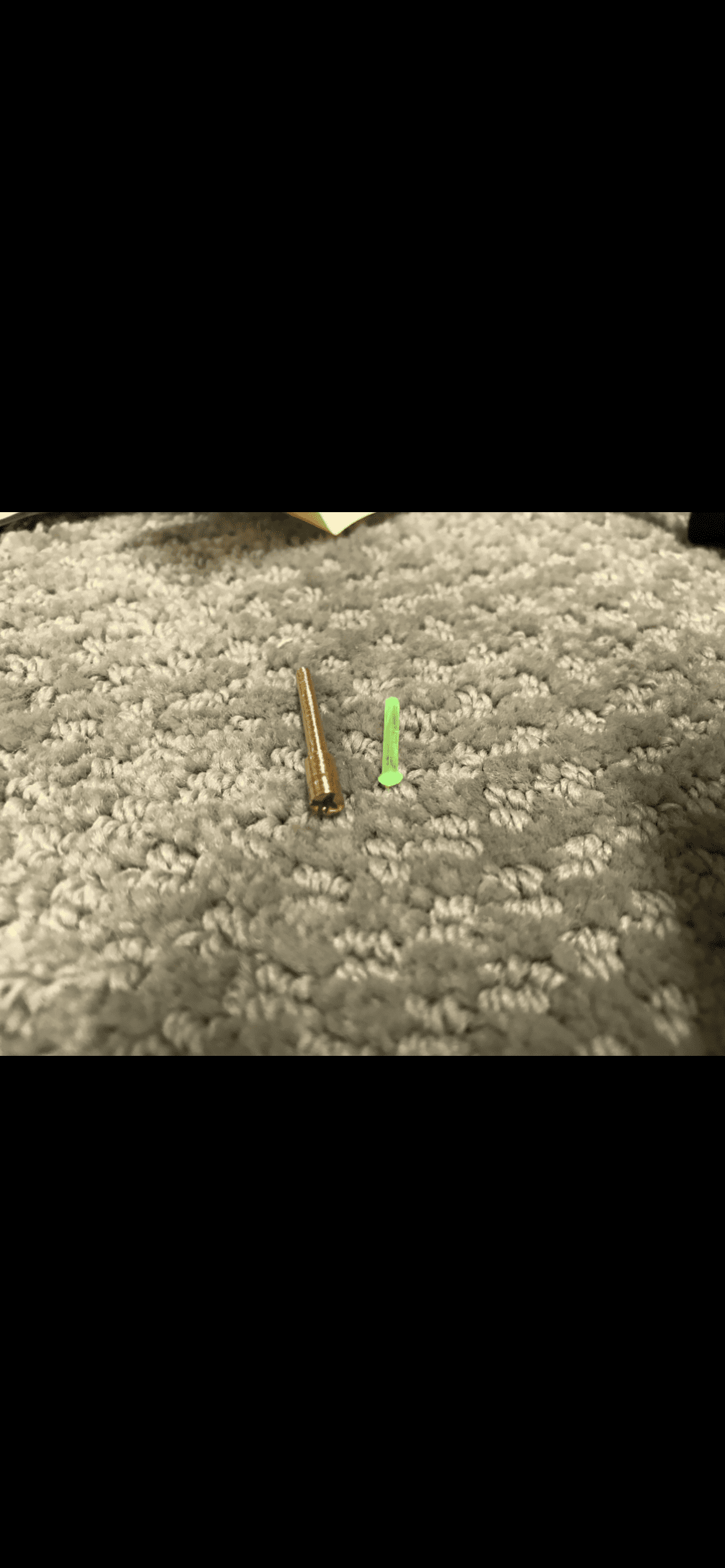

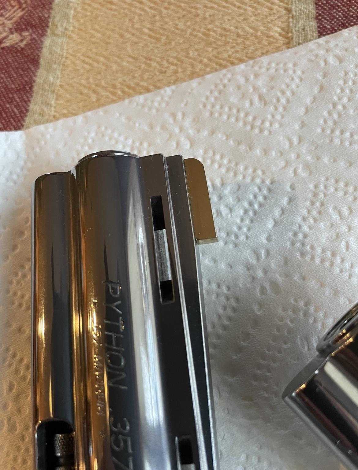

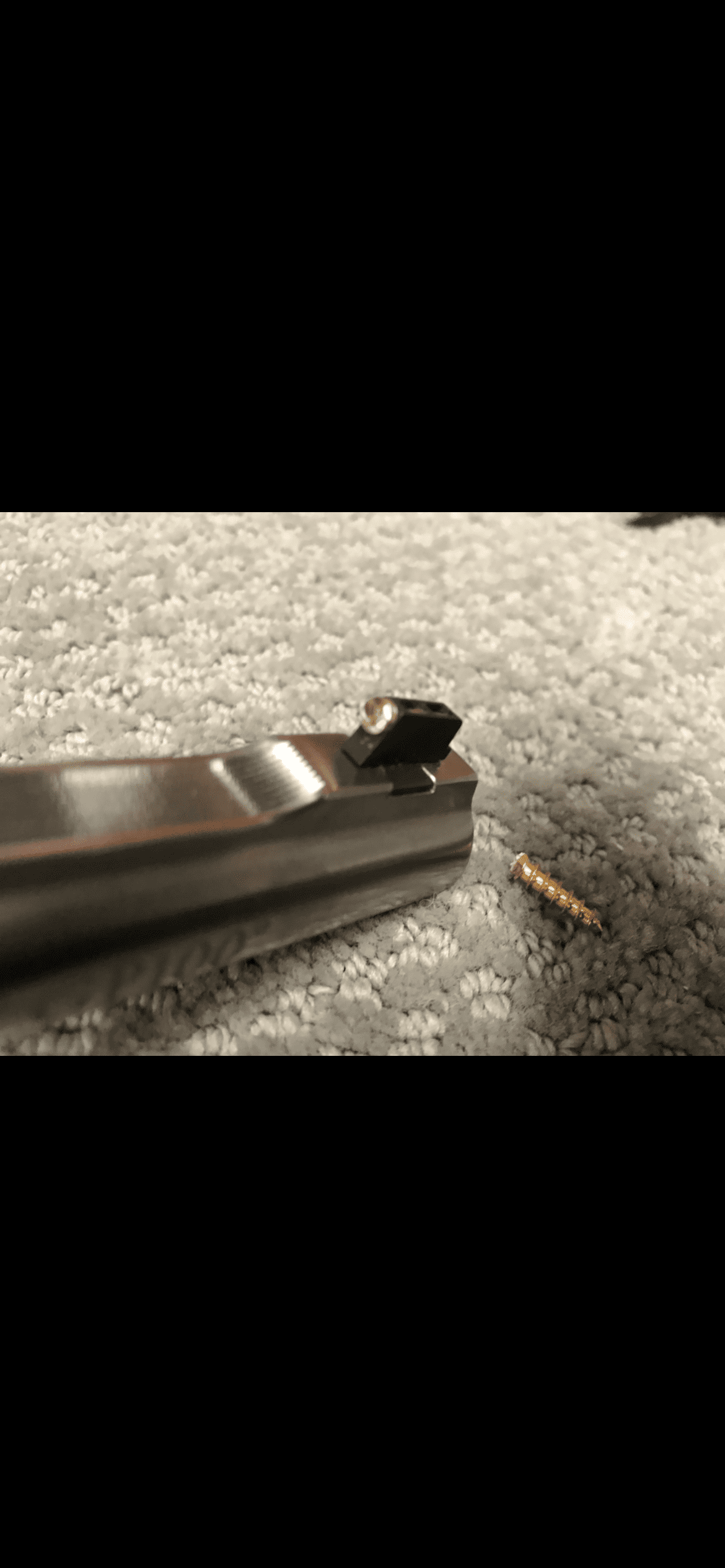

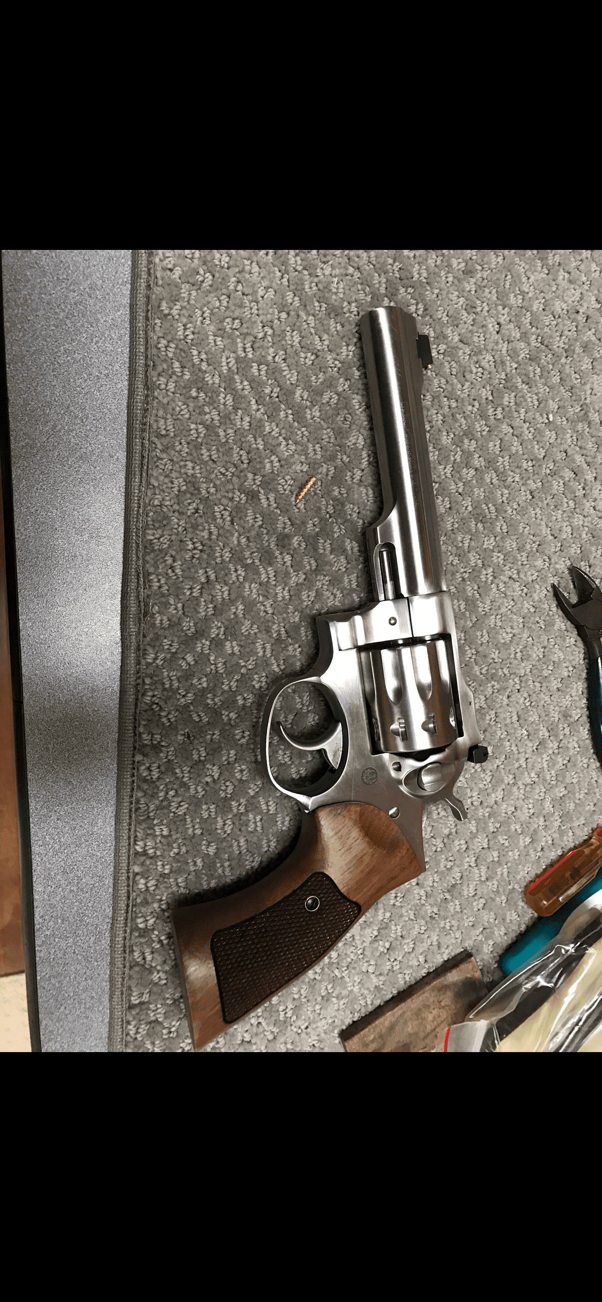

Maybe try this. Started as a brass wood screw, 30 minutes later I had this. Used a 18 volt Makita drill, sandpaper and mill files. Also have made brass front sights for my 2020 Colt Python’s.

Thanks for the idea! I was thinking of replacing the front sight on my Mk IV hunter (don't like fiber sights), but a small 'gold' dot using a screw or a short brass rod might just work! Something to try anyway. Or, come to think of it, just paint the end of the fiber gold color to keep it 'small' dot :) .
I did some more research, and it looks like the inserts Ruger sells are for Hi-Viz sights. The sights on my WC are from Novak. I ordered some replacements directly from Novak and I'll see how they work out.
Be careful if you go the brass screw route. i picked up some that were actually plated steel. Carry a magnet with you to be sure.
i ended up buying a short piece of brass rod from Grainger.
