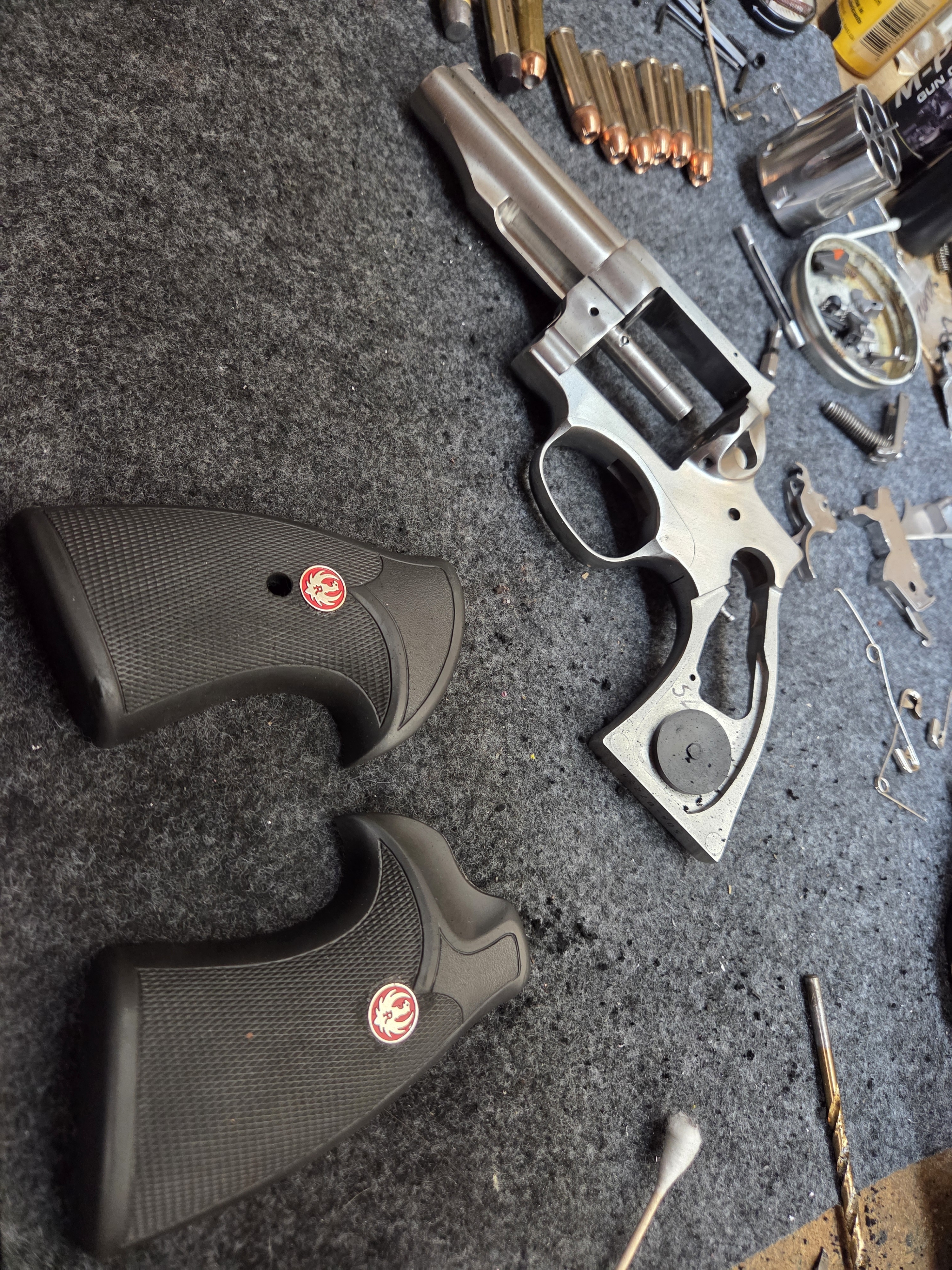

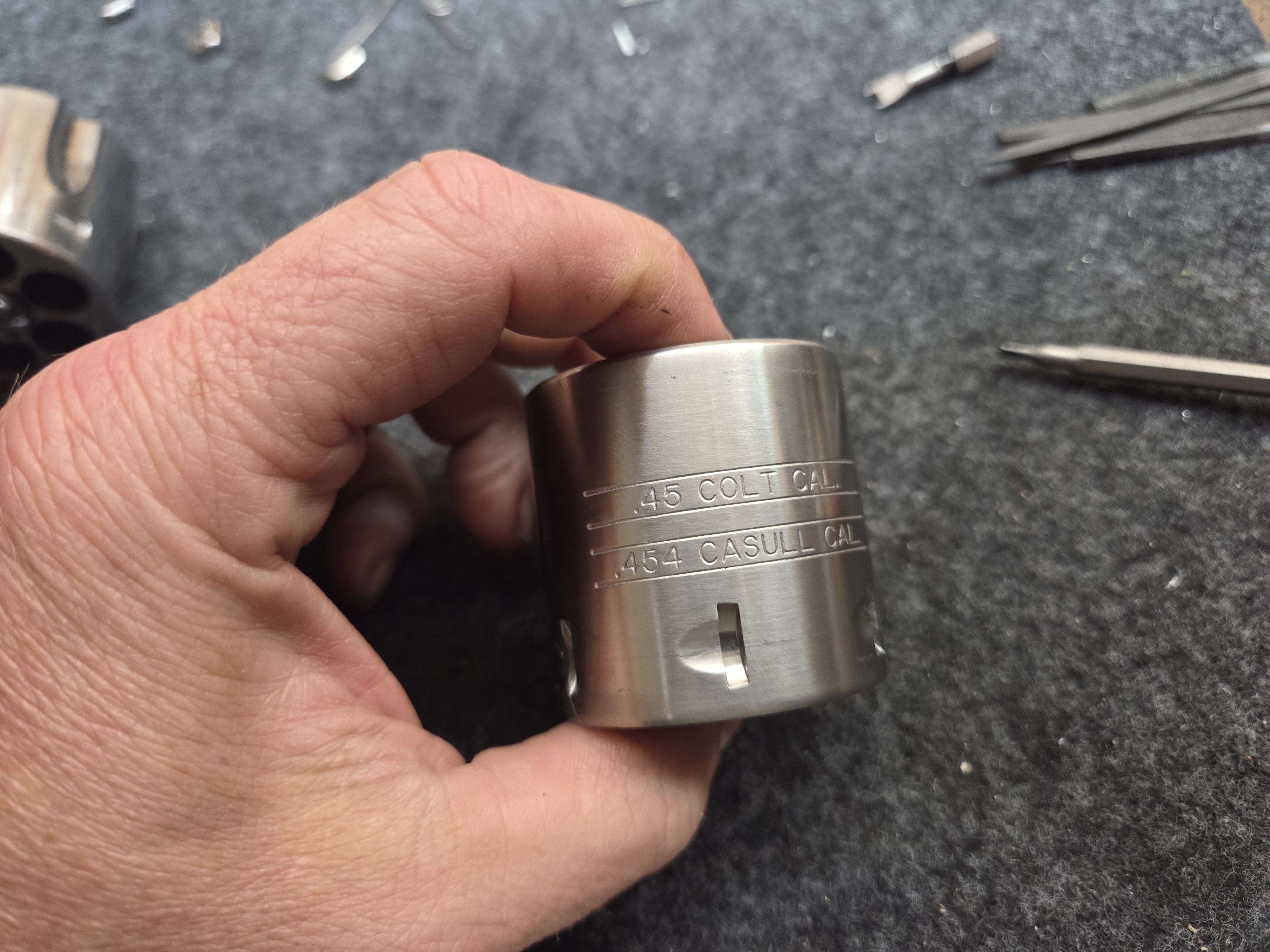

The cylinder is imperfect. It will not be a drop in. The internal surface that rides against the yoke is not cut deep enough. The circumference is correct. I will have to use a piloted countersink to remove some material. Likely will go like .002 at a pop. I have a set of shims, in case I dig too deep.
I purchased the cylinder as-is from Hamilton Bowen.

Ruger Super Redhawk 454. Cylinder is almost identical. The main differences are stronger steel, and no flutes.
Did not Ruger require the use a tougher cylinder steel when going to a 454C.
Yes indeed! Here is article about steels used on 454 SRH (and I believe 480 also) https://www.carpentertechnology.com/blog/most-powerful-revolvers-get-lift-from-aerospace-alloys
As for pressures, for 45 Colt "Ruger level", Hodgdon goes up to 30 000 PSI. For 454 standard pressure is up to 65 000 PSI, or 50 000 CUP. More than double increase.
If I remembered correctly, John Linebaugh stated that large frame NM BH in 45 Colt fails at about 60 000 PSI. I doubt that 45 Colt Redhawk is so strong that will take considerably more pressure than that.
In other words, the only logical solution to have 454 in standard Redhawk is what OP already did; 454 Cylinder from SRH and install it on Redhawk. However, that is not all. Nominal stainless steel for barrel, even magnum revolvers, is 416R. If you go to article I mentioned, you will find that steel Ruger used for 454 SRH is 15Cr-5Ni. This steel is considerably more resistant to very high pressure and erosion effect generated by 454 ammunition. In other words, even if 454 SRH cylinder is installed on Redhawk, and revolver consistently used to shoot standard pressure 454 loads, especially using double base powders, the barrel could be severely damaged.

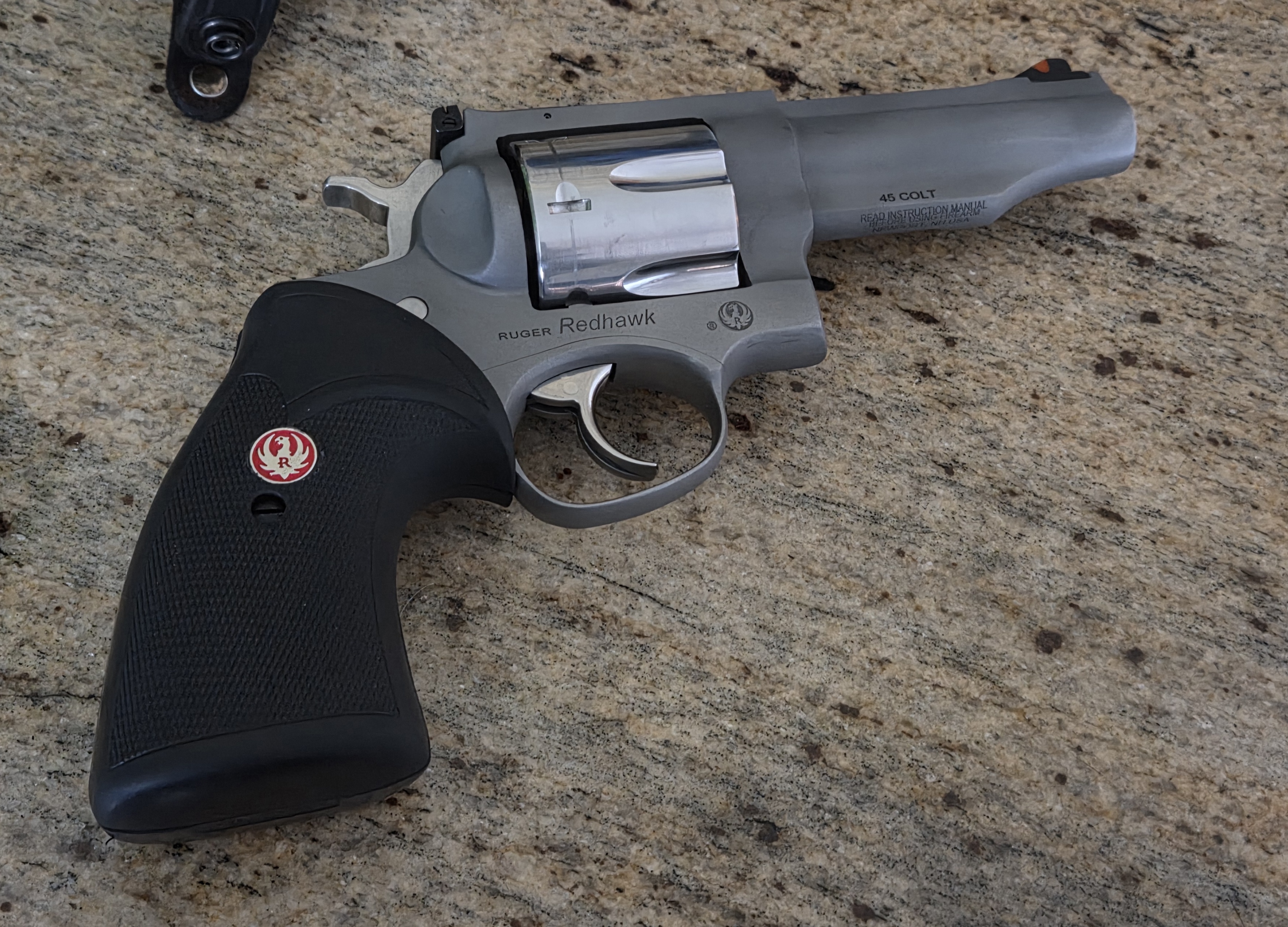

Several people have voiced concerns about 454 pressures in the 45 Colt Redhawk. Some folks were just awful about it.
Even though this is far from the first time this conversion has been done, some folks think that since it happened before the internet, it never happened.
So to make all the internet Nanny Squad Members happy, I bought this.
You should be the the happiest one ;) ! Perfect revolver, with perfect cylinder, and so strong that you do not have to worry as rest of us mortals, shooting 45 Colt loads, even in large Rugers in this caliber.
