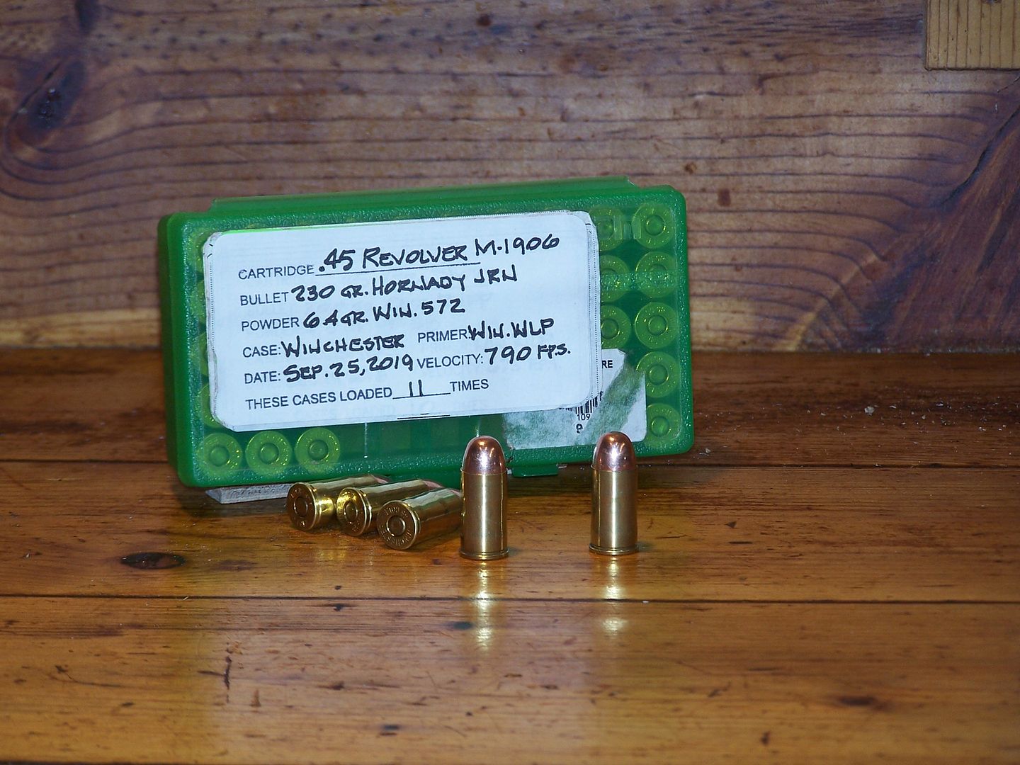

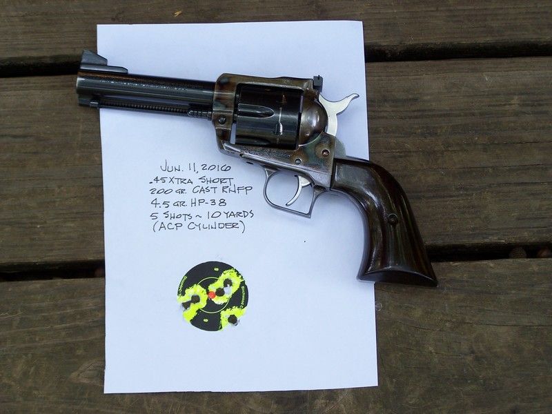

Aome yeara ago now, I had a batch of brass with splits ready to take to the salvage yard. Many of these were old .45 Colt roounds with split necks. Soooo, on a lark, I cut them to .45 Auto length, using .45 Auto data. These were loaded for a Blackhawk with the .45 Auto cyinder in place.
As to accuracy form the short case in a king cylinder:
I even went so far as to try to duplicate the M1906 round:
Totally frivilous efort, but fun and did find use for brass that otherwise woul dahve been discarded.
