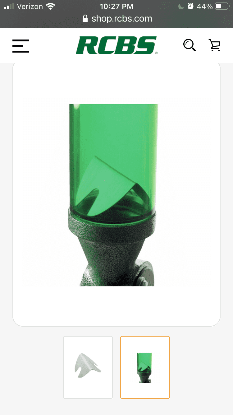

I’ve had Uniflows since the early 80’s. To cut down on the shearing of stick powders I made a baffle like Redding had in theirs. A few years later RCBS started making them. It makes a world of difference.
I couldn't stand to pay $11 for a folded piece of sheet metal. Now that it's easier to afford, JB probably made the price go to $23.
Nope. $19.99 on sale for $12.49 on Amazon but only 2 remain (which means none).
There are 3-D printed baffles now. Cost about $10. I'll postpone that add on since I think most of the powder I'm planning to use is ball (which is the original reason I felt the need for a different measure).

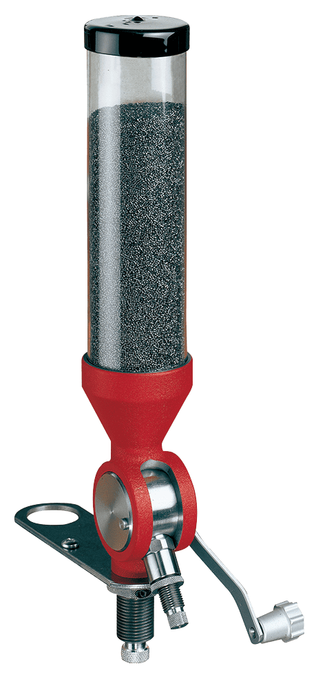

Its hard to go wrong with an RCBS Uniflow powder measure. The Hornady Lock N Load measure with its quick change powder metering insert and its ability to adapt over to automatic throw is a very good measure as well. So is the Dillon measure that will operate automatically but it has not quick change metering inserts.
Notice the button on the Hornady on the left side of the drum, this is to release the quick change metering insert. No more constantly readjusting your measure for different settings or calibers. You just buy more metering inserts.

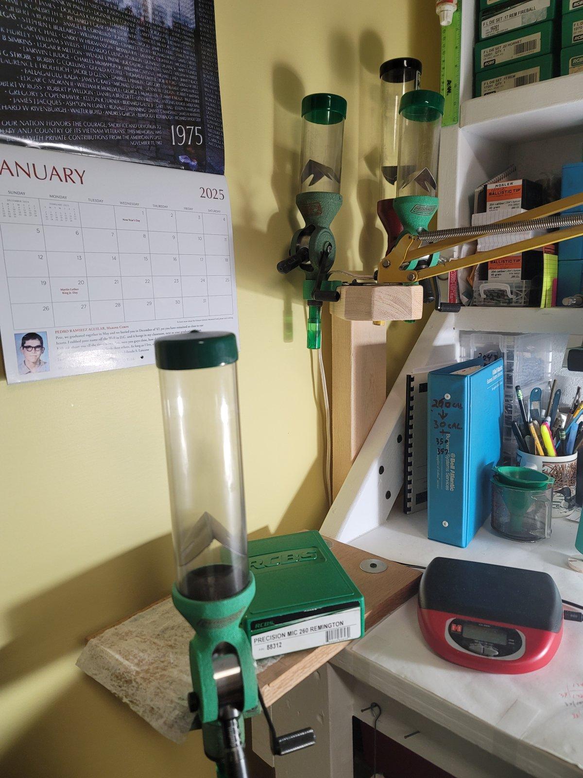

I have 3 Reddings and a Hornady. The Redding I first bought was a BR30 way back and was my mainstay powder measure. It's sweet spot was 30 grains for 223 base cartridges. I would double throw for 308 and 30-06 cases with stick powders. Go once through all 50 in my load block then go back through again. That gave me very consistant results with stick powders.Them I have niw a PR 50 for 308 and 30-06 and a Compitition 10x for pistols. For large capacity I use a Hornady but I made my own plunger, concave instead of using the convex factory one. My Redding measures will thow ball powders exact.
I can weigh 5 throws out of 50 rds, which I do to double check and they are the same. Small grain stick pretty dang close. I load lots of precise ammo and use 50 rd blocks. It is rhythm and consistent throws. It is as much as the way you use the measure as it is the measures accuracy and baffle placement. This is my set up.
I have used RCBS and they worked very well it is I just like the Reddings for my consistency.
    258.2 KB
I don't know but for me and the way I throw the charge it works for me. When I had my ammunition FFL that BR30 got a work out. I tend to keep the hopper full also after 50 rounds. For some stick powders I might put a drop tube extension or attach a funnel next the drop tube to swirl the powder in the case as it is dropped.
How I do my throws I used to have a 1x4 pine board mounting my measure to it. I thought I was going to fancy up my bench so I put a 1x8 oak piece on it. Never had a problem with throwing a 42.5 grain charge of R19 in my 220 Swift. All of a sudden it wouldn't flow in the case. The only difference i could figure was the slight vibration that the pune allowed vs the solid oak. That is when I put the funnel under it and all was well. Used that same set up for a 17 Rem and IMR4320. Funny how things work sometimes.
