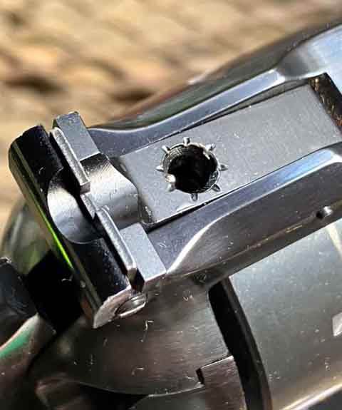

Went to adjust the elevator screw in rear sight and................................... GONE!! It was there two weeks ago when I turned it "up" 2 clicks.

This is a first for me............................ the screw is gone but the "stop" or clicker is still in the edge of the hole.

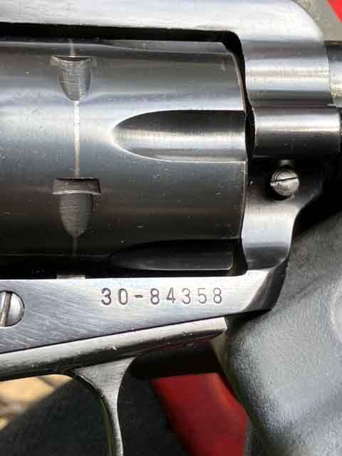

**PHOTOS showing the empty hole and serial number for reference BELOW.
Thanking y'all in advance, Bo in Western NC

The current screw likely would work and if you call Ruger parts they send small parts like that for free.
However once Ruger replaced the aluminum sights on the new models with steel sights like the first OM sights, I replaced my aluminum sights with the steel sights. They’ll probably send you one free because they’re under $20.
When you call, they probably will ask you for the SERIAL NUMBER of your gun. MAKE SURE you give them the serial number of a NEW MODEL OR a converted OM. They won't give or sell you parts for an unconverted OM (last time I called them).
J.
Brownells sells a replacement screw #780012031 for $6.49.
If you need a higher rear sight blade order #780020001.
Some older sight blades were flat while the newer sights and blades have a bump to retain the blade during recoil. I found this out when the new blade arrived and I had to grind off the bump to install on a 70's vintage NM.
The sight blade would still jump out of the slot.
I used a small bearing to increase the spring tension and retain the sight.
Now I know why the blade was missing when purchased.
If you have the new style the sight will have a slot in front of the blade.
Check it out or purchase a new complete sight
with bump for $19.95 from Brownells. #780012049
Bruce

UPDATE: Well.............. reply from Ruger Service says they won't furnish a part unless I send the OM Blackhawk in for a Conversion. NOPE!! I'll never have it converted.
So anyone want to sell or donate a proper Elevator screw to a worthy cause? Otherwise, I'm going to order one soon.
