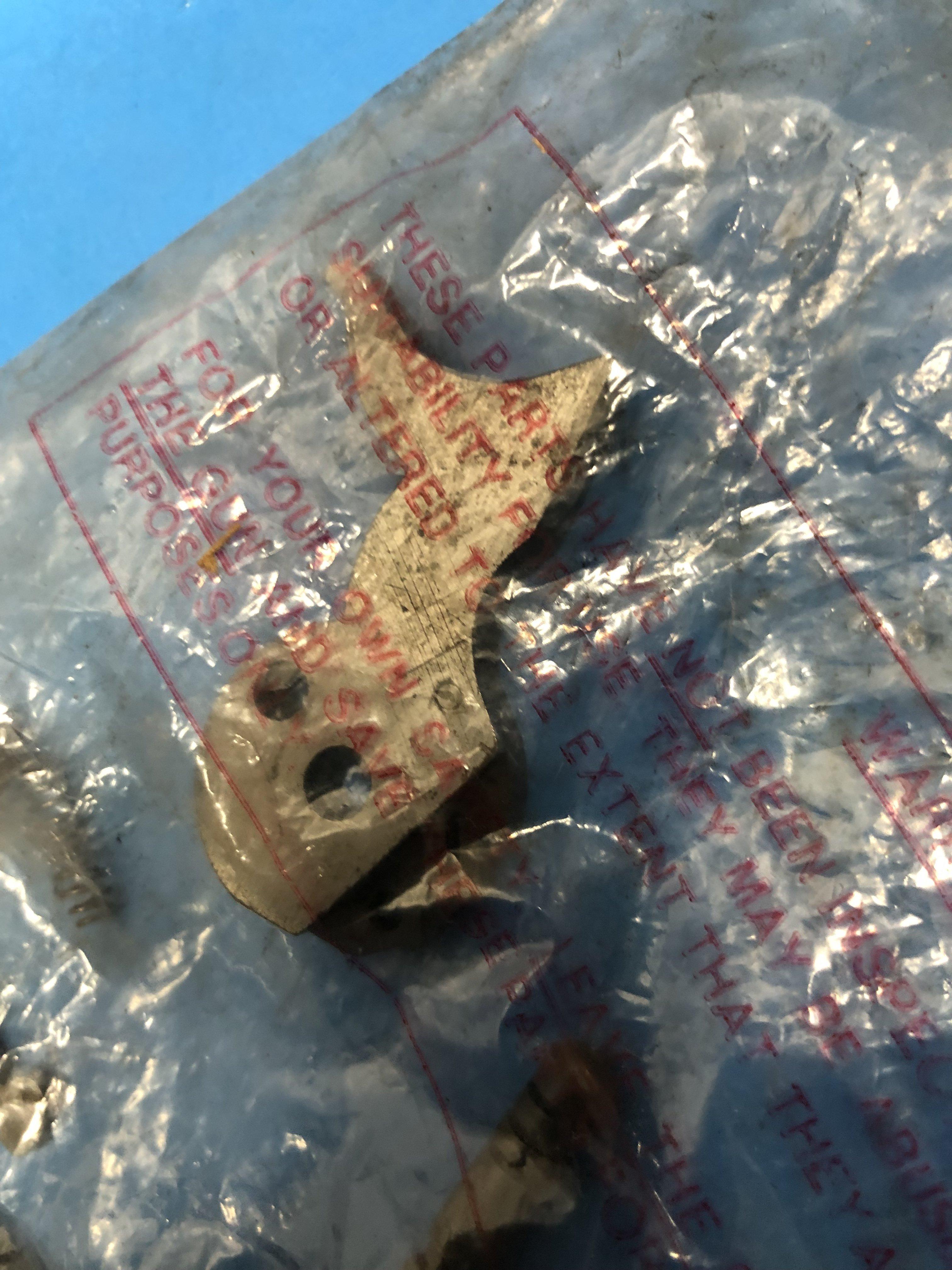

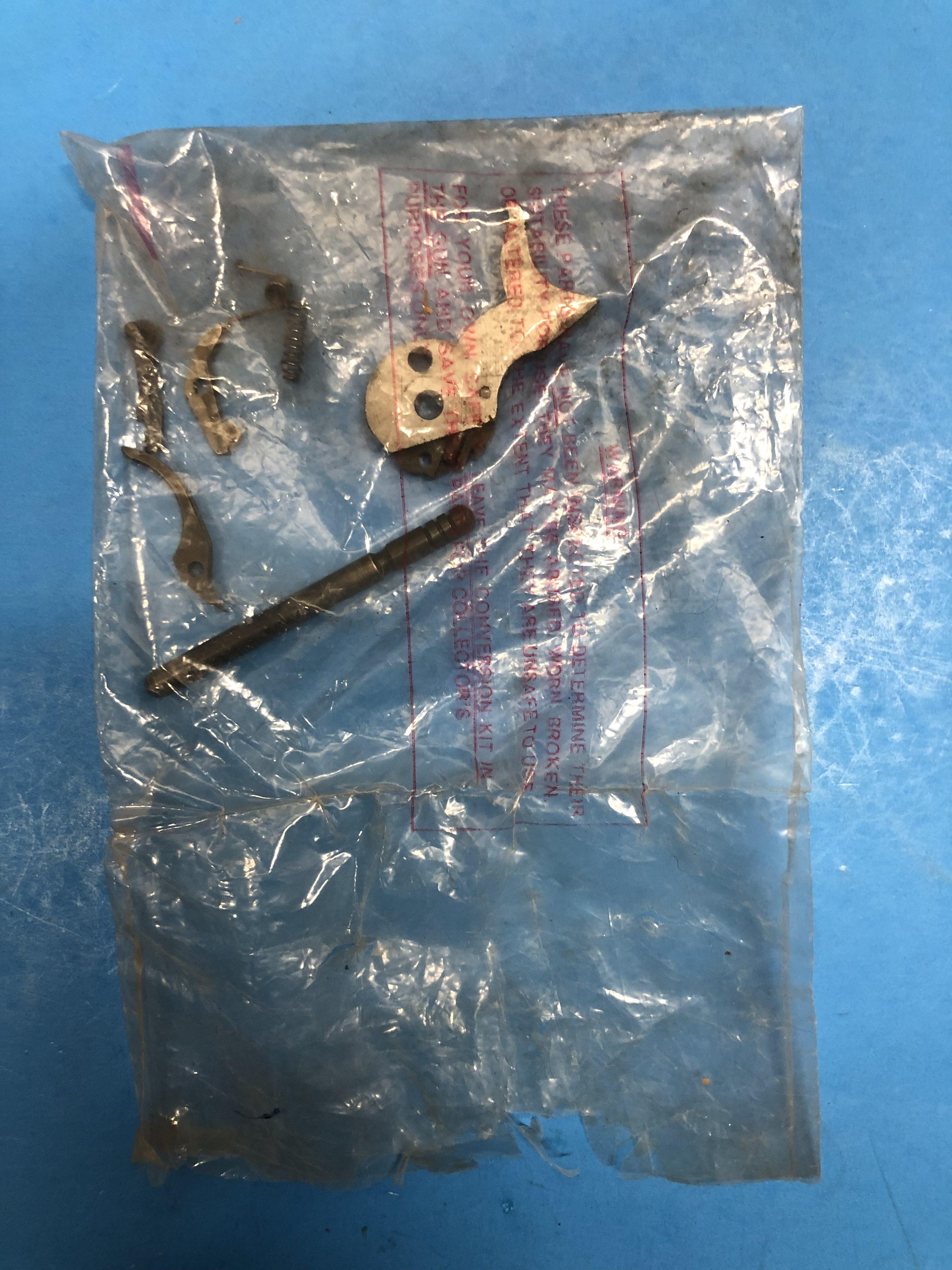

digi-shots, hopefully you got the old/original parts that would have come with the 'conversion' (?) Those parts are worth about $150 in today's world to those of us who regularly put our old model/3-screw guns back to their original, pre-conversion, grandeur. I would guess that someone will be sending you a PM (private message) offering to buy them. If you bought the gun already converted and with the box it came back from Ruger after the conversion, often the orig. parts are under a flap in the top (?) cover of the box. If not, forget this additional info.; you still have a great and desireable gun.

It did cone with a sealed parts bag but was told it might not go with gun. I can take some pics of the parts bag…

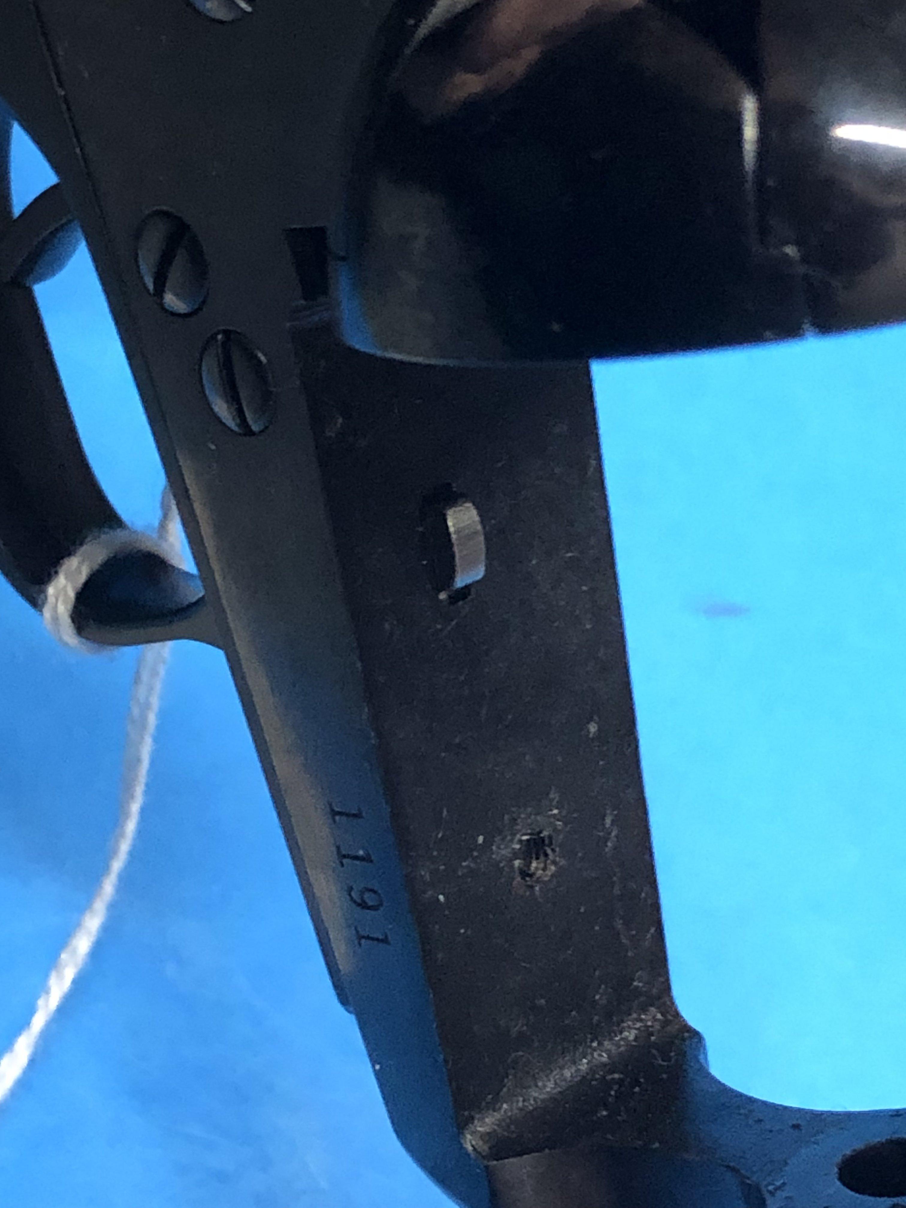

Nice gun, and look on the plastic bag, they used to mark the serial number of the gun they were working on at the top of the returned parts bag, only other way to be sure it put them back in and see if it works, timing, etc............:cool::rolleyes:

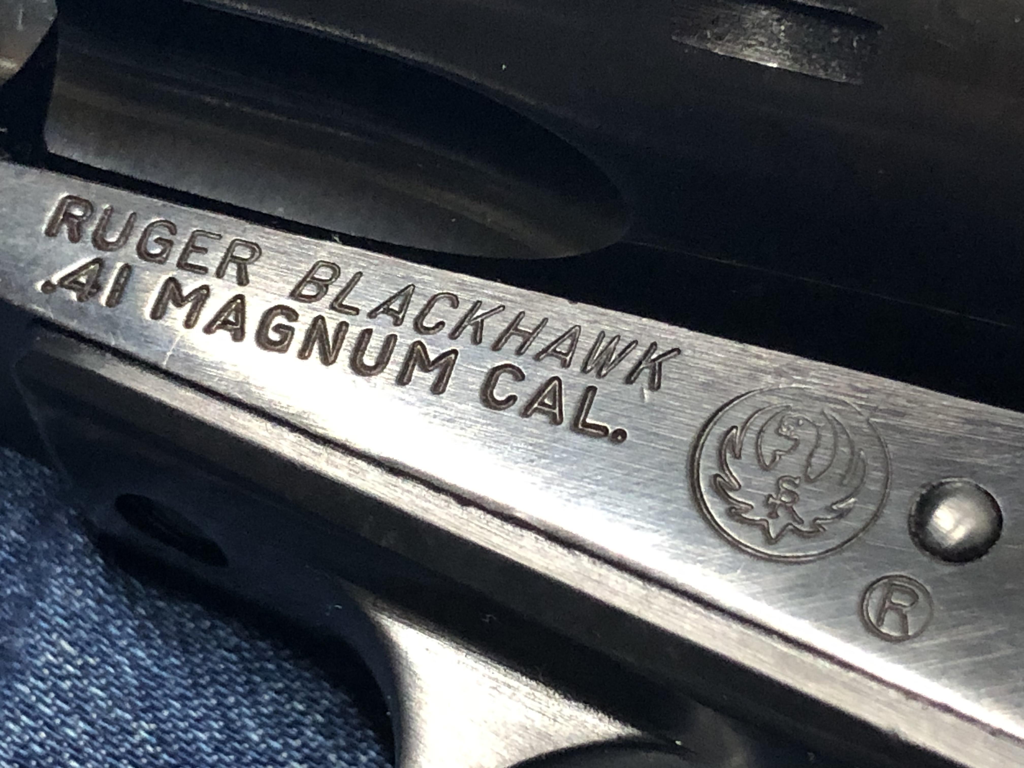

the factory stamping of the letter "R" will be on the bottom of the cylinder frame hidden by the grip frame..........;)
Like I said, those orig 3-screw parts are wrth $125 - to as high as $150.... FYI, they are classified as LARGE FRAME parts if you decide to sell them

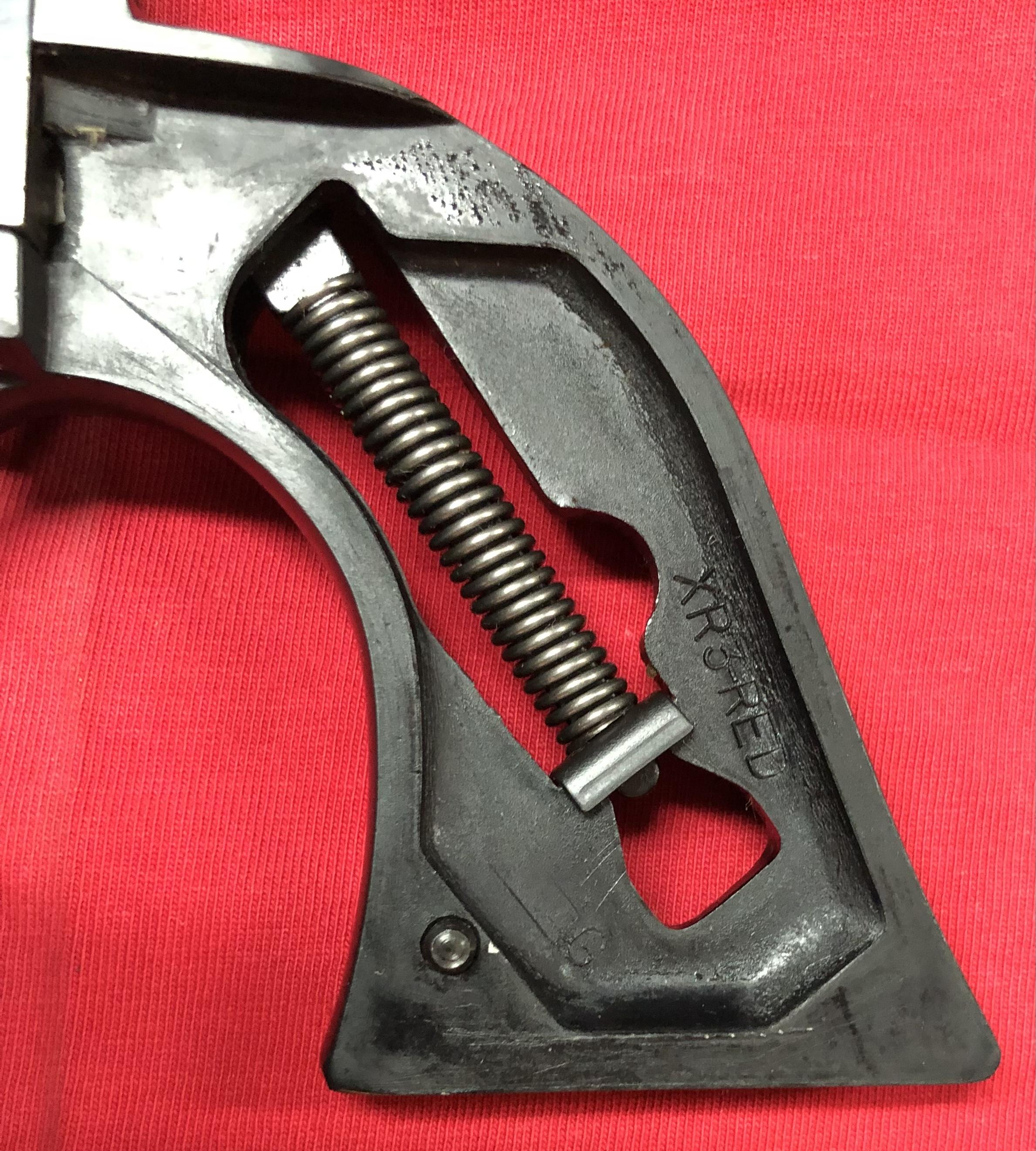

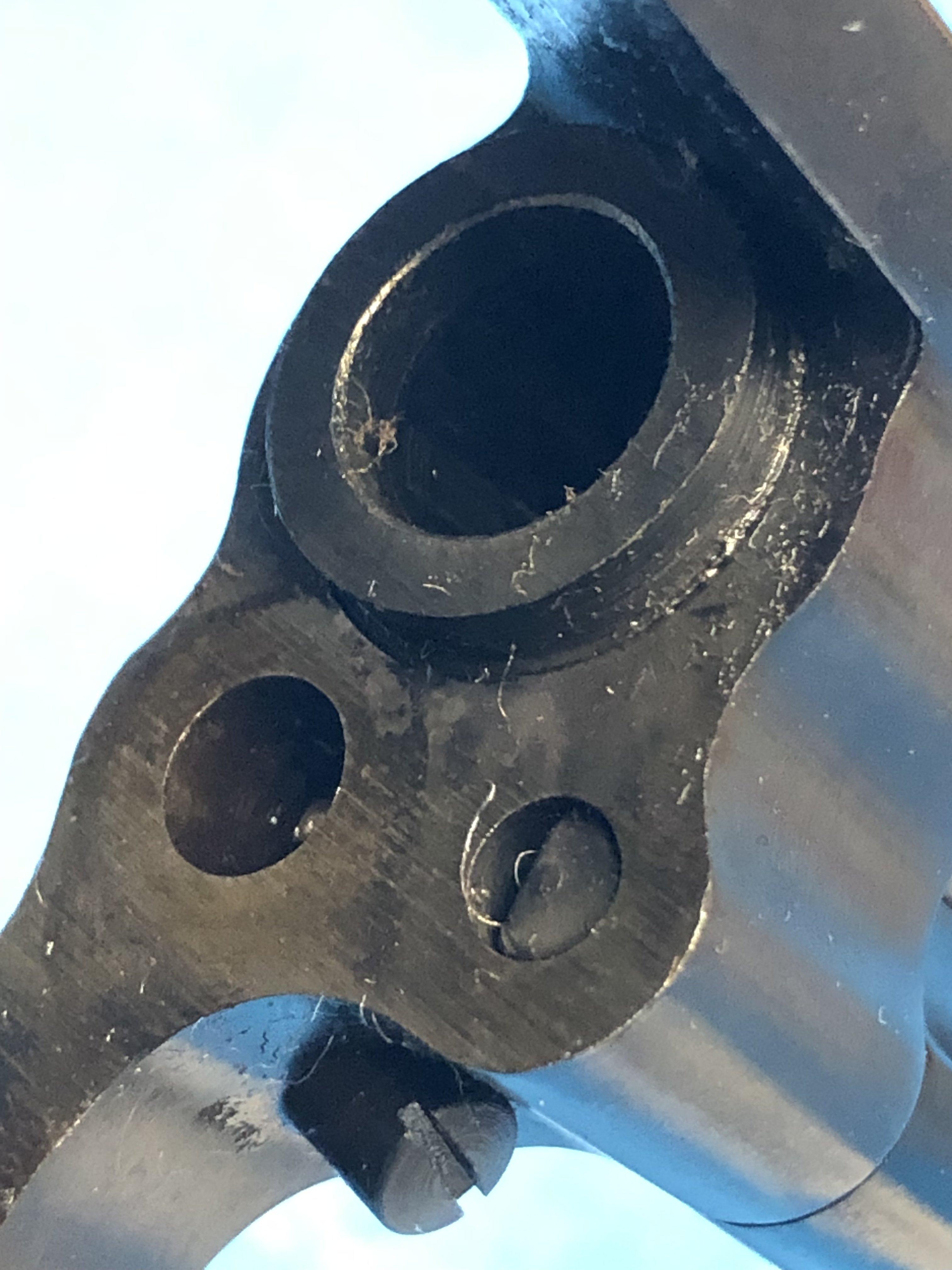

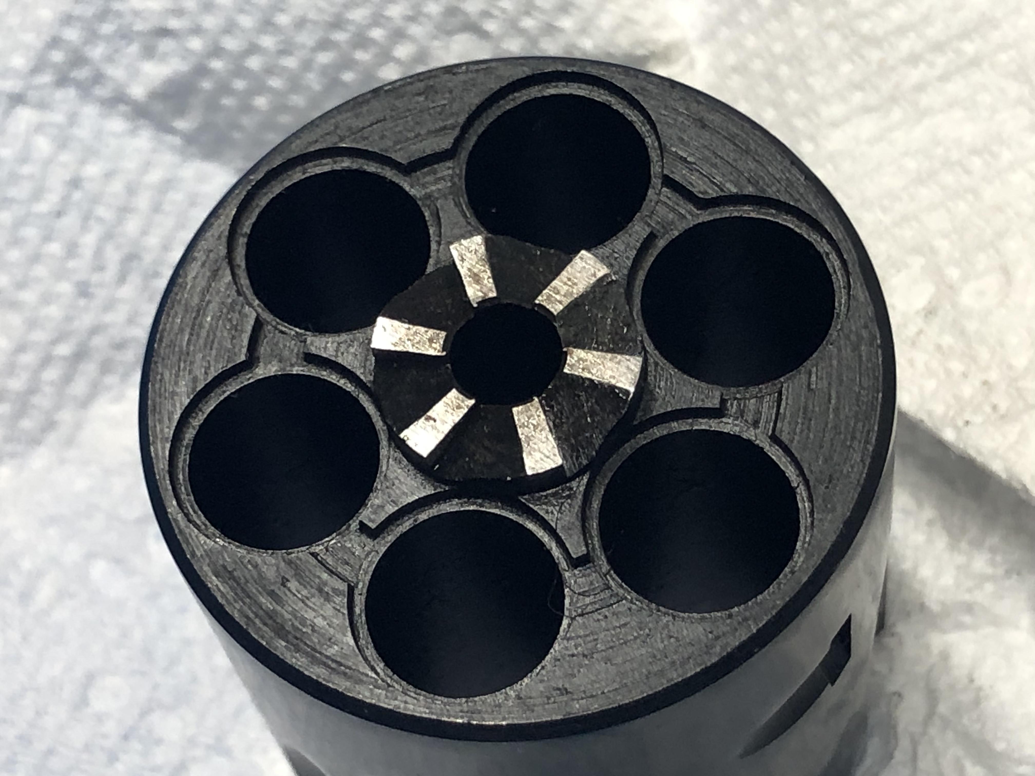

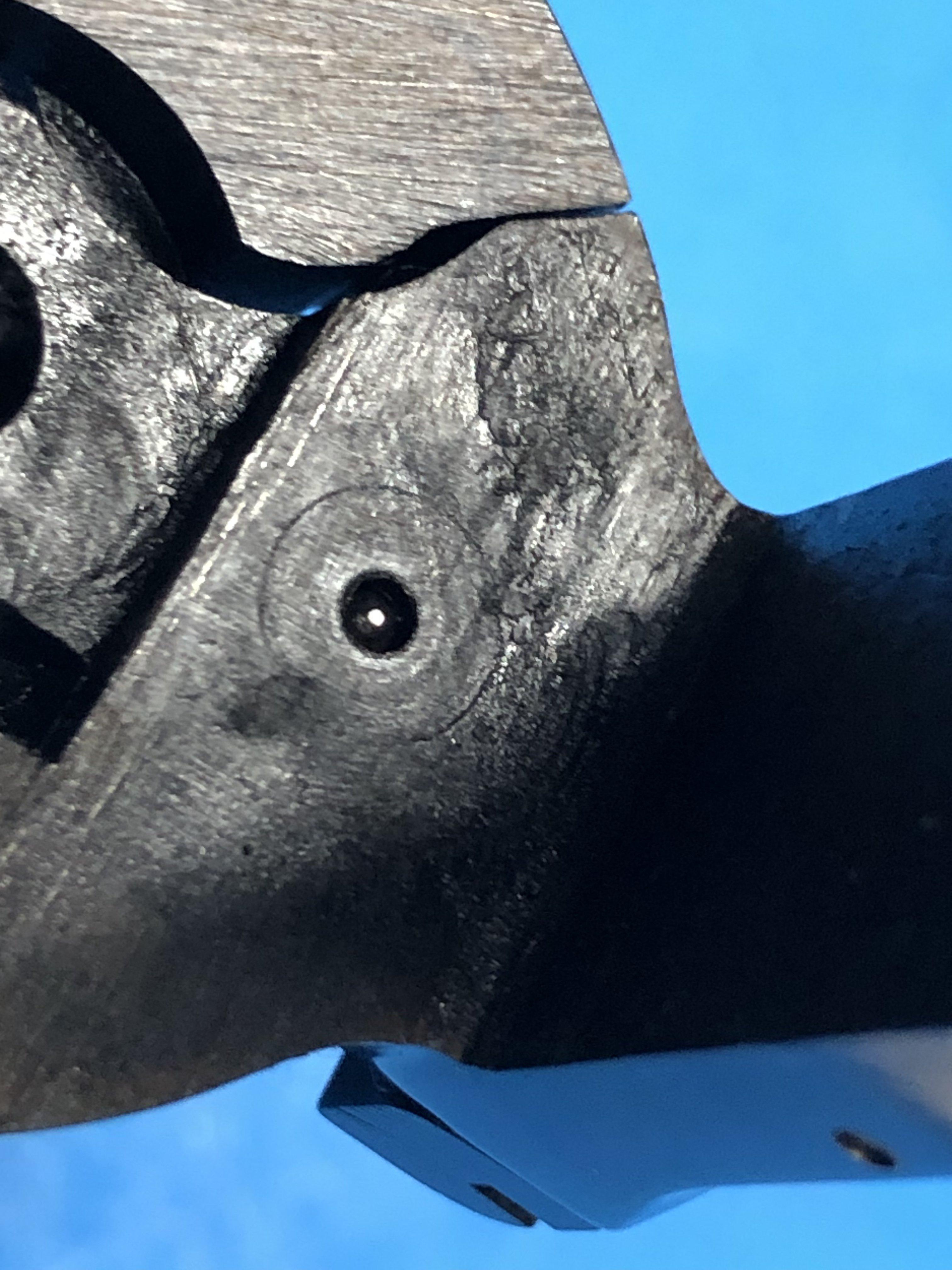

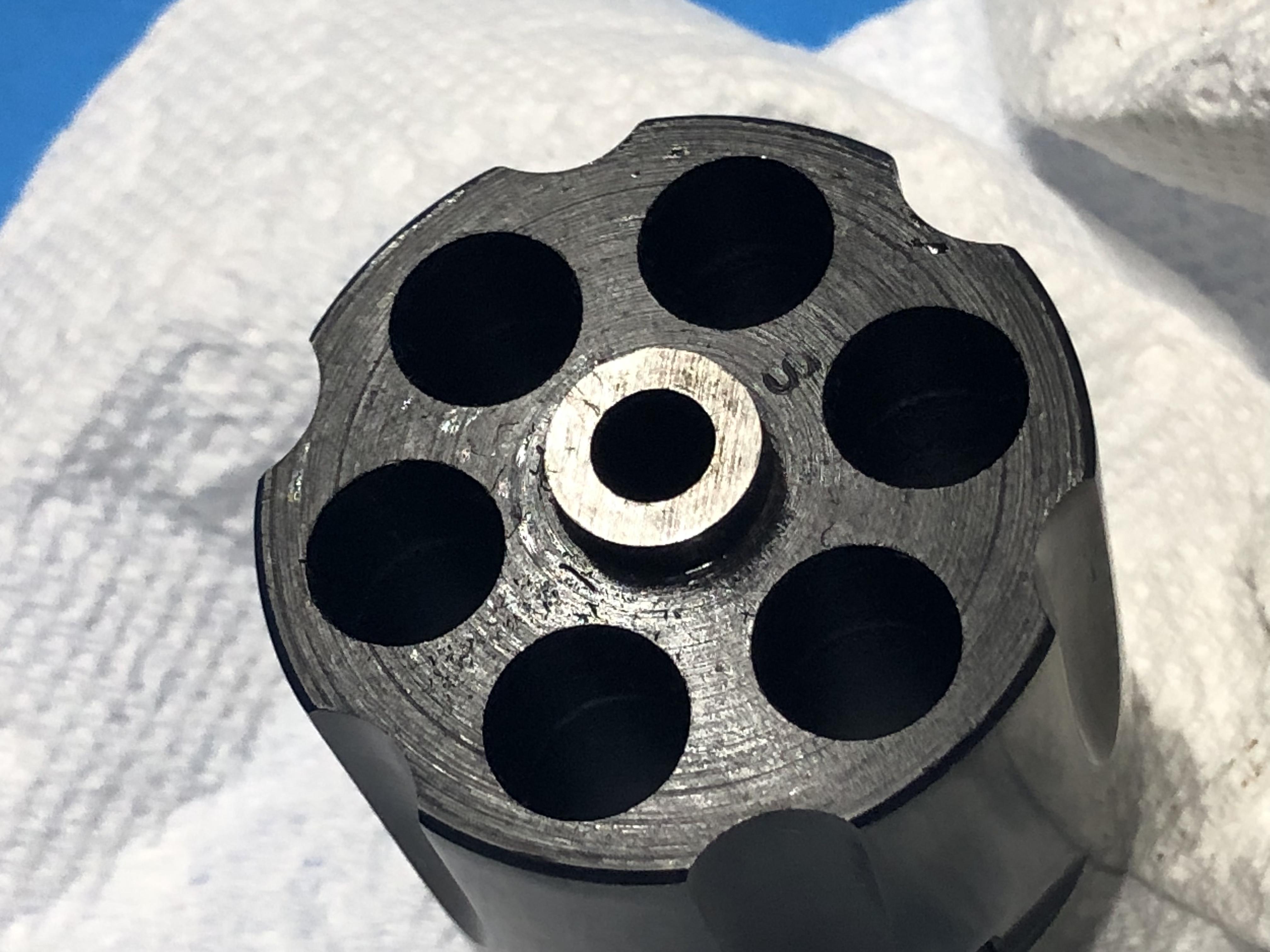

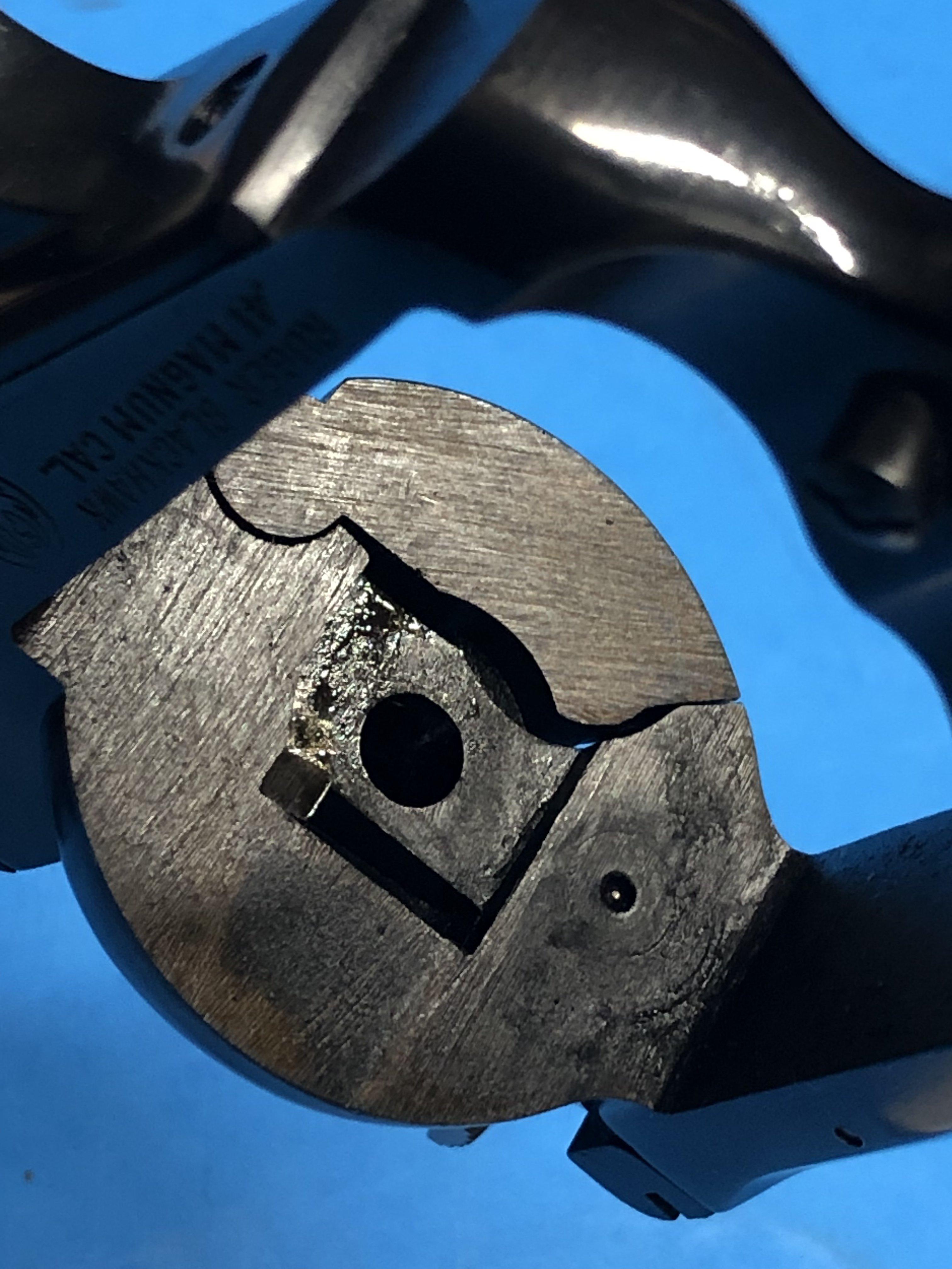

Pull the cylinder out,, & look at the firing pin recoil shield. That little round spot should be shiny if the gun wasn't reblued. Usually, when doing a reblue,, they leave those parts in place & that recoil shield will be blued as well. It's one of the easiest ways to help determine if a reblue was done.

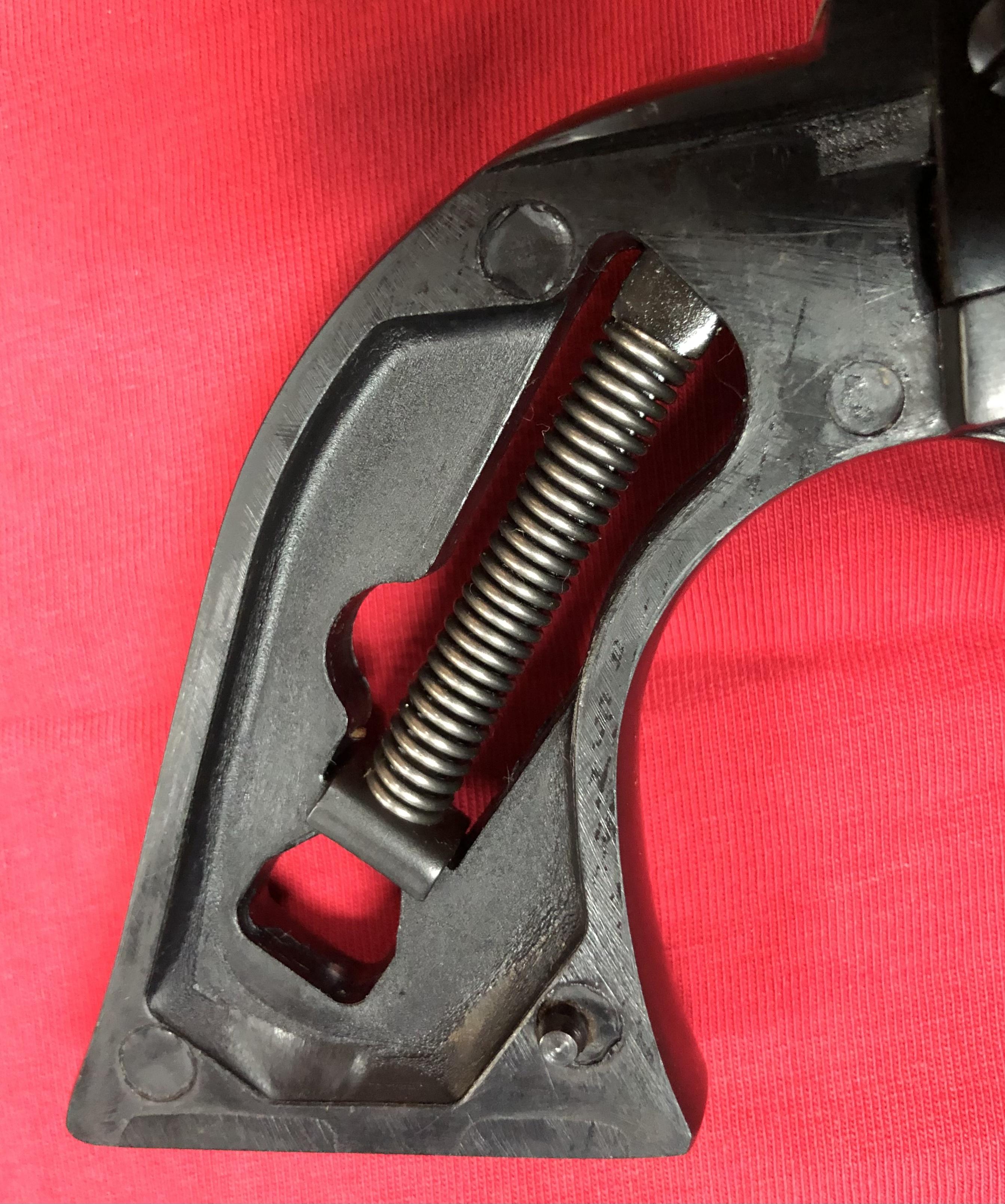

There are no numbers on the parts bag… I’ll take some pics and post.
I did take the grip sticks off and do not see any “R” stampings… all other stamps are sharp and overall the gun is super clean maybe 98% or better.

I just re-read… “….bottom of cylinder frame” ??
Should I take out cylinder out and look for R? Under trigger guard?

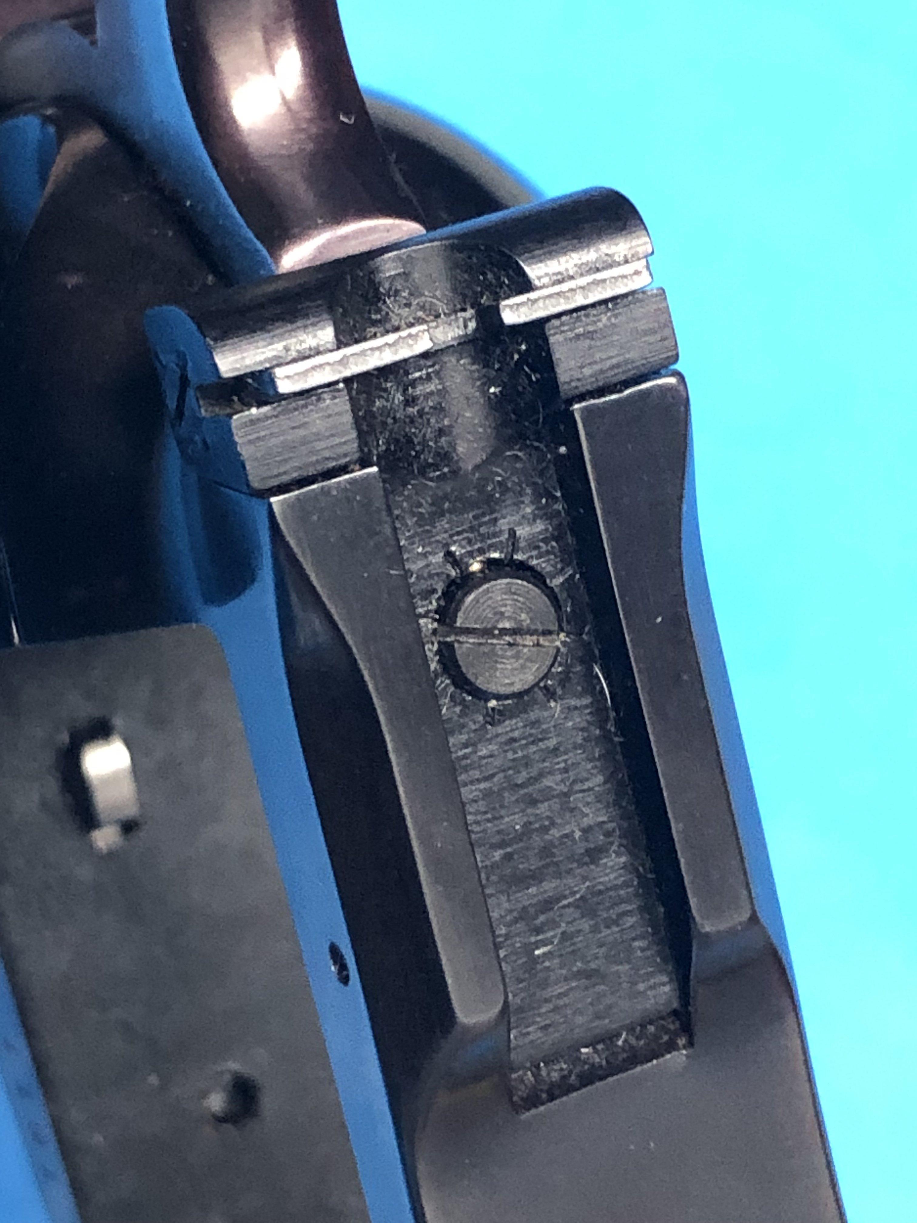

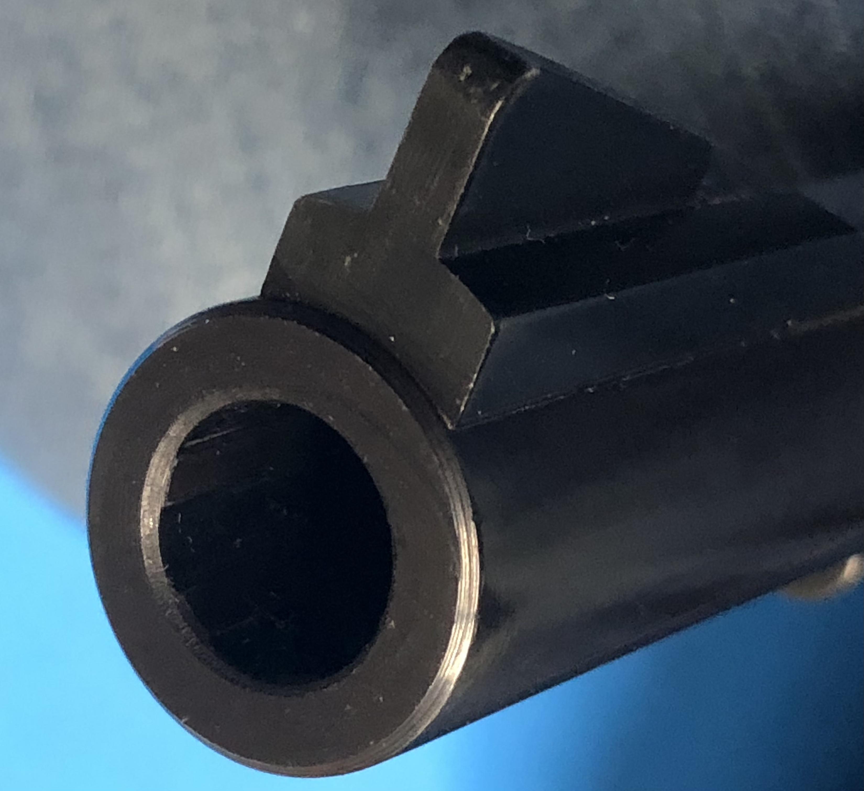

Here are a few more pics

And a miscellaneous sealed parts bag

I’m guessing this might have been refinished based on the blued “recoil” shield circle.

Personally, I'm not convinced that it has been re-blued. However, if it has been re-finished, AND given that it has been converted to the safety mechanism...BUT given that you have the parts to convert it back to its original configuration, I think that four things are to be considered in 'fair price':
1) if the barrel length is the more desirable 4 5/8"(seems the shorter bbl is more preferred to many)
2) it's a four-digit gun
3) the .41Mag has become a 'cult' (read desirable) caliber amongst aficionados
4) the fact that you can sell it locally and avoid shipping (and depending on the state, FFL fees)
I would venture a very uneducated guess that a 'fair price' would be $600 (with the parts included); I would also guess that you could get at least $800+ with a tiny bit of marketing i.e. selling on our Forum; more on the dreaded auction sites.
Used to be you couldn't give away a .41Mag........... not so anymore!!!
IMHO,
J.
I cant guess about the finish …. I’m just not experienced enough to say. This doesn’t look like an obvious reblue.
I’d wonder IF it is re-blued, did someone send it back to Ruger for that and the conversion at the same time??
Thanks, J
The barrel length is 6 1/2”. Overall the gun looks spotless.. original stampings still look sharp and no obvious pits or deep scratches or nicks.
"I'd wonder IF it is re-blued, did someone send it back to Ruger for that and the conversion at the same time??"
Ruger has done a bunch of them. And they look darn near perfect. Just look at the older guns that turned "plum" then were sent back, re-blued by Ruger, returned and later turned again. Those are hard to tell they went back w/o the paperwork. I can show you examples of a PROPERLY done job of a reblue that many would swear are not a reblue.
As to value,, looking at the pictures & all, I'd value it as a fair buy or sell at about $600-$650.

from the looks of the pictures you added since I replied earlier it is obviously been shot BUT any and all the markings of this are covered by blue, NICE job heck if I did not know any better reminds me of Walters work ( my old partner) some of you have seen our work from days gone by.......too nice to try and remove the frame, you may just booger screws of whatever, it is what it is and if to be used for hunting and it is converted,better for in the woods "as is" and yes still worth at least $650 maybe even more throw in the "parts " bag.....good luck and Merry Christmas.....(y)(y)
