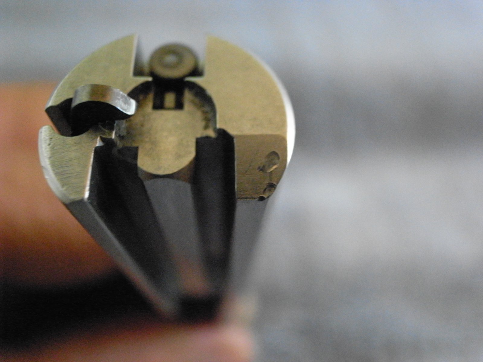

Cleaning my pistol and noticed two dings on the bolt face. Did a search and found out that it is a problem. What to do ? call Ruger or live with it.
Only 600 rounds fired !!
Thanks
Rick
Spoke to Whitney at Ruger. Sent her a picture of the bolt face. See what happens !!!

Received this from Whitney at customer service .
Seems like their not really concerned .... however if it gets worseI will send it in.
Never used the bolt stop as a release and HV ammo shouldn't cause this.
Okay, so I got an answer from my tech. He stated that if you are using the bolt stop as a release or using high velocity of ammo can cause this. If you have any issues from the firearm, the firearm will need to come in. Otherwise you should be good to go!

My ruger mark iv has the same problem . I spoke to whitney as well. today 5-15-23. The techician said this appears from usage of the block stop; which i do not use. Then said it was because of high velocity ammunition. I took the gun to our metallurgist and he said bolt metal is soft . Volquartsten bolt much harder then rugers with no sign of indentation like rugers. Ruger should replace bolts with properly heat treated steel.

Again I don't feel you should have to buy another bolt if the one you have is not properly heat treated. The volquarsten bolt shows no indentation after thousands of rounds.

Checked Wirthwein Guns 137.00 $ for new Stainless Steel bolt with all internals. Ruger should replace with better bolt I'll just shoot it for now and if it gets worse I'll send it in. For Christ sake this is a stainless bolt shouldn't get dings !!!!!
