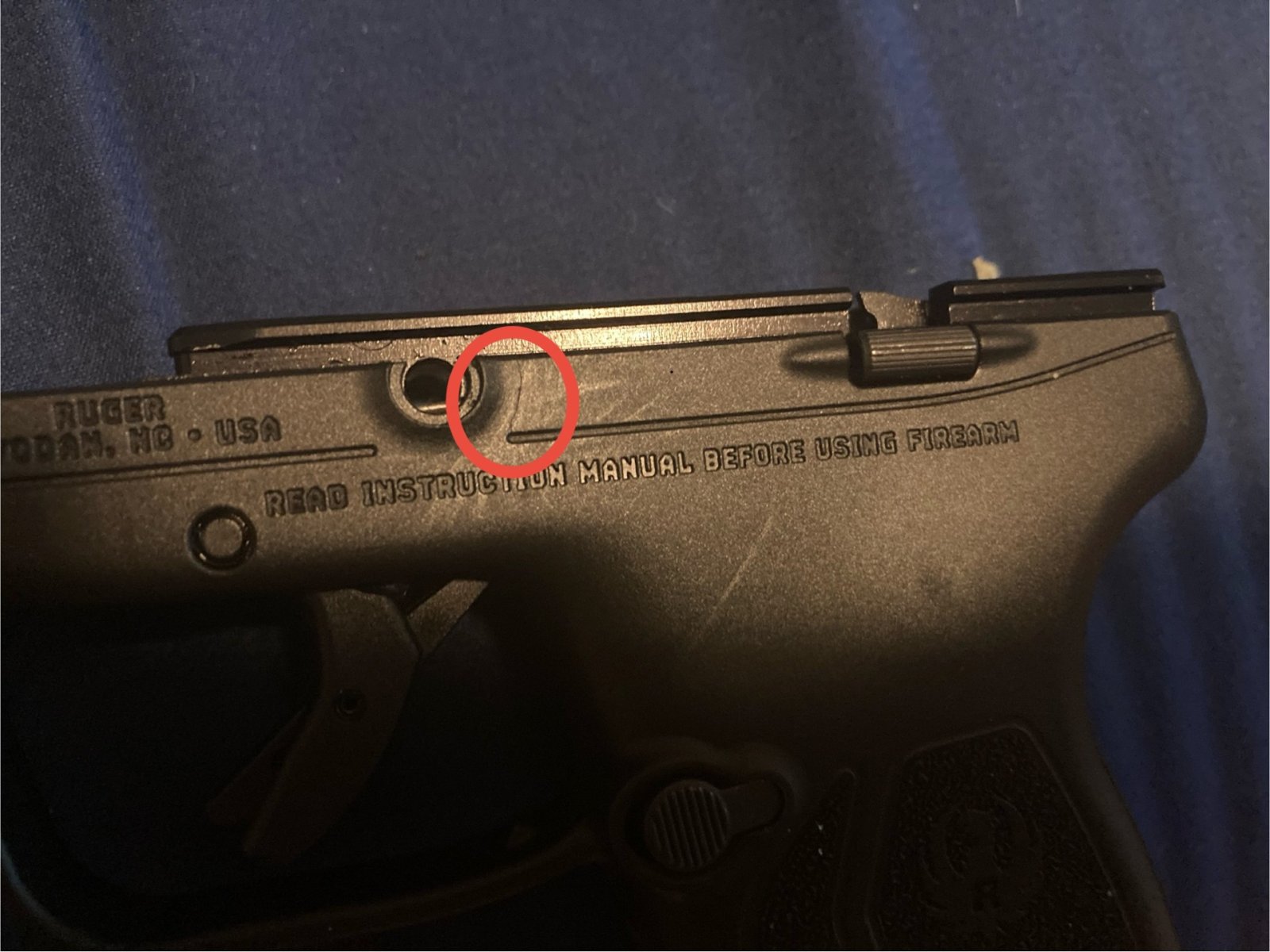

Hi,
I purchased a new LCP Max on Friday, and I just noticed this mark on the frame near the takedown pin. Is it a crack or just a deep scratch, and should I contact Ruger to have them repair it? If it's just a cosmetic issue I don't mind, but I don't want it to compromise the structure of the frame? Would it be fine to take it to the range tomorrow, or should I hold off and have it repaired?
Thanks.
Looks to be a surface scratch. I don't see anything continuing up into the slide rails. It wouldn't hurt to send a pic to the mothership and see what they have to say, but I would shoot it.
Disregard.
I posted this question on a couple other forums as well, and one suggestion was to remove the FCU and check the other side to confirm it's a crack. I did and nothing was there. It is just a surface scratch. It made my heart skip a beat, as it is new and I haven't even shot t yet, but I can live with a little cosmetic scratch.
Thank you for your assistance.
I could go with "surface scratch" if it was a straight line but the darker "dot' in the center and the uneven line says 'crack' to me. It doesn't need to be through and through to be a crack. Having done untold numbers of 'non destruct testing' as a Tech Inspector on helicopters I can say that many cracks look like a scratch till tested. Were it mine it would be going back to the dealer and have them contact Ruger to send it back. Your pistol; your decision.

FYI: I just picked up my MAX and the first thing I did was look at the place where yours looked cracked. Guess what; I have the same type mark there but it is very light. I can only assume that it is a tooling mark One 'dislike ' I see is the magazine safety and the fact that it take a LOT of pressure on the extractor button to extract the magazine. I absolutely cannot press the extractor button while holding the pistol. I have to place it on a solid object the REALLY press to have it work. I have contacted Ruger. Let's see what comes of it. Not a happy camper

I received my MAX back and they had replaced the frame because of a very very difficult to press mag release button. I looked at the new frame and guess what...it too has a mark similar to the OPs though, I might add, I couldn't see it until I looked with a magnifying glass and bright light . The frame that came with my MAX before replacement also had a such a mark. I can only assume that it is a tooling mark of so kind.
Probably left over from the molding process. Plastic molds have vents to allow air to leave as the plastic is injected. These vents which are in the 0.003 inch range or smaller, enlarge over time. We would send the molds out and have them micro-welded then we would grind them to tolerances of ~0.0005 inch.
