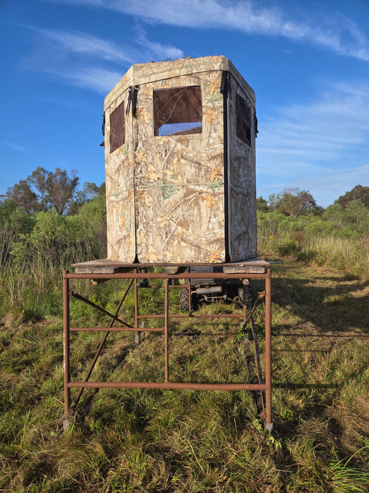

Blind on some scaffolding, drag it to where you want it.
    590.9 KB
Those kinds of blinds look nice. But here in our mountains,, you wouldn't be driving them around or much less dragging them anywhere. Plus,, with our terrain,, most of the stand hunters around here want more elevation to actually see a bit further.
