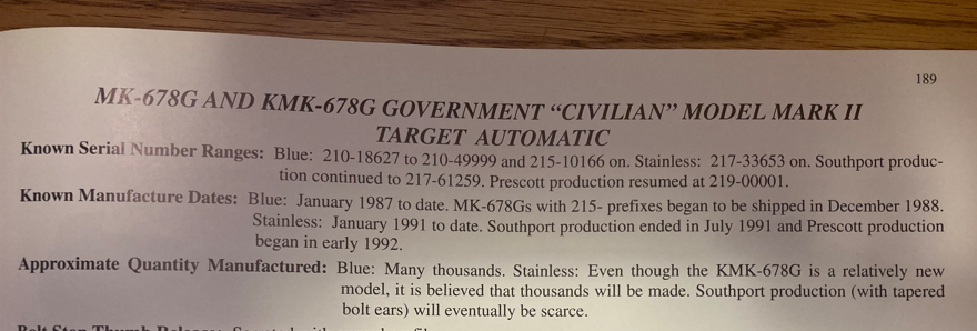

I'm out of town without my info. What serial number did the MK678G Blued Government Target start with. Not the U.S. models.
Is this what you are after?

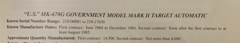

I've run across a MK678G none U.S. gun serial number 210-20018. This dates to 1984 on the Ruger Mark II Serial Number search. But the civilian version MK678G weren't produced until 1987. And I thought all 210- prefix were U.S. guns. When I enter the number on the Ruger page that gives info on model etc the page says it's unable to locate that number. Am I missing something here?

The entire 210-00000 to 210-50000 block was reserved for the MK678G. Currently he highest known U.S. marked gun is 210-19295. But there are a few of the "civilian" contract MK678G's that were made in the 210-18xxx range before the last small contract of U.S. marked guns.
Then the MK678G civilian model continued to 210-50000
From my current computer version of my reference:
MK-678G with "U.S." rollmarked above serial number. A total of 17,439 were produced in the first contract (contract number DAAA09-83C-4901…awarded in 1983) with deliveries beginning in July 1984 and completed in August 1985. An additional contract for 964 pistols (contract number DAAA09-86C-0512) was completed by August 1986 for a total of 18,403 pistols. Known s/n and s/n range 210-00051 to 210-19295.
