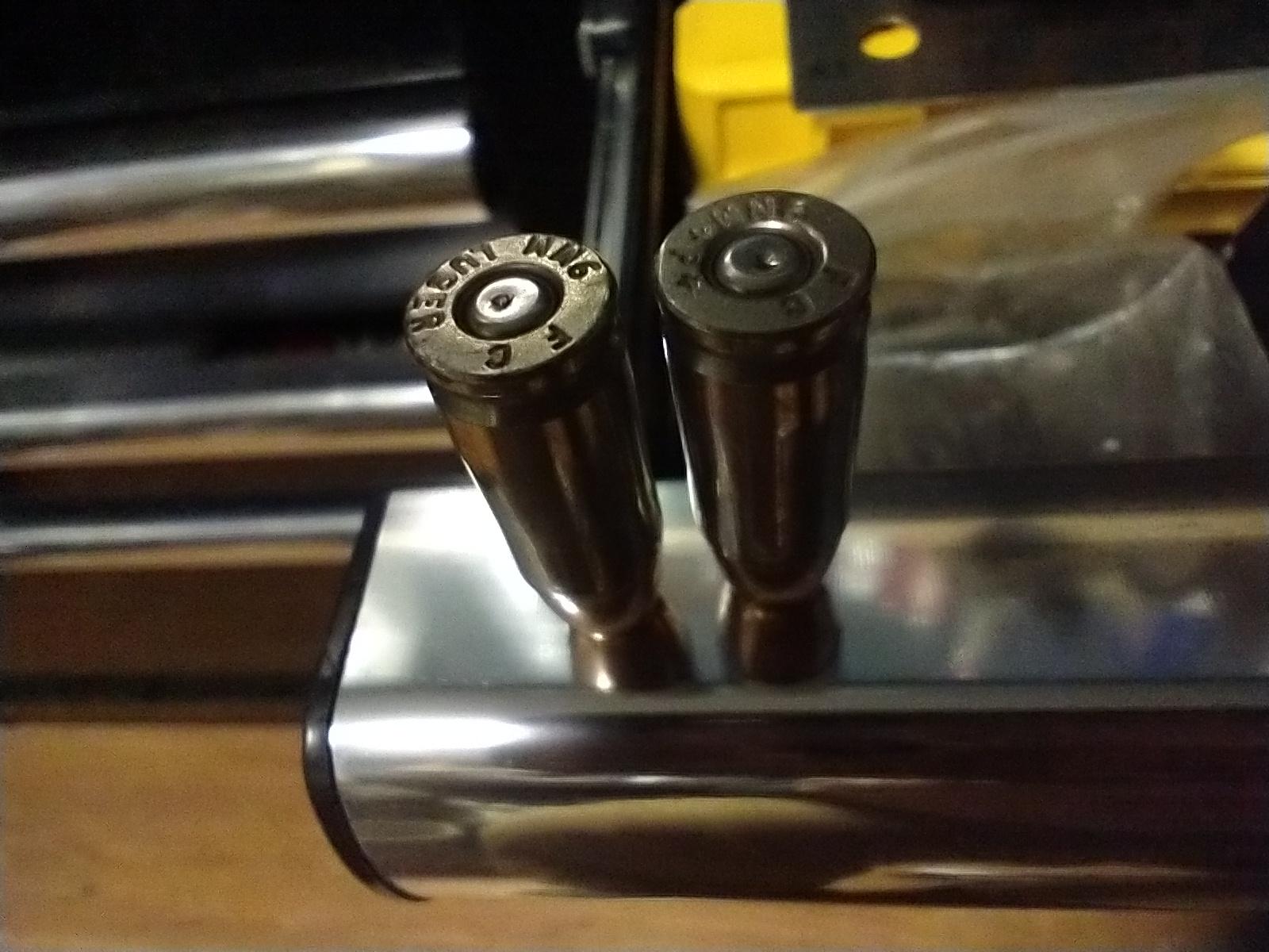

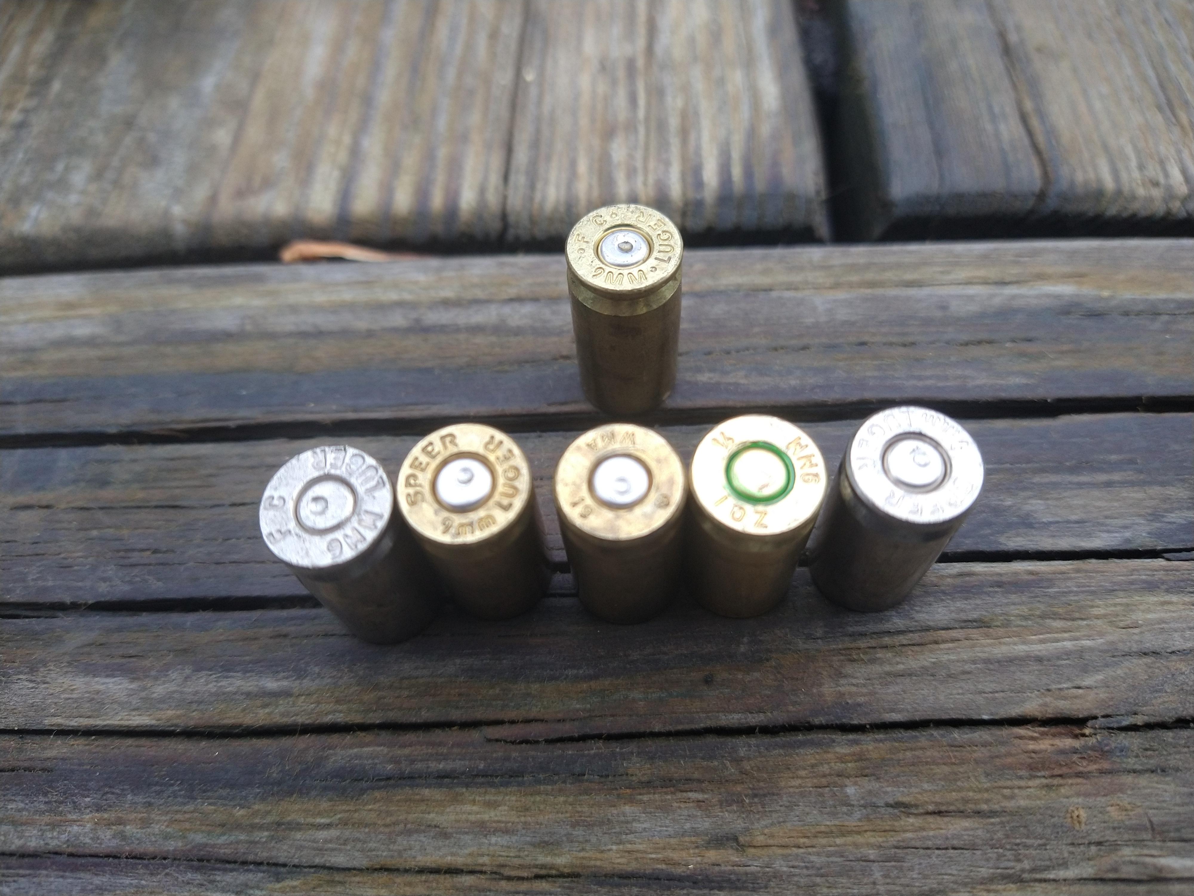

OK after my initial light strikes issues I got a 20% stronger striker spring. It seemed to help but I had a few more today. Decent defense ammo no less. Now I'm thinking about turning the firing pin back a few thou so I can count on a bang when I need one!!!

I guess I could. When I talked to them they didn't seem to have any available solution. It only ftf's about 2% of the time. Even if it goes bang "most of the time I wouldn't consider any of the primer strikes adequate. I haven't heard back from my most recent email yet but then holidays and all.

Even with a 20% stronger striker spring it's still not 100%. It's actually leaving what I consider a dent which is an improvement but it still doesn't light off rounds that a High Point will. If I turn the firing pin back .010 and put a nice radius on the face it might be as reliable as a Kel Tec. If they don't get back to me next week I'll probably just chuck it up in the lathe and take care of it. I'm kinda pissed that I spent $700 on the Gun and optic. I could have had 2 SCCY's or Taurus for what I spent on this. Of course my Kel Tec needed what would have been a few thousand dollars worth of work done to it before I considered it a semi decent carry gun. My LCP and Ruger's reputation was the reason I spent twice as much for what is turning into another project gun. I'm honestly amazed at what I can do using the dot on this thing. I'm thinking this can be a 100yd minute of bad guy gun!!!

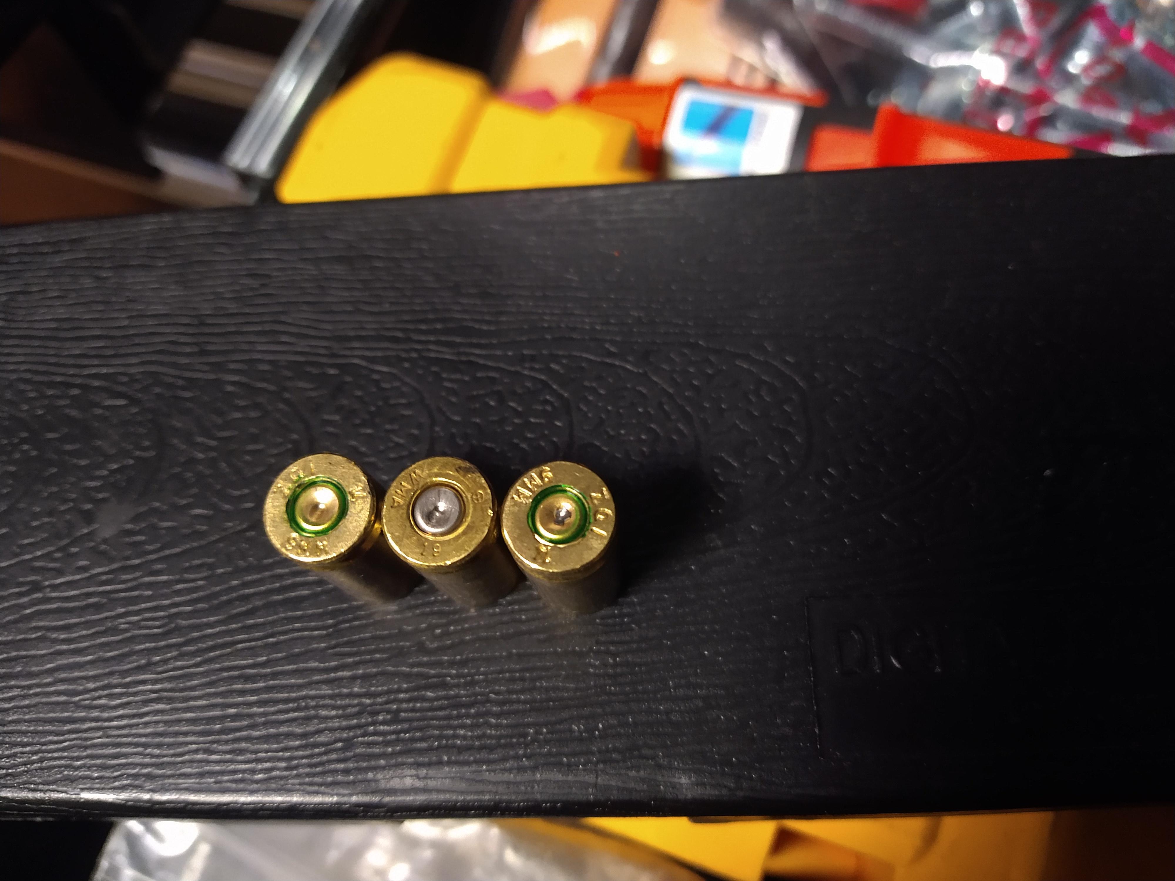

My LCP has been absolutely reliable from day one. Kinda like a Kel Tec with proper QC. The Max9 has incredible inherently accuracy. 2"@25yds rested. Having the dot makes it a viable 100yd minute of bad guy gun. Once I have solid primer strikes this will be my EDC. It will take me 5 minutes with the proper diameter mill cutter. All I have to do is pull the striker and give it a few turns by hand to remove.005-.010 from the front of the striker channel. I decided I don't want to risk creating a stress riser on the striker by machining it.

Problem solved. I took a .185 mill cutter in the striker channel and made it about .030 deeper now it strikes anything authoritatively. Now I'm finally confident in it going bang when I pull the trigger.

Might not hurt but it didn't seem to hurt the trigger pull too badly so I may as well leave it. I'll keep an eye on the primers and decide from there. I don't have many doubts about this being able to ignite a primer now.

If you don't have a selection of mill cutters a drill bit would probably be fine I don't see anything a little taper at the face would hurt. I would definitely be careful and use a set stop on the bit/cutter to ensure you don't go too far. Maybe .01 increments to be safe. I trimmed a little checked pin protrusion a few times before putting it together and hitting some primers.
