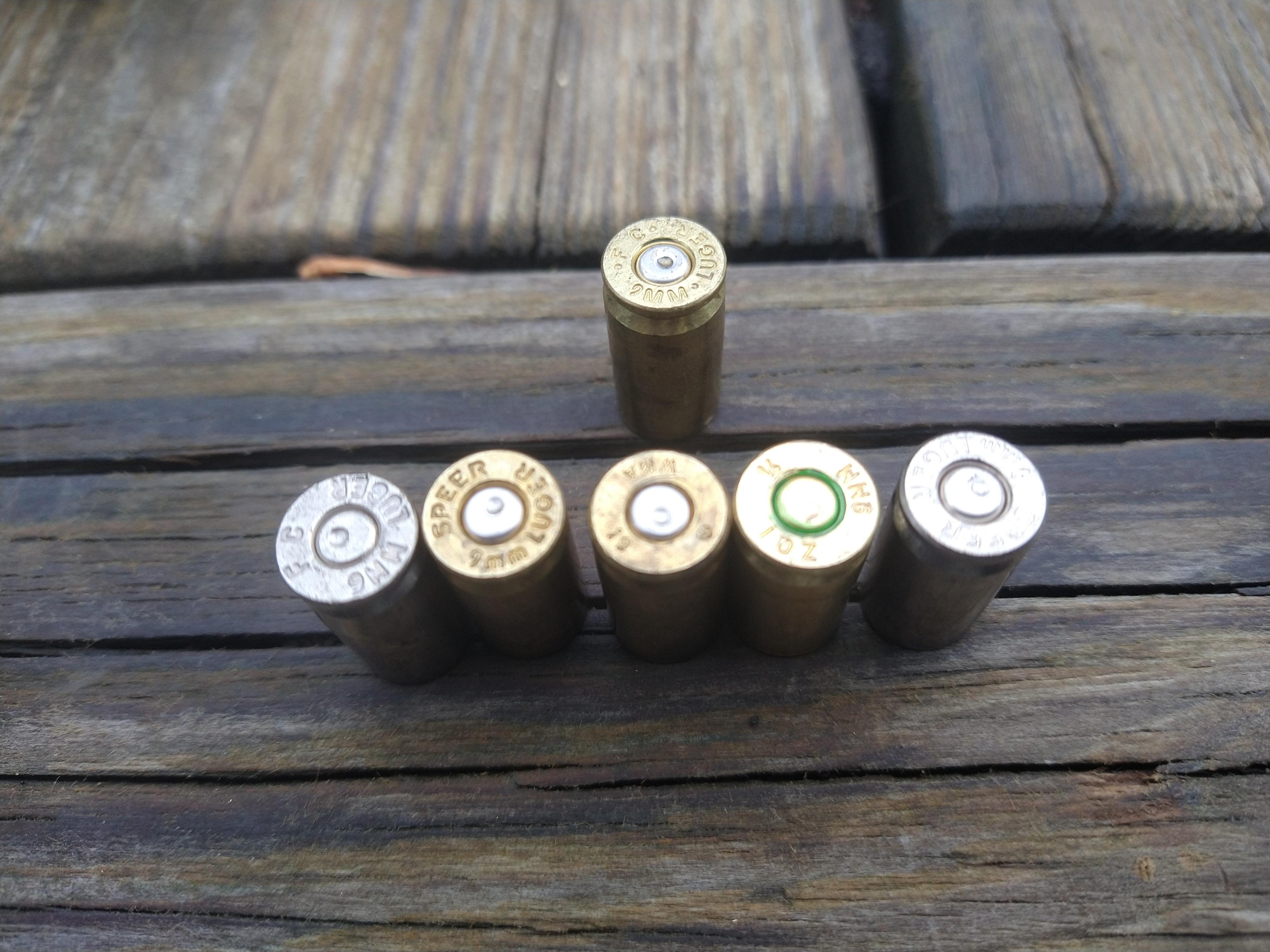

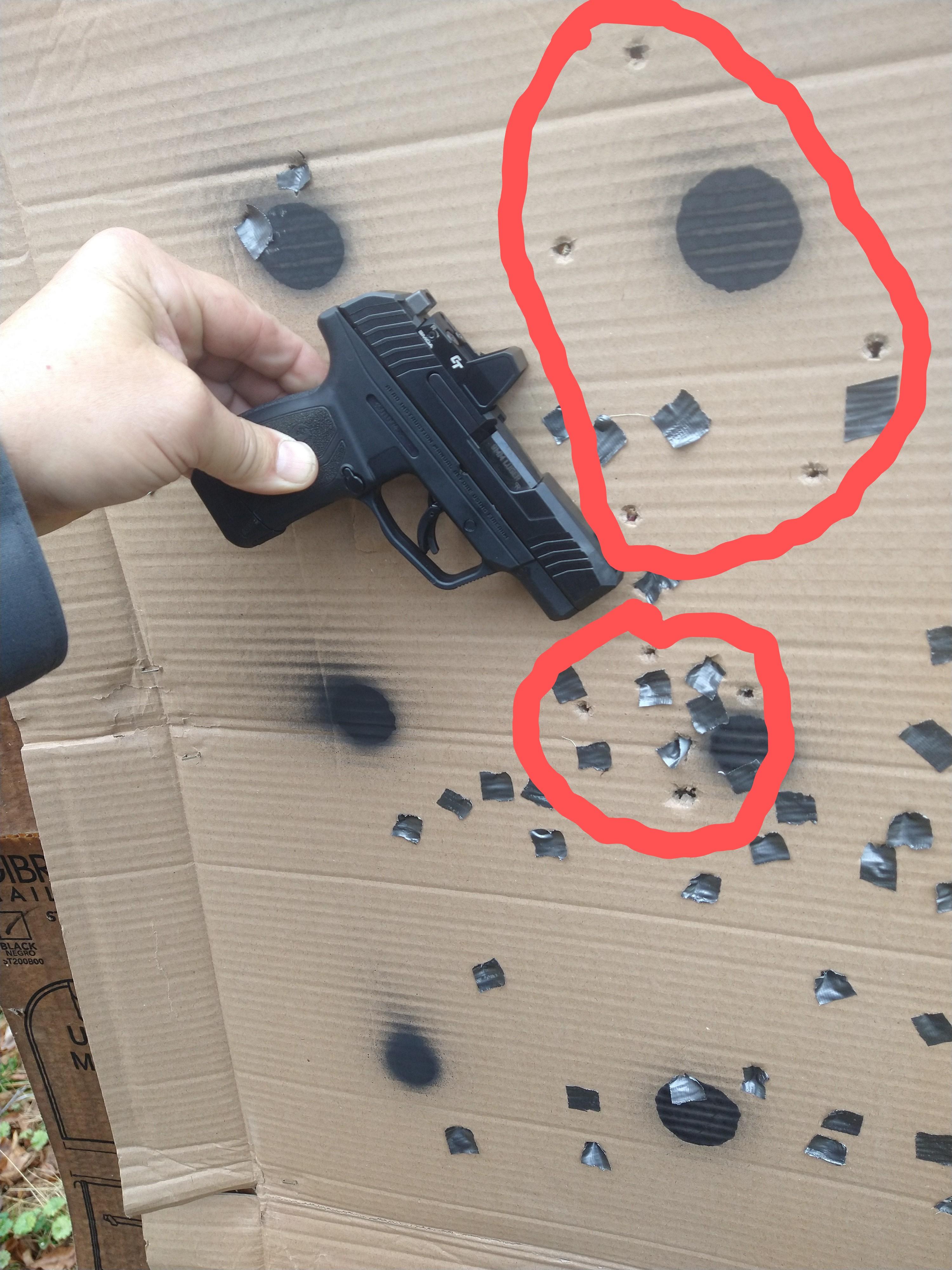

Exact same thing happened to me today. I had 3 ftf in 150. I would consider every round a light strike the primers seemed more smeared than stamped. Accuracy was great 2" rested 8" offhand at 25yds with the Crimson Trace.

I did swap out the trigger with the Galloway Precision Maxxis trigger and it really improved my shooting. No more low-left, though the very short pull and reset were a bit to get used to.
I put another 200 rounds through it with no failures.

I ordered the 20% heavier striker spring from Galloway. That should remedy the light strike issues. I'm sure I'll sacrifice a little on the trigger pull but hopefully not too bad. I contacted Ruger about it and they told me they don't have a stronger spring option but I could send it in anyway. I said no thanks and went to the Galloway site. I will also be evaluating the depth of the strike. I don't want punched primers but I want to know that they are being struck authoritatively. All of the trigger tuning kits start with lighter hammer/striker springs which is fine for a range/competition gun but completely wrong for a Duty/Carry gun. I was looking at the Maxis trigger but as you observed it makes the trigger a little touchy. I figure the additional take-up is a bit of a safety. The trigger is light enough that I got a recoil double the other day. It's a great gun. Accurate and easy to hit with especially with the optic. I'm almost wishing I would have gotten the standard with the safety instead of the Pro now. I usually carry my SA pistols with the hammer down because I can thumb it as easily as the safety. My Kel Tec and Gen1 LCP have the DA trigger for their safety.
Got the spring in the mail today and got it installed. That tiny port didn't want to give up the tailpiece. Getting those retainers back in was extra fun as well. I'll try it out tomorrow and find out if I need more setback on the firing pin.
