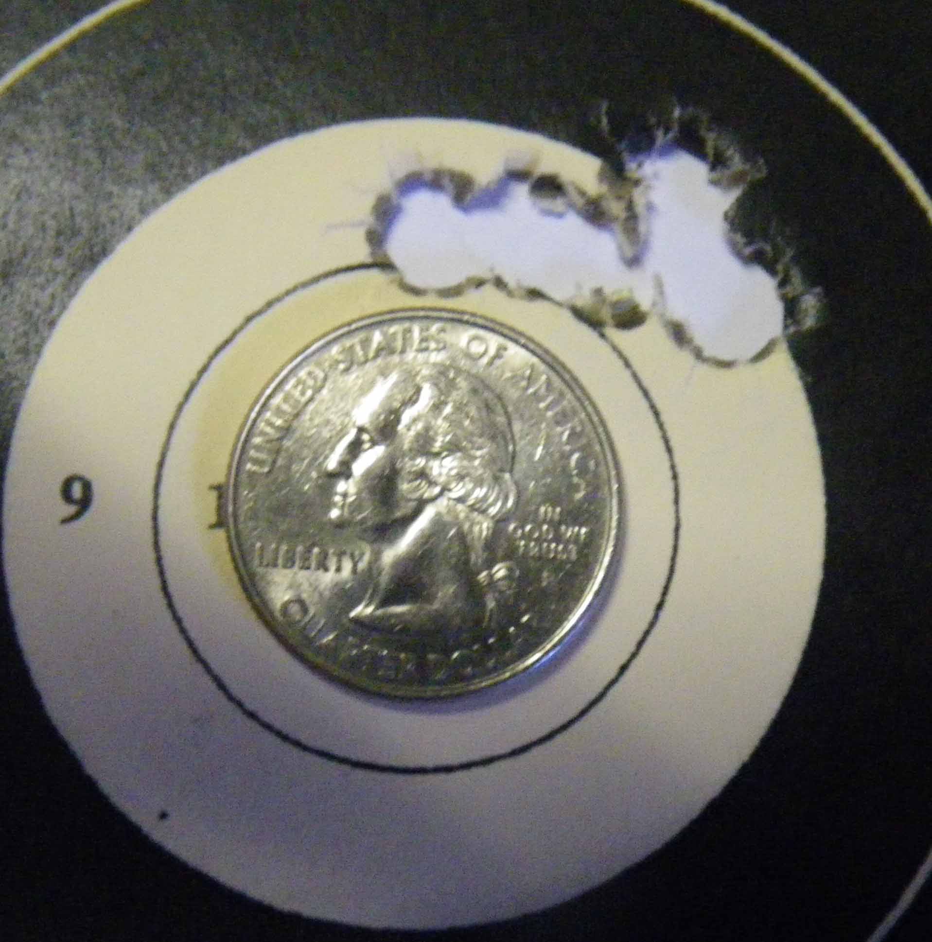

I had a No.1 RSI re-barreled to 35 Rem. and scoped with a Leupold 1.25-4X and it shoots fine as a 100 yds. deer rifle.

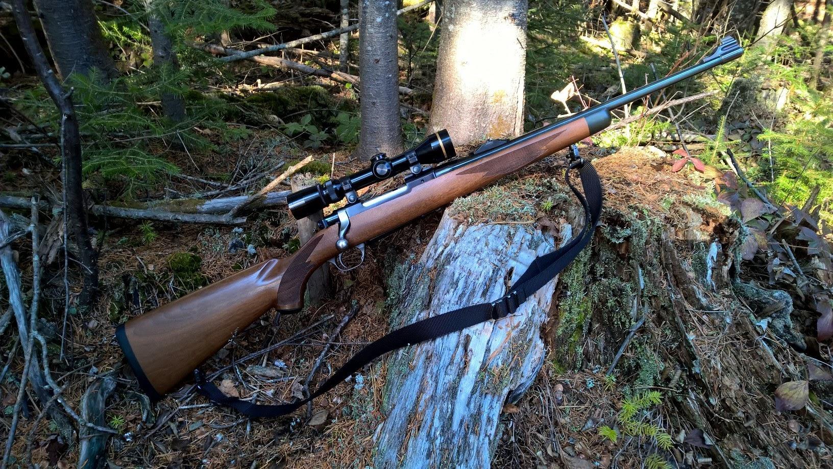

I wish that they would bring back the RLS. It's the same 18 1/2" barrel as the RSI but with a normal forend. I've got a 308 version that does everything I need a rifle to do. But if there were a run of stainless versions I would be sorely tempted. If it was in 358 Winchester I'd be reaching for a credit card.
