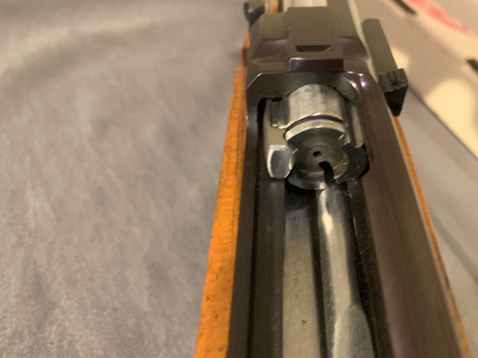

it is a possibility, but the odd thing is that they don't have the hole for the plunger style ejector in the bolt face. I’ll attach a pic below of the bolt face
it is a possibility, but the odd thing is that they don't have the hole for the plunger style ejector in the bolt face. I'll attach a pic below of the bolt face
It looks like all they did was eliminate the step to drill the hole for the plunger. It shouldn't be too difficult to set that bolt face up properly.
