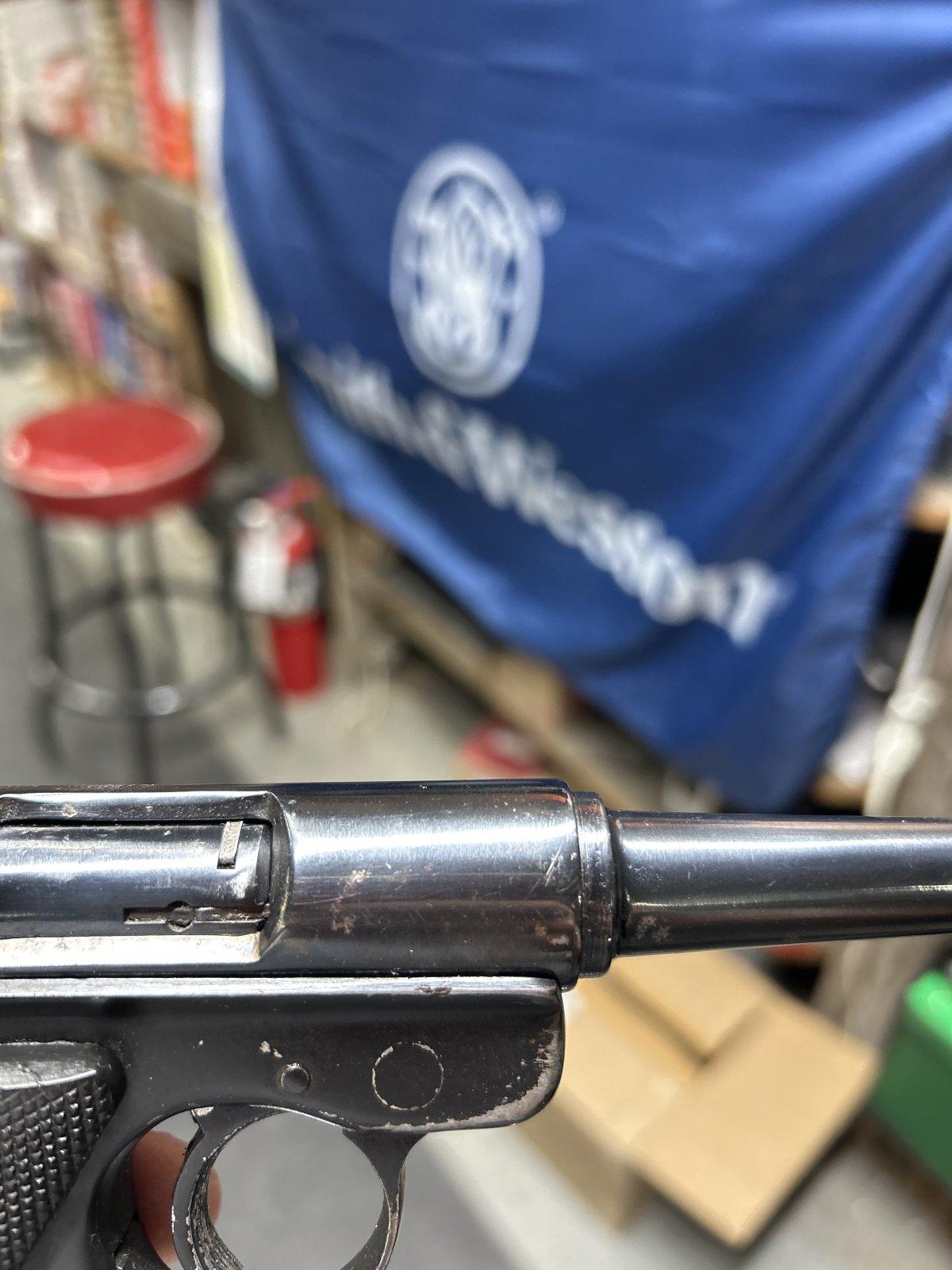

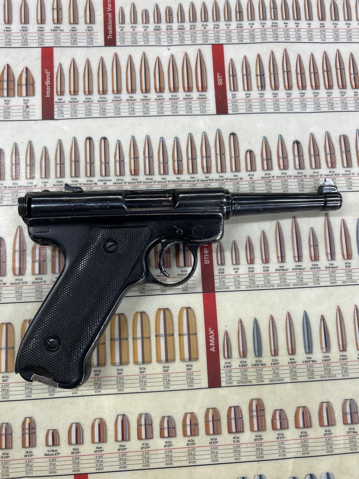

OK, i was typing as you posted your pictures, after looking at them. The pistol is NOT serial number 2, it has the wrong rear sight, rounded ejection port, should be square….and it looks like it has been completely polished and rounded….not original at all IMHO.
I also think i see the faint remains of a serial number, whomever did the work should have left the serial number intact!!
this gun was not manufactured in 1949 based on the configuration that i see…
Welcome to the Forum, yessir definitely not a Mark I, its a standard auto and much later than 1949 as noted above in the configuration of the rear sight and ejector port , muzzle, completely buffed and polished out , looks like they removed ALL the roll markings and restamped it..........hhhhmmm Salvage job??.........:unsure::cautious:
Nope, definitely not #2.
In fact, the real #2 did not have a serial number stamped on the outside at all. The major parts were handstamped 2 only on the inside of the pistol (1 through 8 were all like this, probably made without external numbers as I suppose Ruger figured several of those would be pictured in major magazine articles, probably also used for Ruger's earliest advertising.

OP, a lot of the folks who work at Ruger really don’t know anything about the history and configuration of older Ruger products. Many aren’t even gun people. That’s probably why you’re getting conflicting information from the factory and from people here on the forum.
Shooter value.
Imagine a gun that comes from the factory and sometime in its history has been completely buffed (heavily buffed!), I assume the original serial number was destroyed, and then reblued... which is not even close to a factory reblue since the bolt was never polished like original.
From the pic, it was produced sometime between 1952 and 1971, excluding the years 1953 to 1954 since that was the year Ruger used the the tapered ear bolt.

OP what did Ruger say to you in regards to being original and correct?
EVERYTHING stated here IS accurate info.
No way at all it is a legit #2
Serious felony for owning a buffed off SN like this one.
Can you explain how you got it? When?
