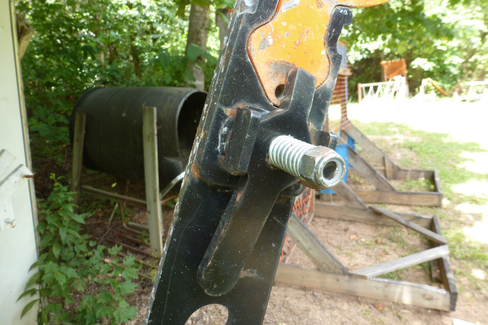

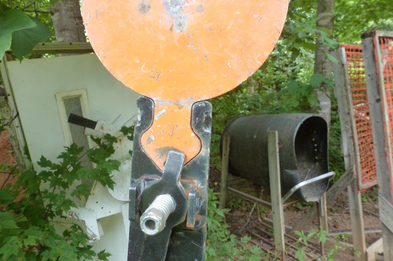

Ok, I got out & took a few pics today.
The critical thing is the way the plates are both stable AND how the can be easily knocked off if hit.
Here are a few pics of the way my plates are mounted.
