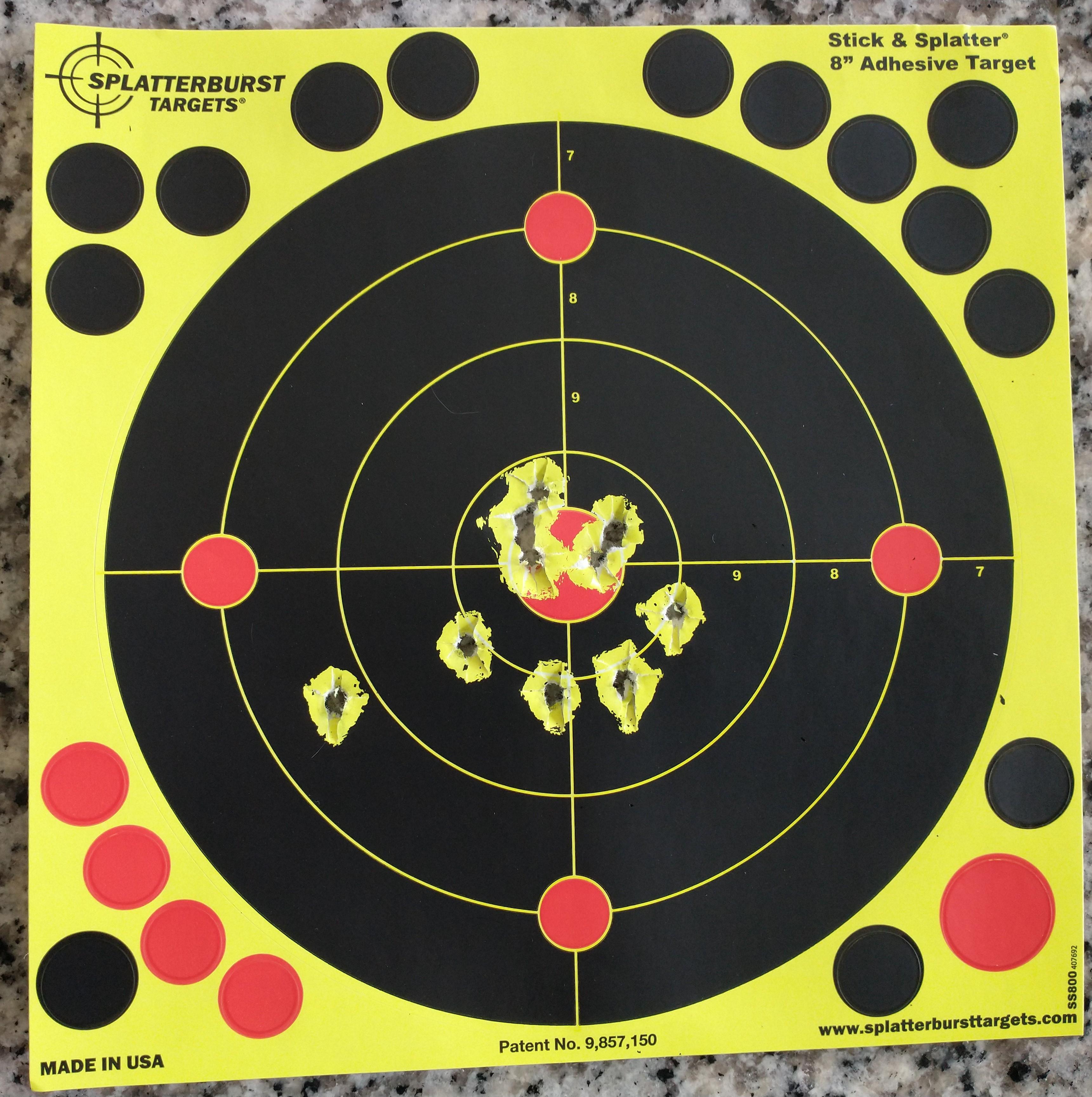

I did get the pistol back last week, and Ruger noted they replaced the barrel. I also got a target with a 2" group at 21', as Out West did.
I finally got a chance to shoot it today, and it shoots pretty close to point-of-aim now, assuming you use a 'combat hold' with the front dot over the intended point of impact. I also added a Galloway trigger, more to reduce the pain of shooting it than anything else, and that *really* seems to help the trigger control on this tiny, lightweight gun.
Groups today were much improved, though I still have work to do before I shoot this as well as even a sub-compact 9MM:
Larry

I wouldn't call them great by any stretch, but it was Speer Lawman jacketed ball.
Larry
