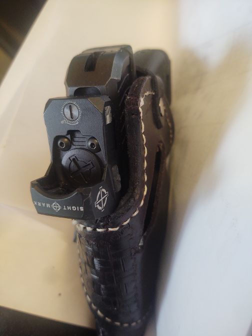

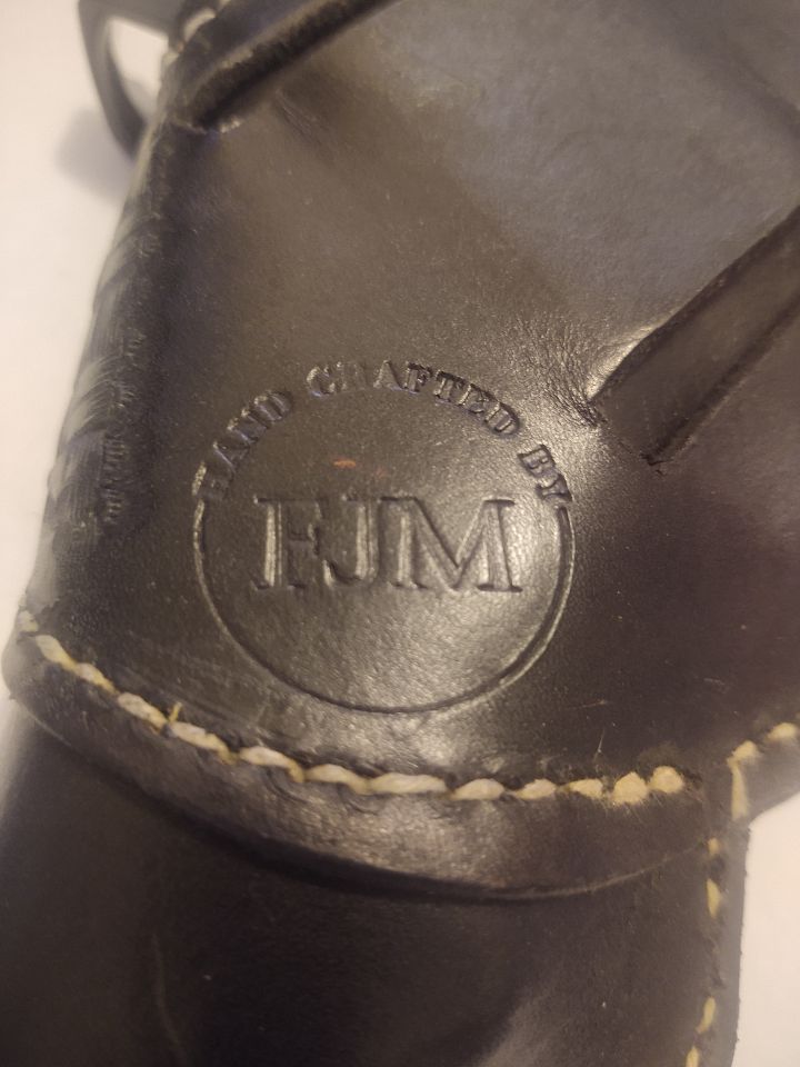

Installed a red dot on my Security 380 and then had to build a new holster to fit it. The stamping isn't my best effort but I was in a hurry to finish it.

As for what goes into a holster. Select the thickness of leather, make a pattern, trace pattern onto the leather (rough side), cut rough leather close to the pattern (allow for minor changes if needed later), scribe the lacing area, layout and punch the lacing holes, decide what (if any) design will be used then make measurements to and layout to stamp it. Dampen the leather and stamp the design. Allow to dry then dye (inside and out). Allow dye to dry. Lace the leather. Place whatever gun the holster is for in two or three plastic bags, thoroughly wet the item and insert the gun in the holster and mold it as necessary. Allow to completely dry. Remove gun from bags and insert in the finished "project".
BEAUTIFUL job! BTW- I bought an Armalite trigger guard laser site for my .380 and .22 LR LCPs. They make for all types. Anyway, I can use the same holsters. Kind of jealous of this one though.

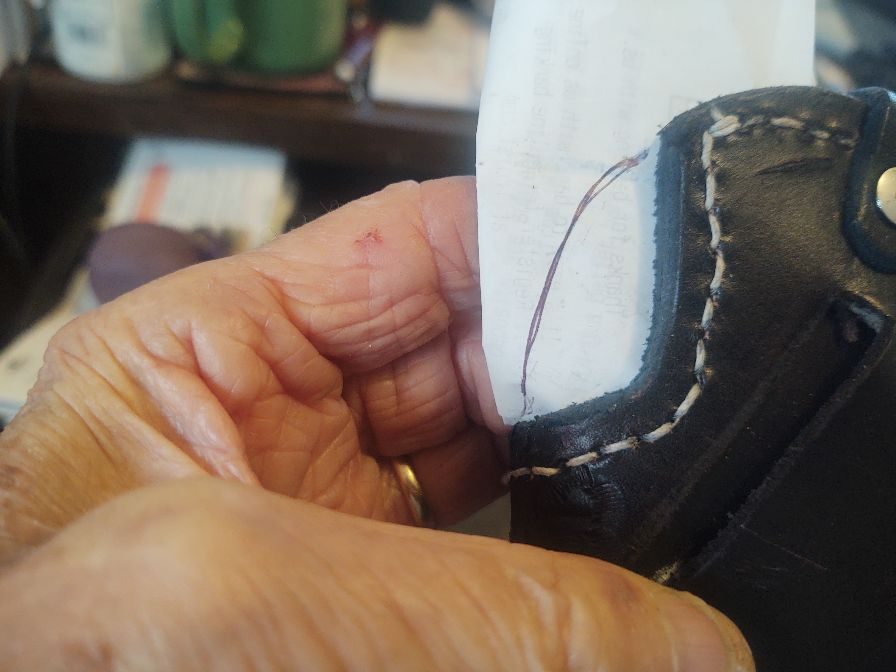

The holster was re-designed to fit the red dot sight. The first holster I made for it was built prior to the red dot being installed.
The portion between the line and the holster had to be removed and restitched to properly fit the red dot sight.
