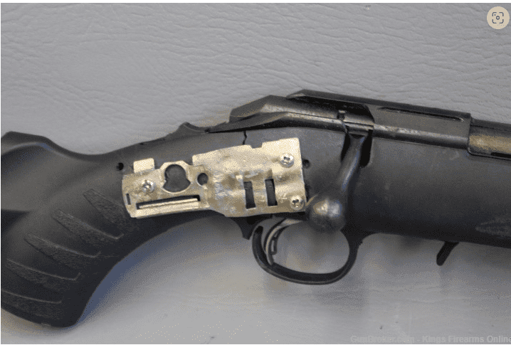

Picked this up for $147.00 to my location. Now the resurrection begins. The guy that previously owned it should be taken behind the shed and whooped. My car doesn't have as much 'gunk' on the moving parts as this had (I have been cleaning as I go). Will post some photos of the project later
Aargh! Just looked at the trigger assy and found the set screw (Allen head) for the trigger return spring is missing. Looks like a call to Ruger on Monday is in order. The two Allen head assembly screws were so rusted I had to beat on one to close it up enough to make the Allen tool fit so I could remove it. Truly becoming a "PROJECT" as opposed to a 'project'.
Took me about 10 seconds to remove the back drift pin on the trigger assy. Took almost 1.5 hours and half my tool box to get the other one out. Part of that one was broken and wedged in the 1/16" pin hole. It is a wonder the trigger worked at all as dirty as it is. Haven't gotten to the parts cleaning yet (trigger assy and bolt). Then I had to cut the front sight in half to unscrew the Allen screw; it was too tight for a small Allen wrench to turn without stripping the head. Just finished cleaning the bore. Whoever had this rifle before I got it shouldn't be allows a straw to shoot spitballs. I AM going to have it ready for the gathering if my rebuild parts ever arrive from Ruger. They have been sent but UPS is dragging their feet delivering them.
Found out a little late the the 1/16"drift pin hole and pin are actually 5/64" and were just that crudded over that a 1/16' barely would fit the pins.
This is what I had to start the rebuild with.
