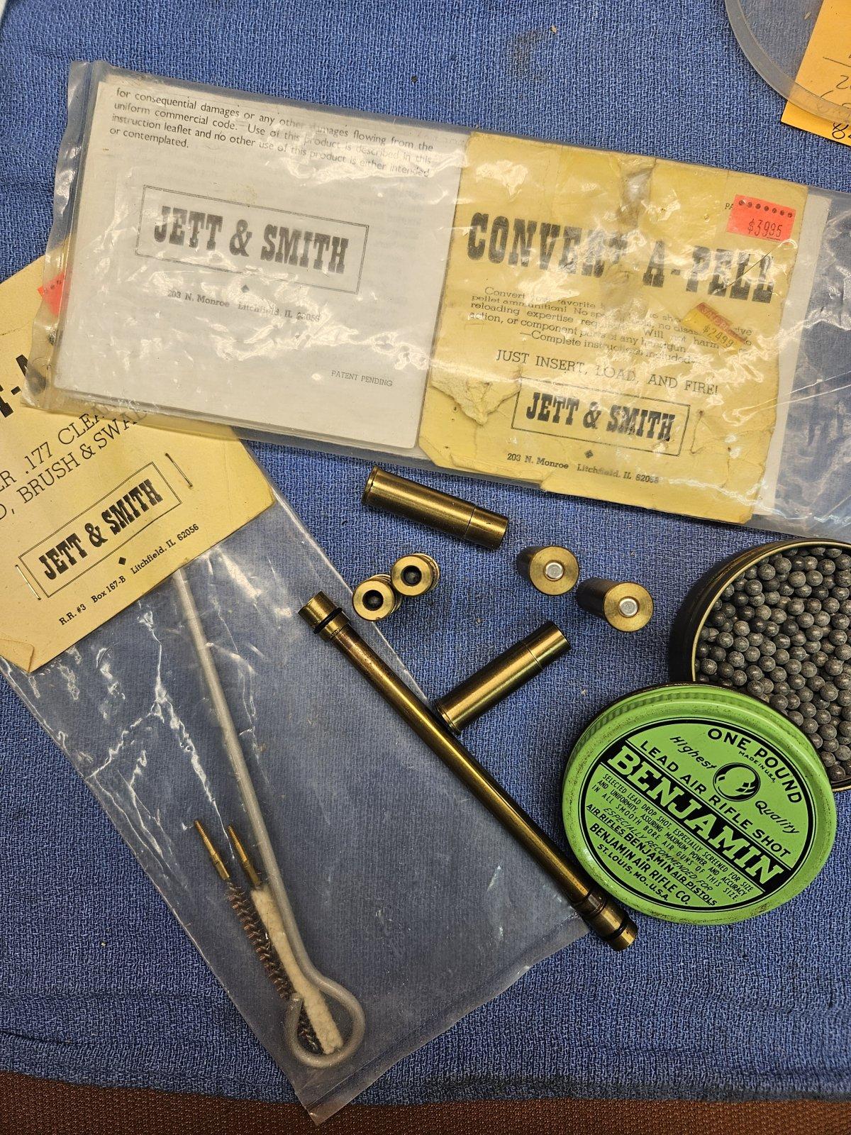

I found this tucked away, haven't seen it for years. I bought it and never used it. It turns a 44 mag revolver into a pellet gun! I'm going to try it out this week.

How did it perform, accuracy and power?
Sometimes primers backed out of case pocket preventing cylinder from turning
I used them for handgun training my wife and daughters in the basement in winter.
Accuracy was passible for self defense training to 15ft. Foam Ear plugs used.
Having wax right temp when loading rounds was important. A little soft worked best. I poured a flatbar of wax as thick as maximimum projectile length, laid wax bar on a piece of flat sheet metal then stabbed primed case into wax near an edge of the bar, twist the loaded case off the sĺab edge.
