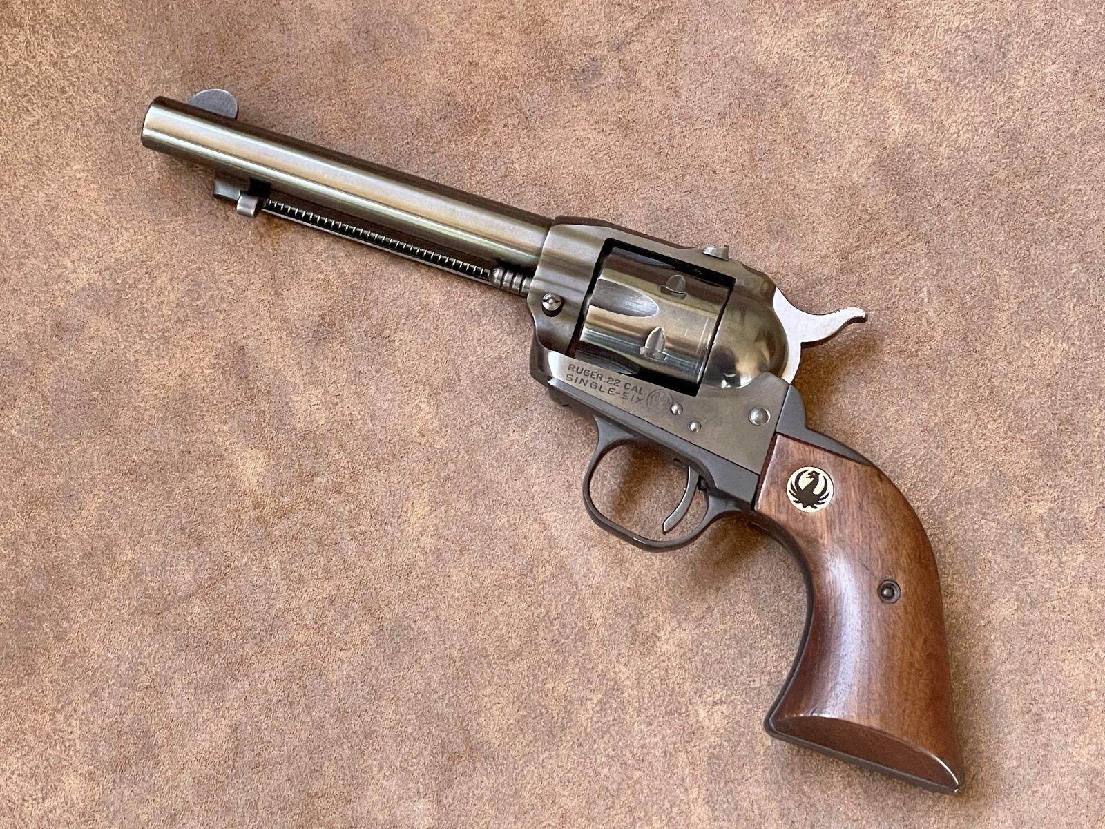

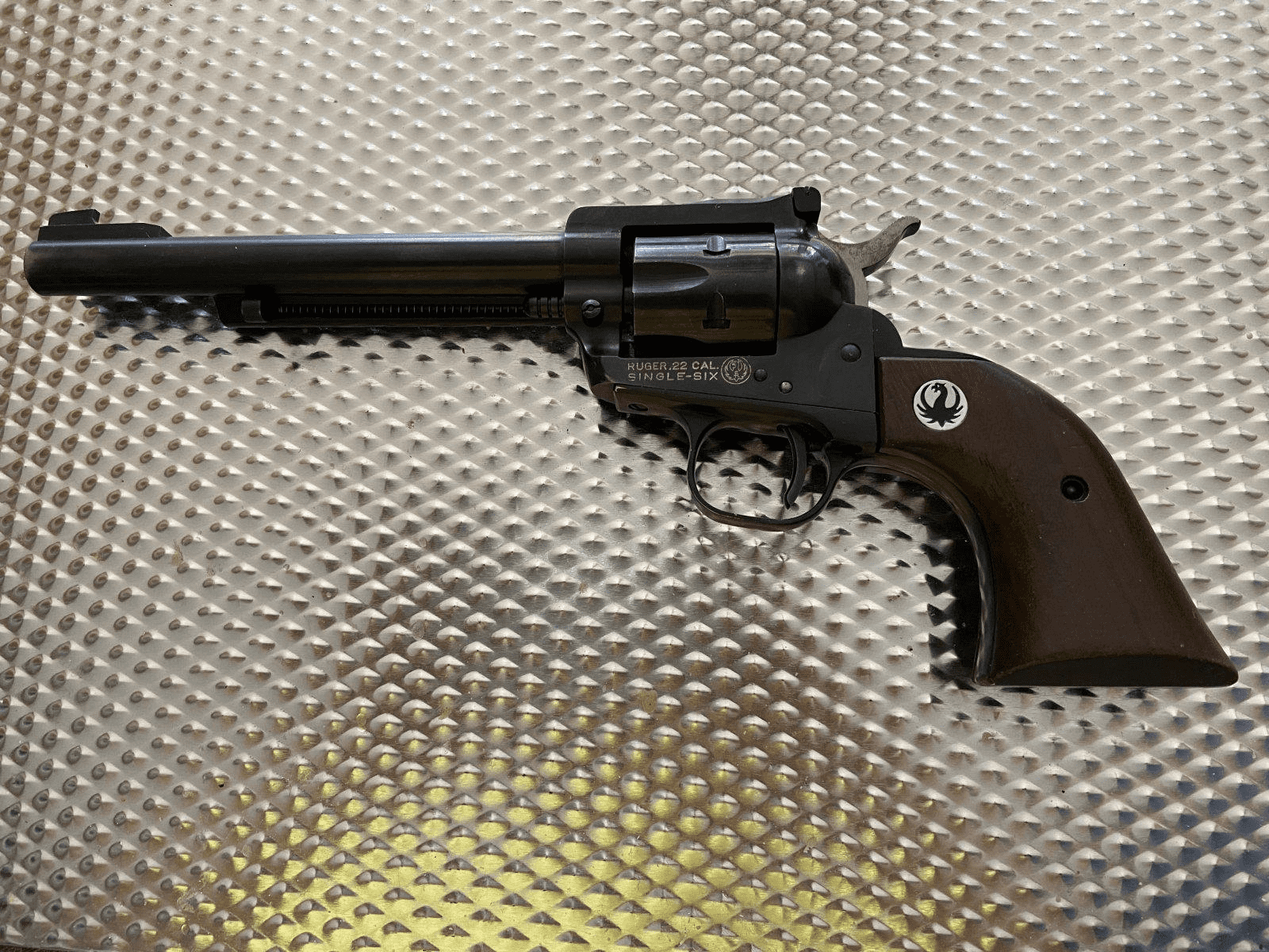

I recently purchased a 1963 Single Six on GB. No box or paperwork, but the price was cheap…well, the day after I won the auction I sent off for the Letter of Authenticity. The gun arrived and as I documented in another thread, I’m thinking it has been reblued because the finish is too nice- and there’s absolutely no turn line. I was excited to get the Letter, as this gun was built in 1963, the year my wife was born. Well… I got an envelope from Ruger today. Not one of the big ones, but a business envelope. Inside was my check and a letter that informed me that Ruger had no records of when it was manufactured or shipped. What!?!
So…does anyone have a gun close up and/or down to the serial number- 366710 so that I could get a close guesstimate on when it was manufactured.
If I can tie it down to the month of my wife’s birthday, that would be cool. If not…well…does the inability to get a Letter affect the desirability? I want to “trick out” an old 3 Screw Single Six. Being that it might be refinished and there is no Letter, what are your overall feelings on “making this one my own”.
I’m not a “collector”, really I’m more of an accumulator. I appreciate nice stuff and have no intentions of ever selling any of my Rugers, but I don’t want to modify a gun with meaning. So…if you have any clue on dates, or any words of wisdom- please let me know.
Ok, it MAY be that the records Ruger is referencing to are part of the records that were damaged in a flood long ago. Hence, the lack of correct info, and details.
The only detail I can attest to, comes from the RENE Guide,, and it only gives the year, 1963 which you already know.
But, by the pictures & info we DO know,, 1963 is known as the "transition" year. Guns were getting a few changes,, and one of which was the grip frame,, from an XR3 to an XR3-RED. Your gun has the XR3-RED g/f.
Is the ERH steel or aluminum? (Most likely aluminum.)
Did you get a spare cylinder in .22 Mag?
Check the face of the cylinder. Does it have the last 3 digits of the serial number "scratched" into it? (They used an electric pencil for this.)
In general,, by the appearances of the gun above,, it appears to be a Type 3 Transition version.

The revolver only came with the .22LR cylinder, and the last 3 digits are marked on the face of the cylinder. So I would guess it is a convertible model. The ERH is aluminum, and the grip frame is the XR3-RED style. Overall it’s in great shape, which again leads me to believe it has been refinished.

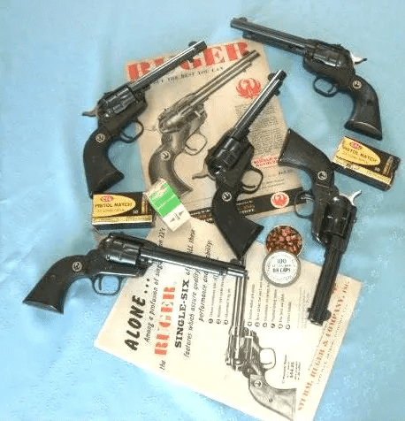

"I'm thinking it has been reblued because the finish is too nice- and there's absolutely no turn line."

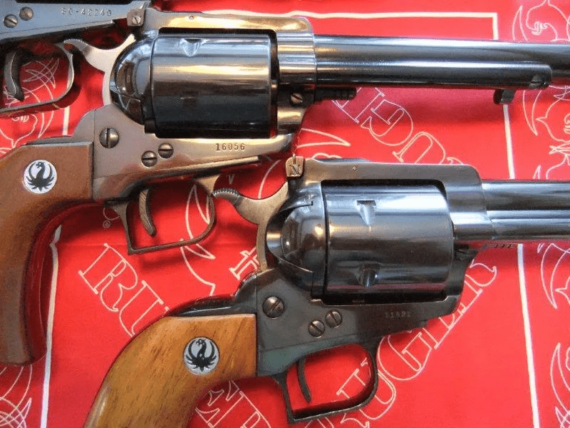

Let me add this and not to offend. Just because a gun finish looks nice doesn't mean it as been reblued. My Old Models do not have turn lines on them by me.
I along with several on this form have Rugers much nicer than that one and they have not been reblued. Yes that one looks like it has been over polished and reblued. It is a nice Single-Six enjoy it :)
Several years ago I sent a beater old model 357 Blackhawk back to Ruger to be reblued. It came back looking like new and most people would not have known it had been reblued. Cost was $35.00

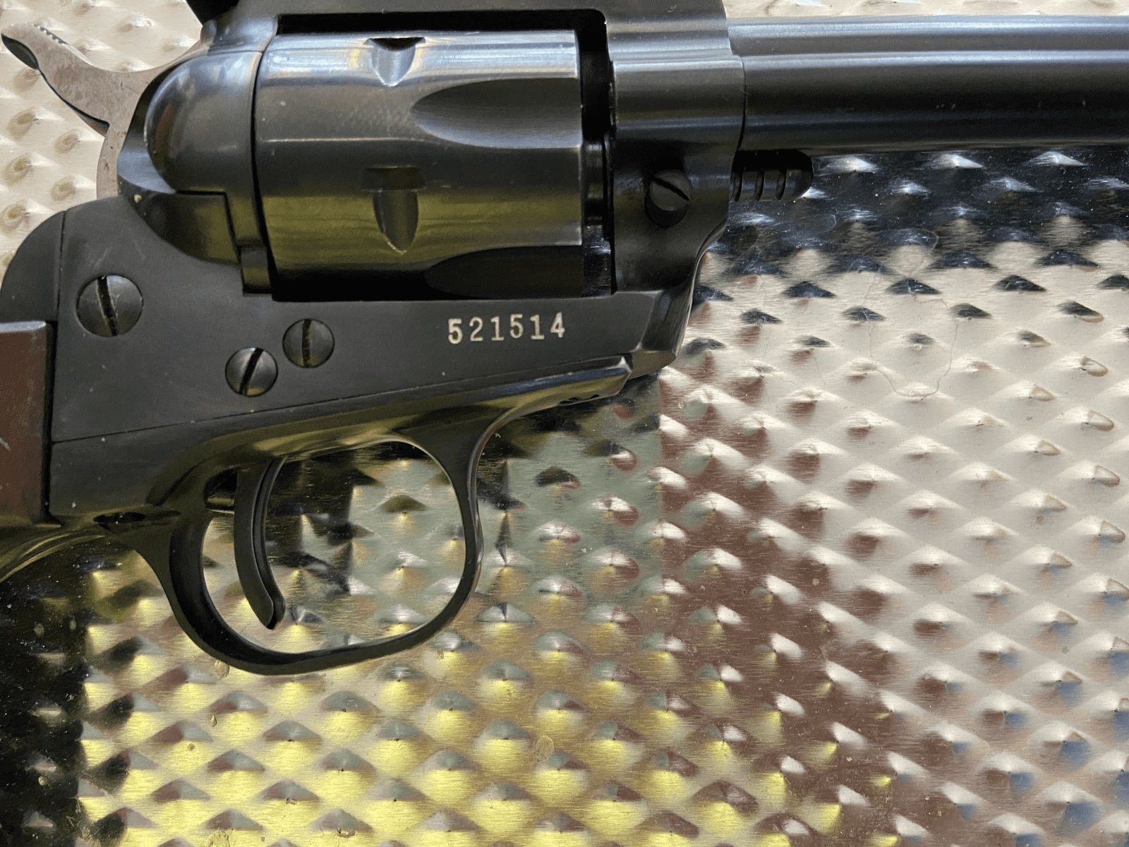

Here is a nice shooter that has not been reblued.
Notice no turn lines and a couple Grandson used in SASS competition

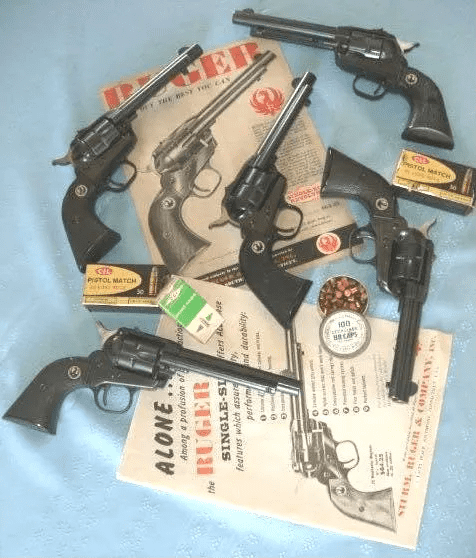

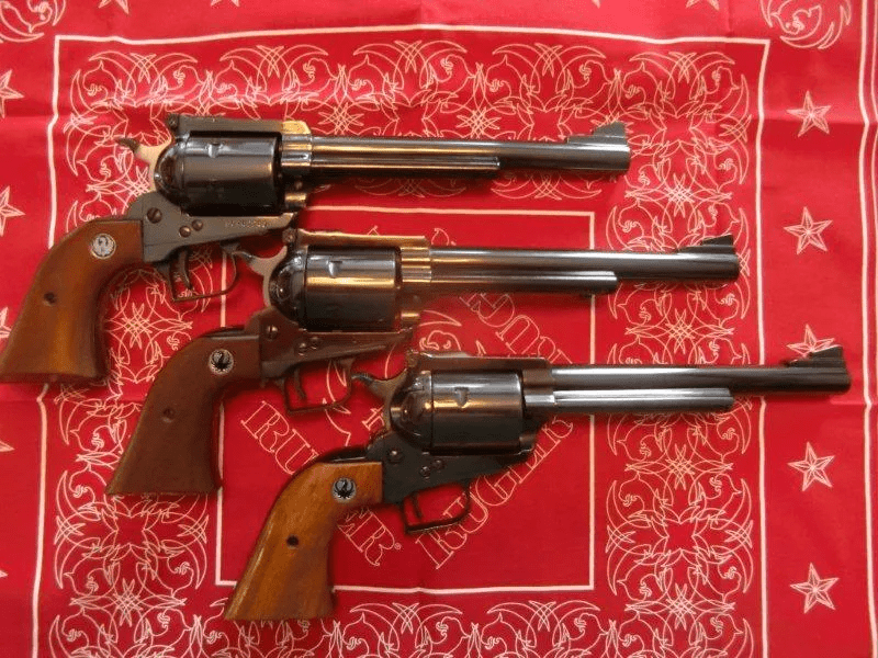

Beautiful Supers!

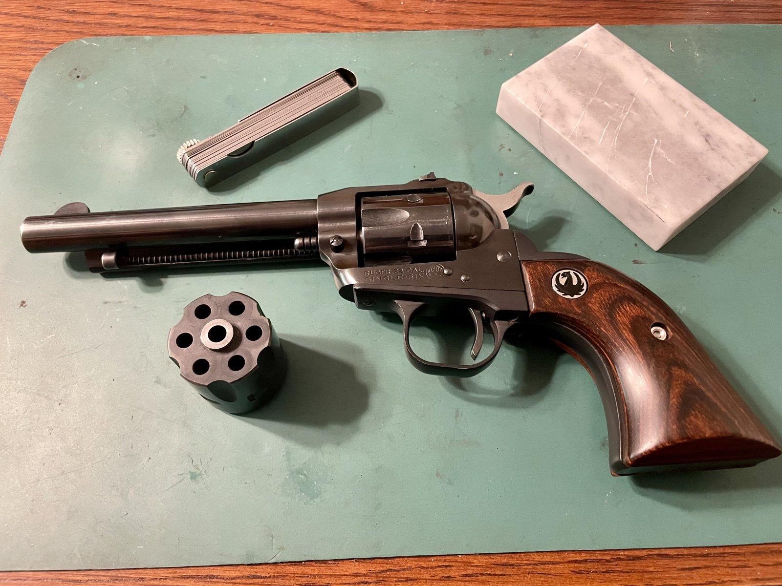

Mag cylinder is fit. The dimensions were just a hair long at the gas ring, so I took that hair off and it fits great. Checked timing- spot on. Dropped my 7/32 gauge rod down on each cylinder bore and there was no hangup. Proof will be in the firing- but I’m thinking it will be good.
