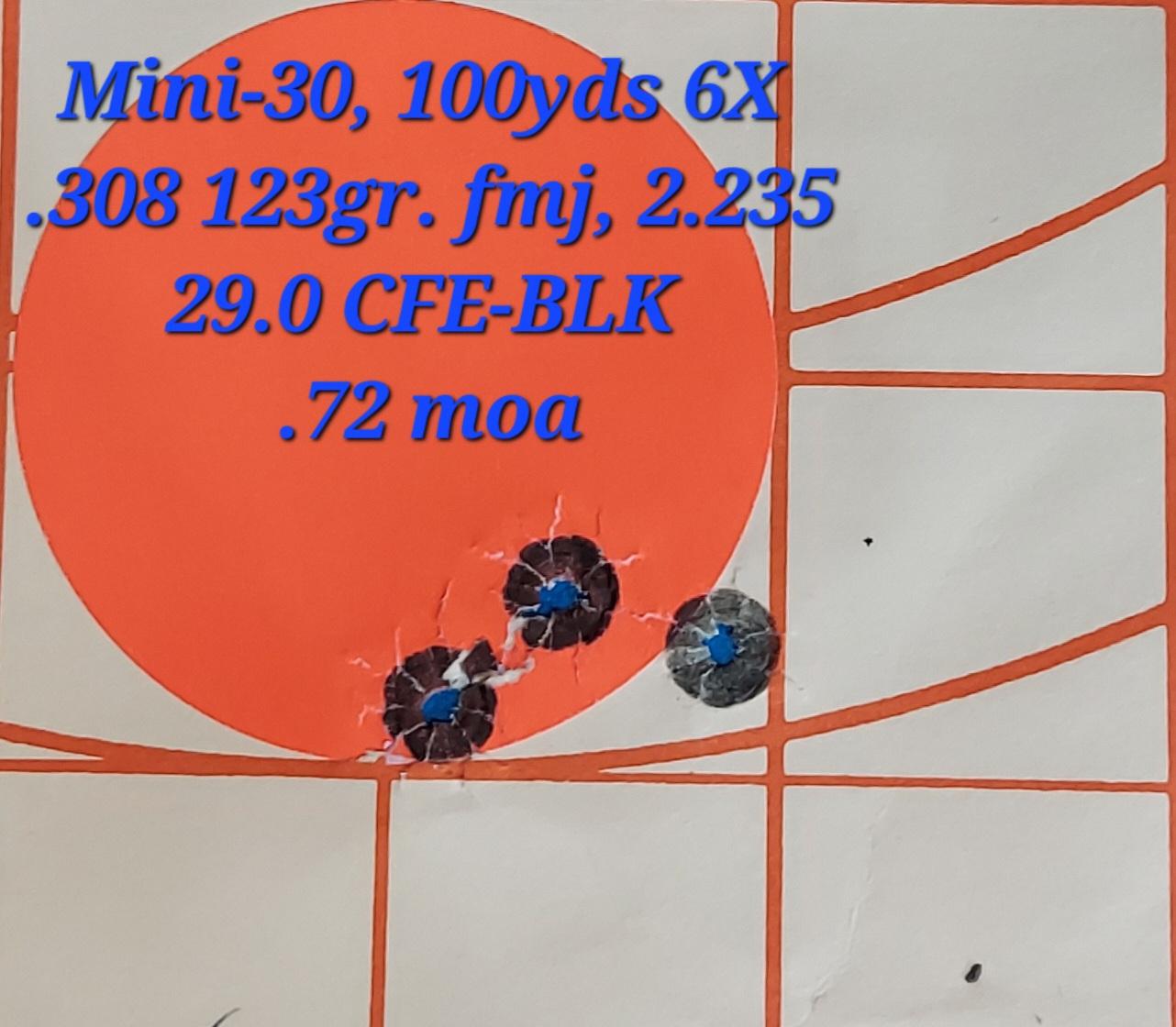

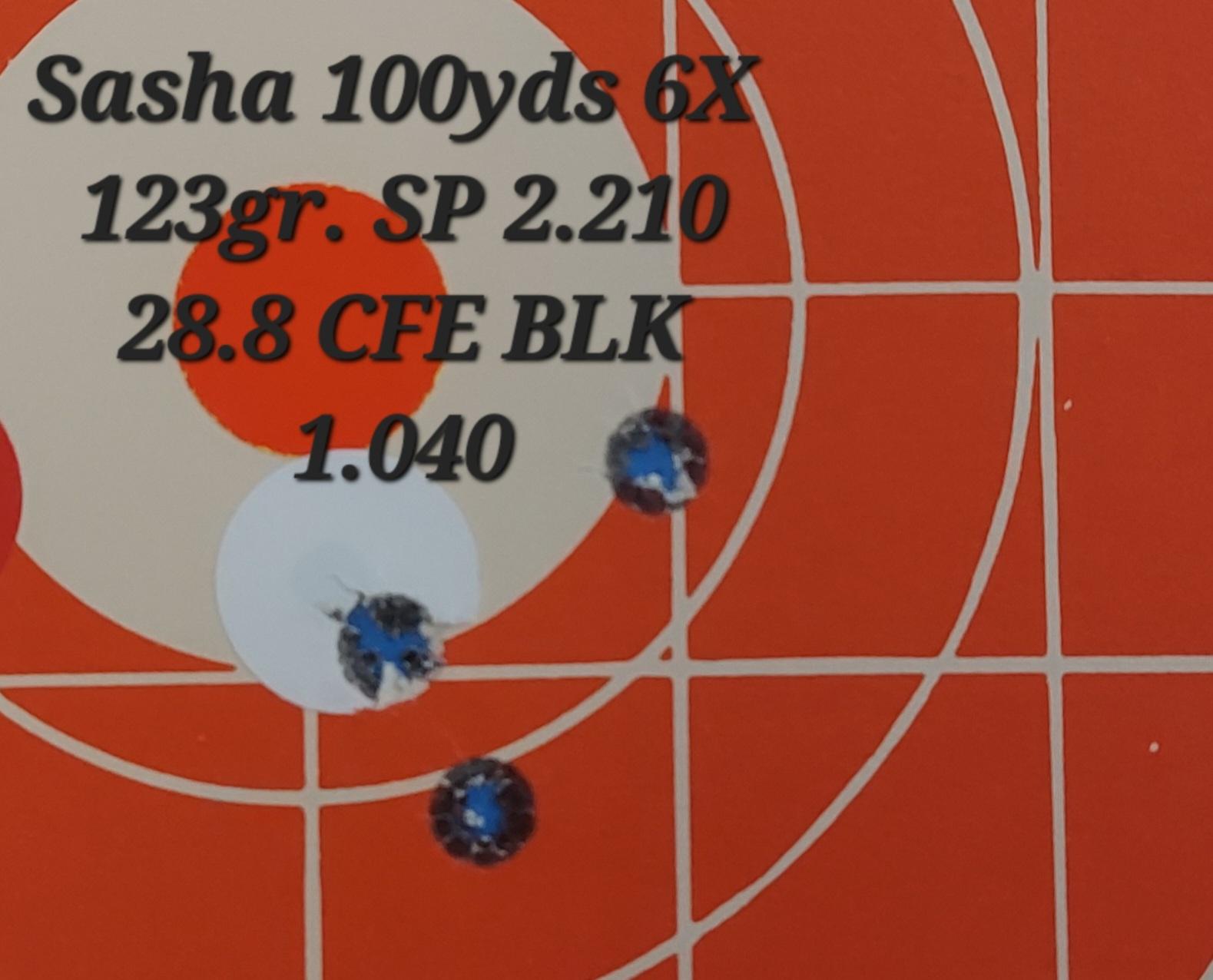

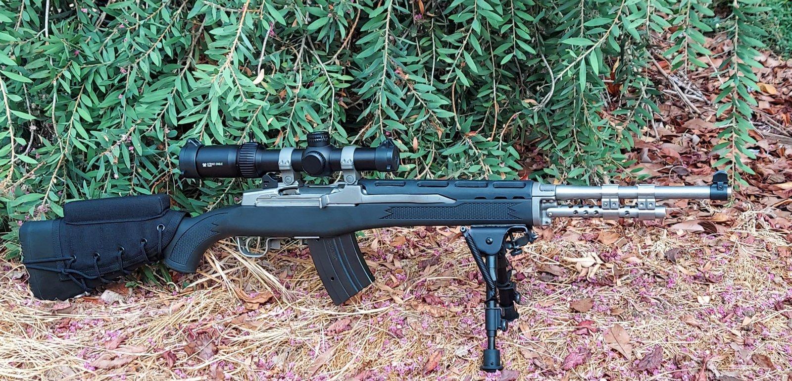

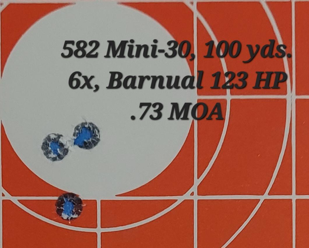

I have a Mini-30 that is Awesome. 100% reliable with any ammo and moa with handloads.
Some Mini-30's do need more firing pin protrusion to consistently light off the deeper sitting primers in russian 7.62x39 ammo. I handload .308 and .310 bullets with equal success. Also have an accurate Nosler Non-lead hunting load.
AK's, SKS's have much more firing pin protrusion. ASI makes an excellent replacement firing pin for this reason.
I definitely recommend a new
Mini-30.
    412.9 KB
    109.8 KB
    79.3 KB
    115 KB
