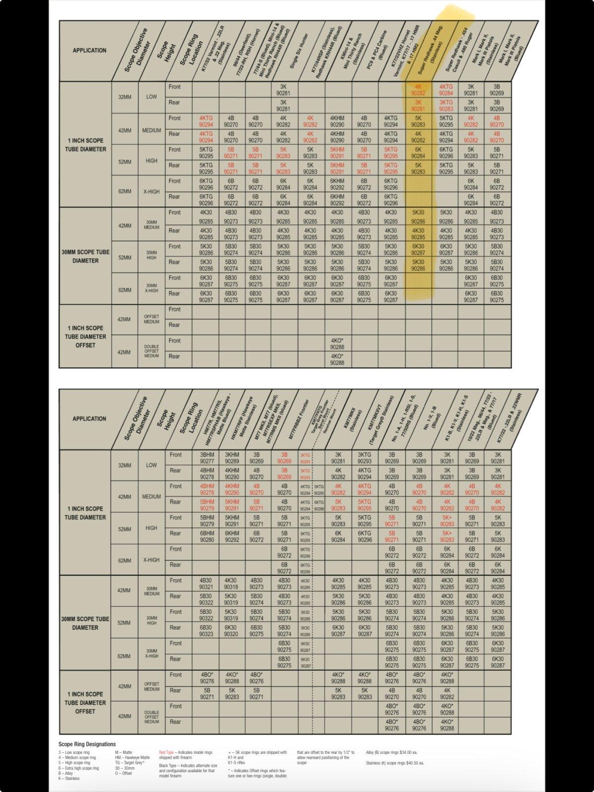

Here's the chart showing what comes from the factory (in red):
https://shopruger.com/PDF/ScopeRingChart.pdf
You likely will need a #4 (Medium) up front, and a #3 (Low) in the rear.
(Those are the rings it comes with… good starting point, at least!)
Objective lens should be a non-issue.

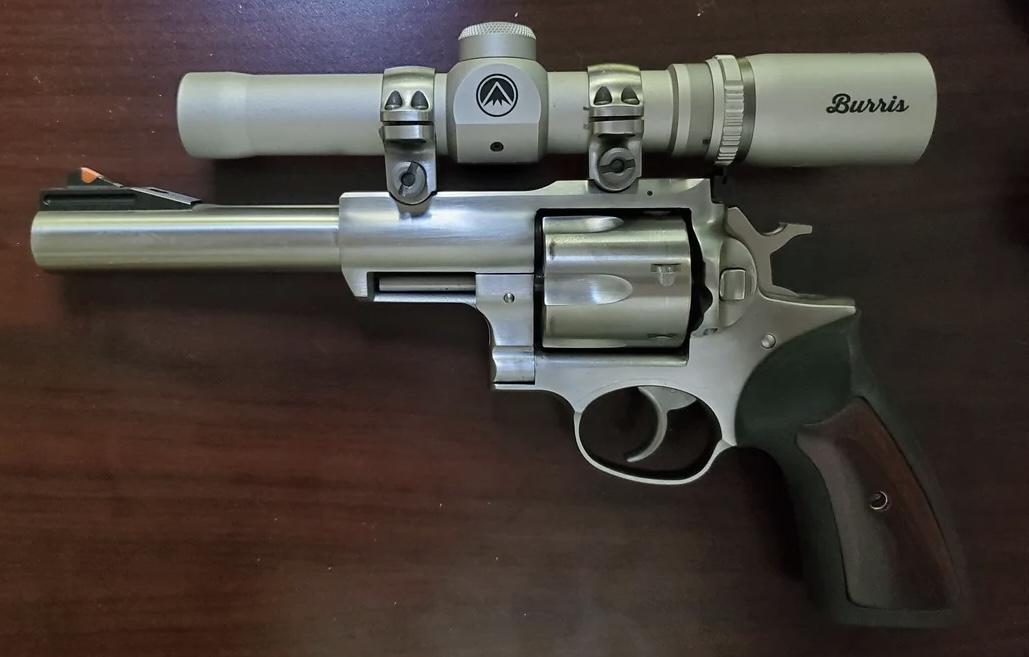

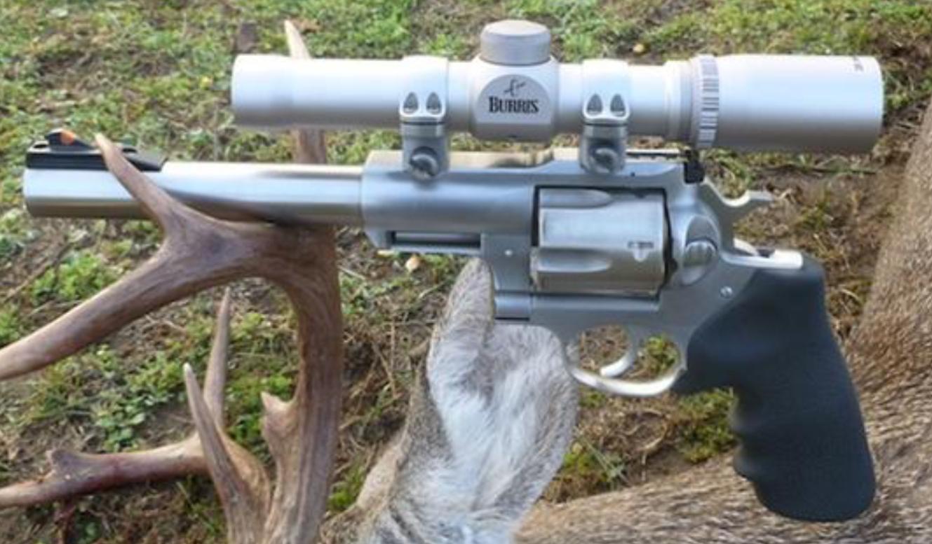

If you need pictures,, I can post one. Do you just want the rings or a picture of them on the gun?
If you could post a pic of that scope mounted, I would really appreciate it. I would like to see how low it mounts.
Thank you.
If the pictures above don't show what you wish to see,, let me know & I'll take one of mine. But I will say mine looks close to the top picture.
looks like a medium in the rear and the high in the front, isn't that what comes with the gun??? if you want higher, use the front one in the rear and get the extra high for the front ,one step up for each ring does the trick..at least these days you can buy an individual ring, instead of having to buy the "set" ( pair).......... ;) :cool:
Am I missing something? Why not get and use the rings described in the chart posted?
BTW …. We should save that chart and keep it here somewhere.
meh92,, look at the chart posted. It gives you the part numbers, and height listing to match whatever scope you may have. hittman has it right,, look at the chart to see what you may need.
Uncle Howie has even highlighted your gun on that chart. If you are worried about scope ring clearance,,, look at the chart,, it gives you your options.
