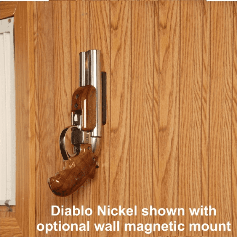

What's supposed to be the advantage/effect of magnetizing a gun?
Many people use gun magnets to secure their pistol/rifle, etc. to a convenient spot in their truck, car, tractor cab, or some piece of furniture in the house and still have it readily accessible. Perfectly legal in many States to have a readily available loaded gun accessible to the driver or passenger. Some States will take you to jail for it tho, so you should know the laws that apply to your travels.
For example this is a popular mounting:
Old and grumpy
Aug 7, 2022
208
NV
I want one! https://americanguncraft.com/products/?trimuzzlesites
