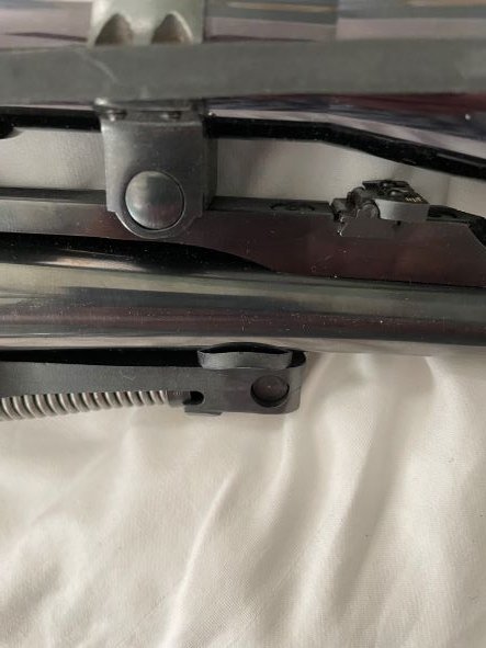

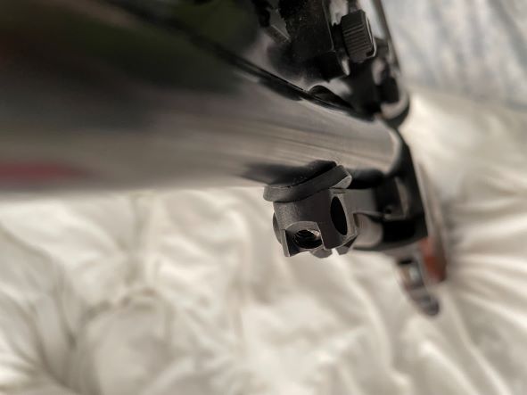

Hello and welcome to the forum! I have a No. 1 from 1977 that did not group well. I am not sure where, but I came across a tip to insert a rubber washer between the forearm hanger and the barrel. Another tip is to make sure not to overtighten the forearm screw. Once I inserted a rubber washer, my groups tightened up a lot. It's not a tack driver but I have yet to miss what I aim at.

Thank you, already tried the washer. Been researching old forms for information and a piece of rubber between the barrel and forearm has been done, but I will most likely by the Hicks for Christmas and bed the forearm. I know it will not be as good as my 6GT, but why not try.
