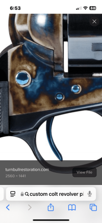

Here’s the look and they are stainless. Great if that easy

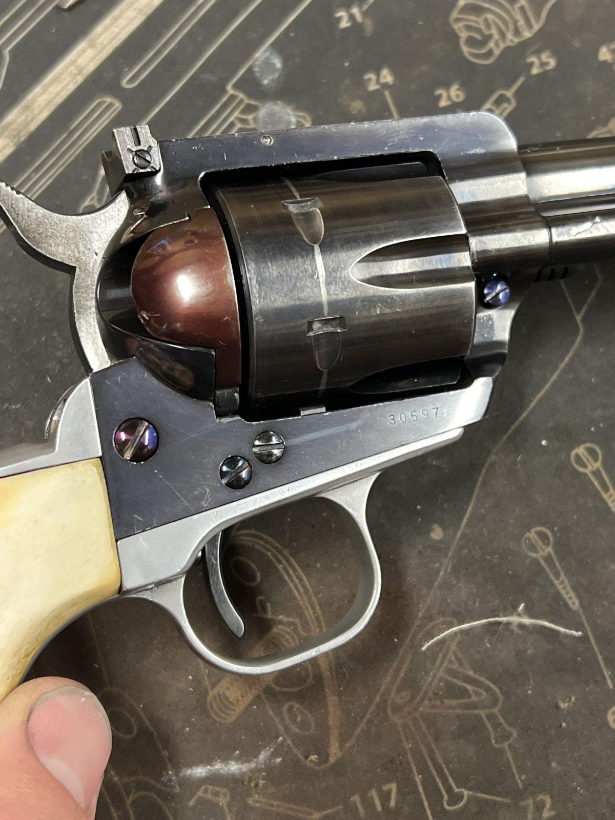

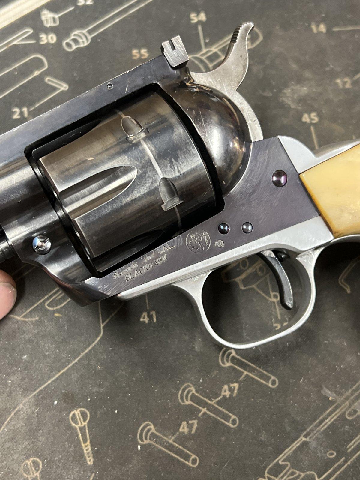

Well, the stainless on my Blackhawk doesn’t take heat like carbon steel! I just went down stairs and tried no dice unfortunately. This is a set I did myself a while ago.
