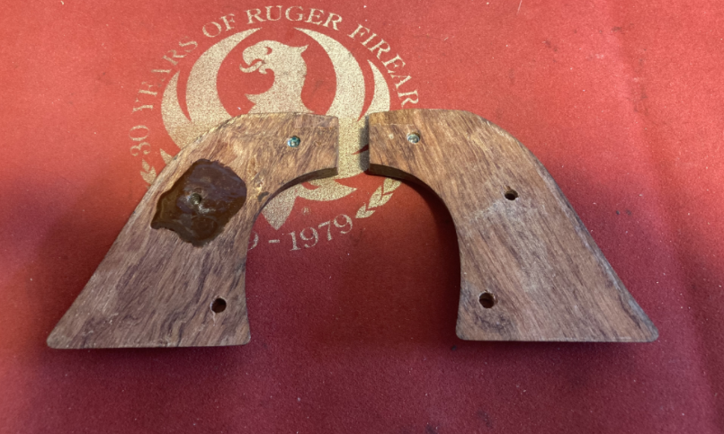

Broken OM Blackhawk grips
Looks like someone over tightened the grip screw. Someone also did a really crappy repair.
They can be salvaged but you will have to remove all the old glue, remove the split pieces, clean them and use a two part epoxy specifically used for wood stocks.
Once epoxied it would have to be clamped till cured.
Once cured the surface would have to be filed, and then sanded flat again.
I can't really discern the level of damage, but I would think that spreading a light 'coat' of Acra Glass (or even JB Weld) over that inside damage would hold it together forever.... (???)
J.
Level of damage looks like death sentence to me ….. it’s how I got them …. Just didn’t want to throw them away if somebody has a use for them
First one who wants them I will gift them to you. PM me your name and mailing address.
My wife repaired a similar set years ago. I have faith she can fix this set as well. Thanks

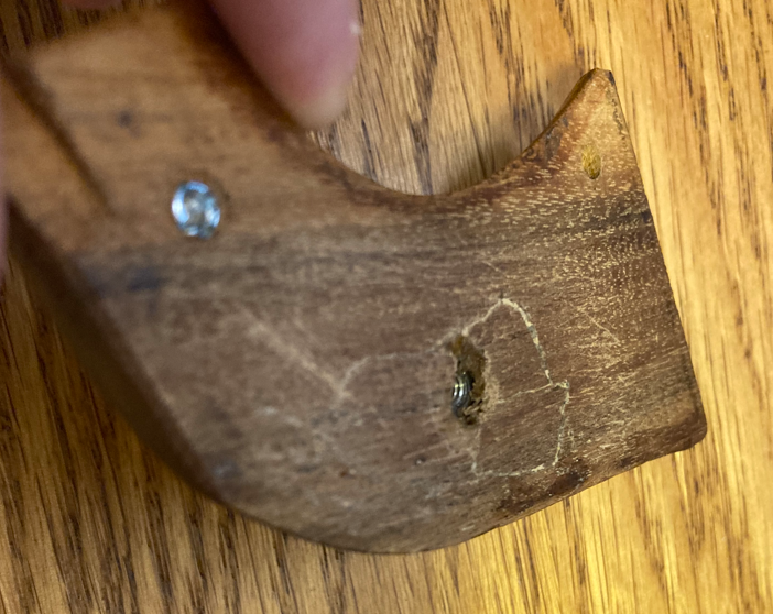

FYI, you can get appropriate diameter spacers at Home Depot. They have them in aluminum, as well as plastic (which will work as well and may be easier to fit length-wise). They are in the hardware dept in those drawers with various nuts, bolts etc.
J.
I'm a bit late to the thread.
Sadly,, many of us have seen this damage to wood grip panels on Rugers way too often.
Yes,, as noted,, they can be repaired, but it takes a good knowledge of woodwork.
I'll agree that the spacer idea is excellent. Long before I knew Cary C,, and his making grips,, I was adding nylon spacers inside my Ruger SA grips. One thing I often found was that the 1/2" length was just a few thousands too long. it wouldn't allow the panels to seat w/o some movement. The grip frames were polished just a hair under 1/2" wide.
So,, I'd take the nylon spacers, GENTLY grind or file away about .005 off the length. Perfect in most cases.
Yes, very nice!
I have noticed that occasionally there's enough tolerance variation in grips that the grip screw will just clear the mainspring seat feature in the grip frame, sometimes not enough to allow a spacer. I have more than one set where I can just get the screw to pass and still align with the other screw hole with the screw rubbing on the spring seat. I suppose I could file a little off the seat, but . . .
