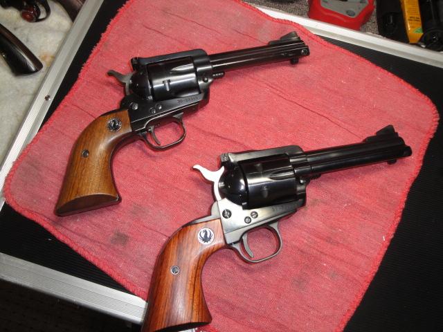

Well, not sure this will help but here are mine. 6.5 bbl Flat top,(28342) two 4/58 bbl(30-72903, 30-53369)
    570 KB

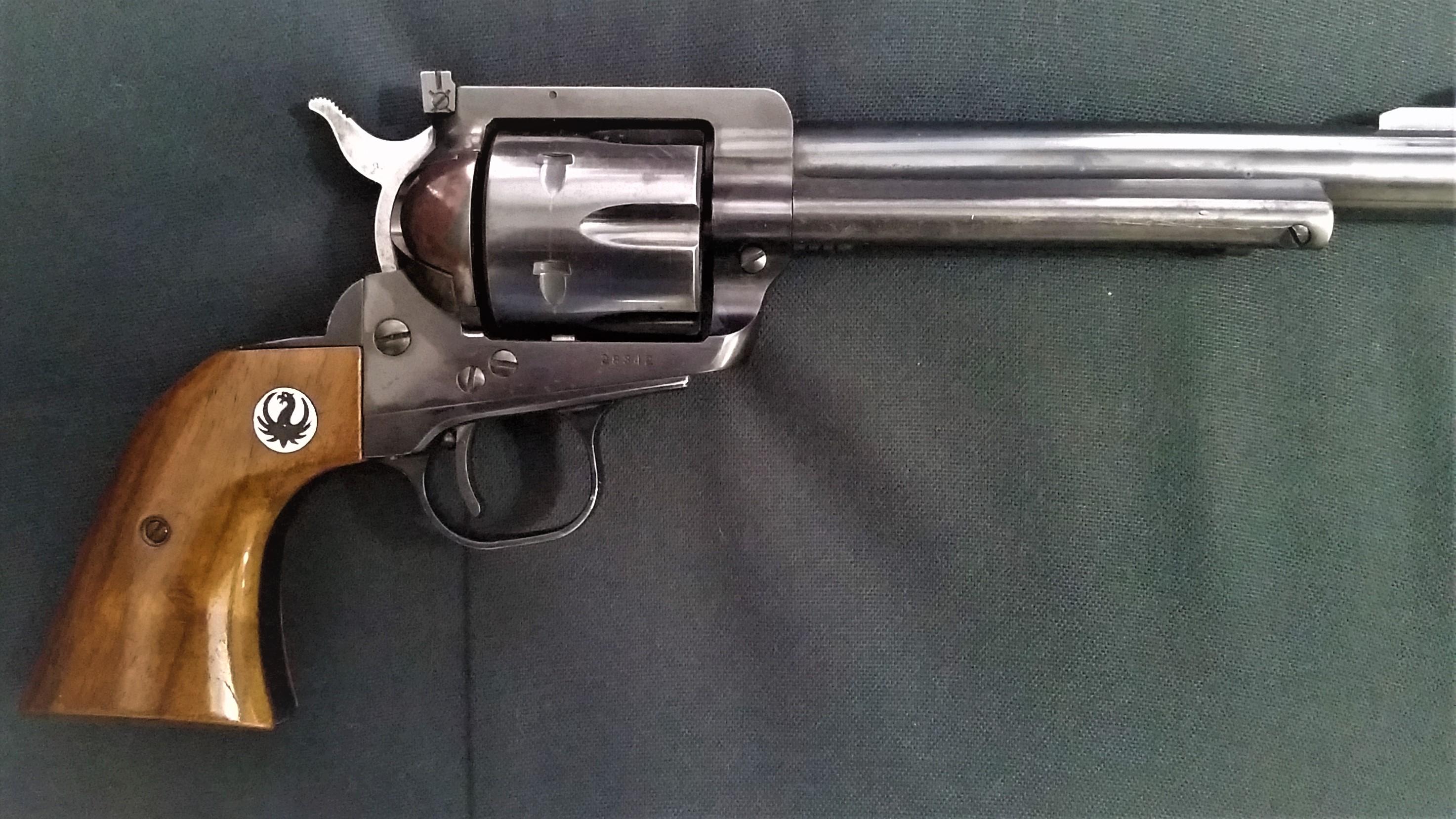

    67.7 KB
30-38658
6 1/2”
Been converted to 9mm looking for a 357/38 spl. cylinder if you know where to source one?
30-38658
6 1/2”
That gun falls on The List right in the midst of a whole bunch of .357/9mm convertibles so I have entered it as such, but noted ".357 cylinder missing". You might find a .357 cylinder here in the Classifieds. :)
