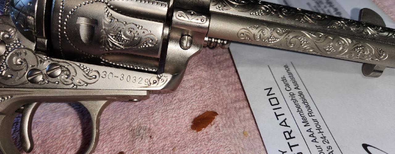

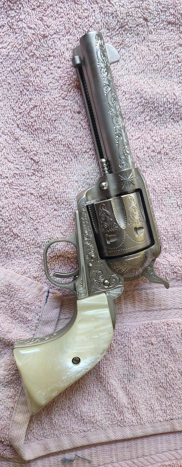

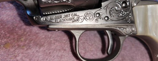

Has anyone ever seen a Ruger like this one? It has extensive engraving, including the words 'Blackhawk' and 'Ruger' on the left side of the frame and what looks like a serial number on the right side.
Based on my limited knowledge, this is really rare or really a fake.
Can anyone provide any insight?

Does that mean that Ruger didnt actually produce it in this fomat?
Someone (post production) took a Blackhawk, modified the sight system/picture, and added a bunch of engraving?
Any idea how many of these might exist?
That particular Blackhawk is from 1970, and its Old Model, Converted?…it appears to be the original Old Model action. A picture with the hammer cocked will tell for sure. Some sort of plating, maybe satin nickel,,, Keep in mind no stainless in 1970.
Somebody spent some good money$$$ to get themselves a dressed up Vaquero.
It's been said there is no such thing of a "Old Model Vaquero" NOW you can say "wanna bet" 🧐
Ruger didn't make em,,, True,,, but whom ever did that on sure looks like a nice job.
To answer or clarify, YES the adjustable sight was removed, welded up the top strap, then contoured it to Vaquero style top strap, and installed a front single blade, then plated it to cover up the work.
“Ruger, Blackhawk & 30-30328” (yes SN#) was put on by Sturm Ruger when the gun was originally made.
Fake, I wouldn’t call it that, A Very Nice Custom Build, YES!
Please post more pictures for us to enjoy.
Welcome to the forum and way to show up with a gem.
Very nice! Someone spent a pretty penny on that one. 💰
No. Ruger isn't responsible for the final format on this one... It's been altered.
From the shape and position of the trigger, this one also hasn't been converted. 👍
Pull the Grip Panels and look for hidden makers mark, engravers mark, plating mark, etc.
Be real careful with those grips, while very pretty, they are usually a just a fragile, don't over tighten the screw.
No Ruger never made a 3 screw fixed sight center fire. Your gun was altered significantly but in an interesting way. The market for that one would be based on someones desire for such a variation. There is no method to compare prices.
Custom.
Began life as a common run of the mill Blackhawk.
Depending on the material, the grips may be worth as much as the gun.
But some folks like ‘em all scratched up and modified that way.

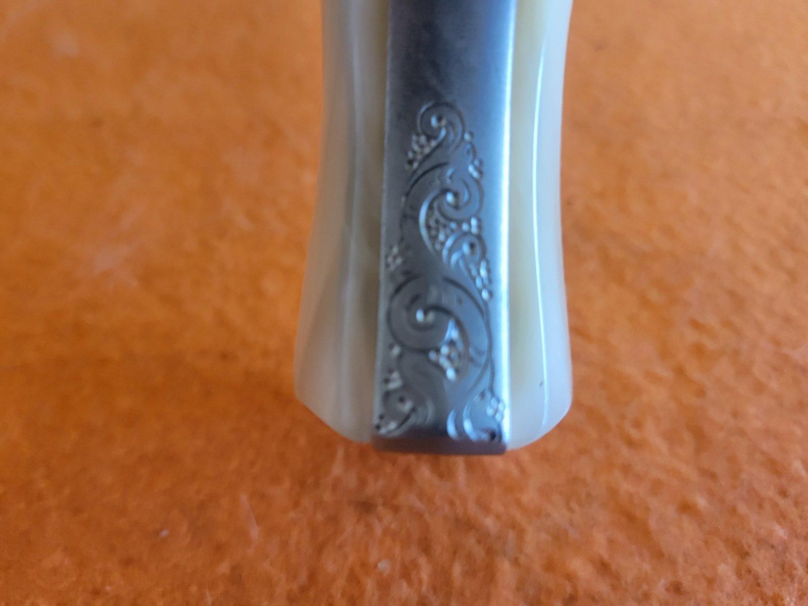

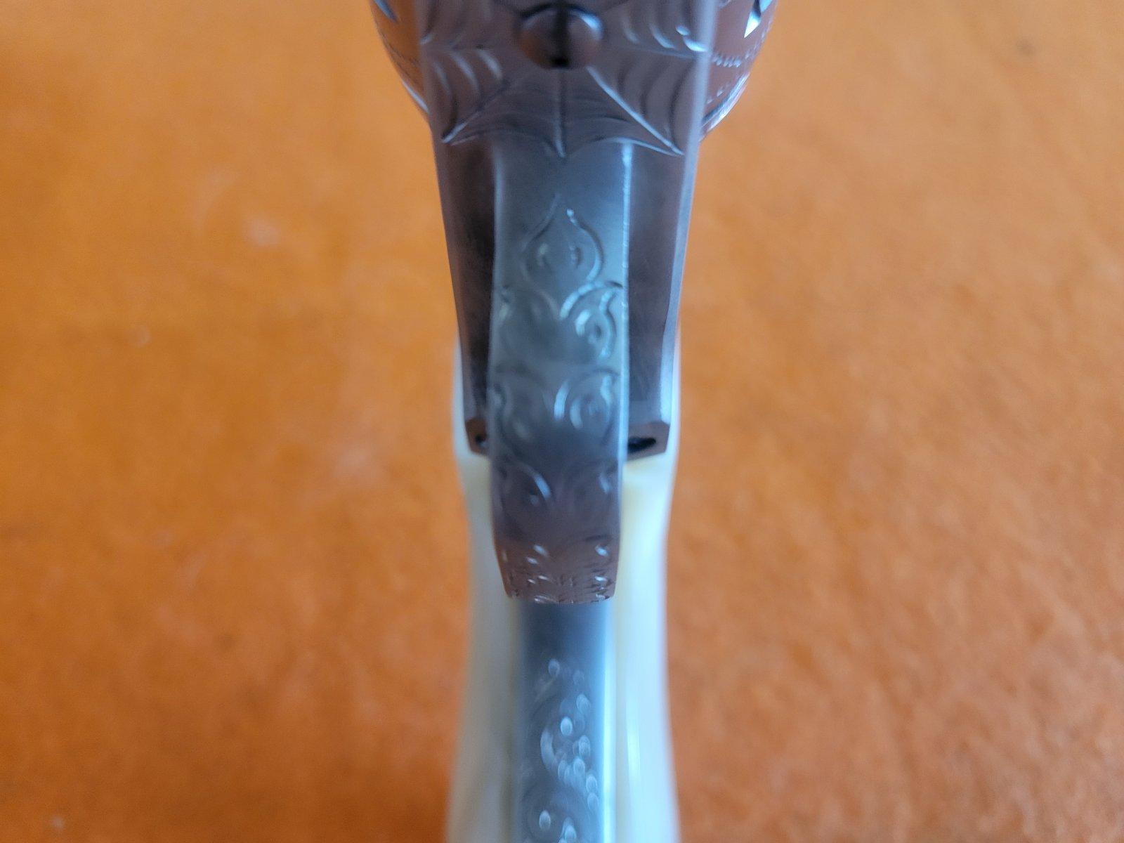

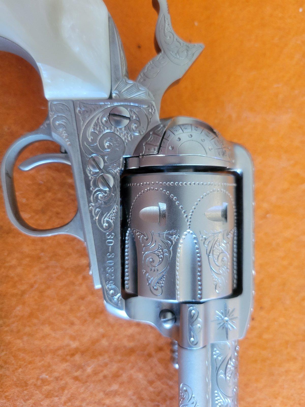

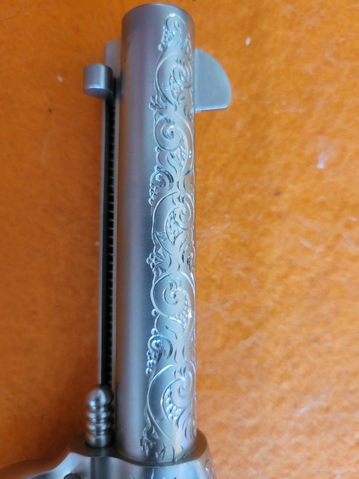

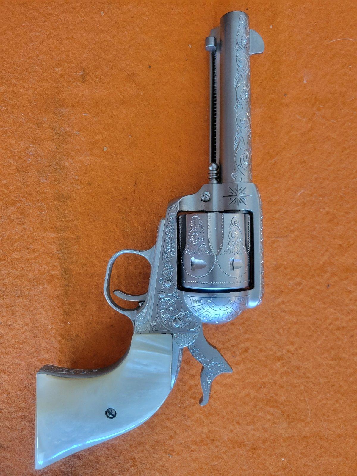

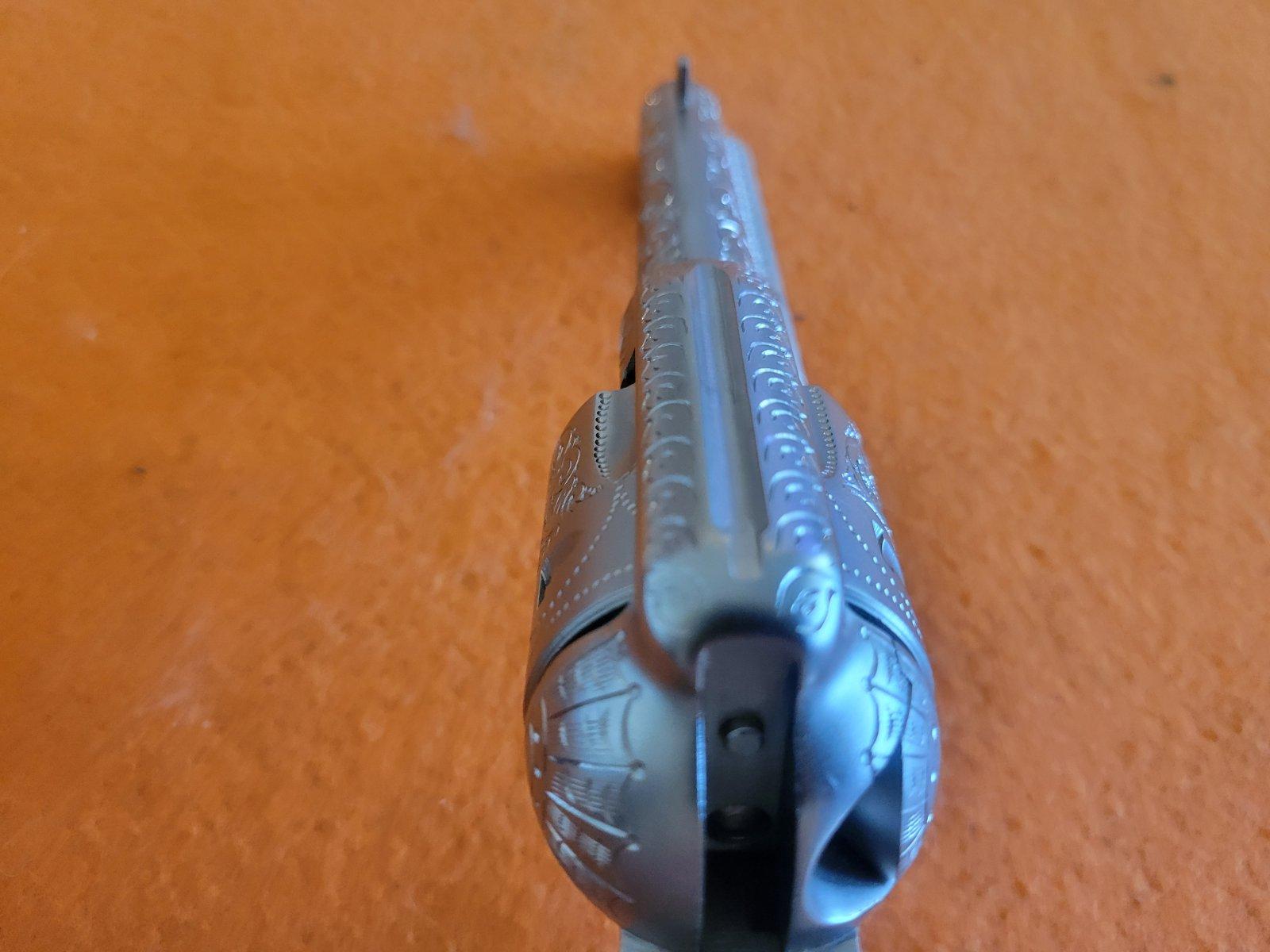

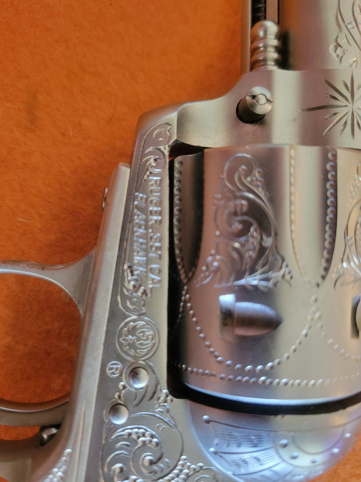

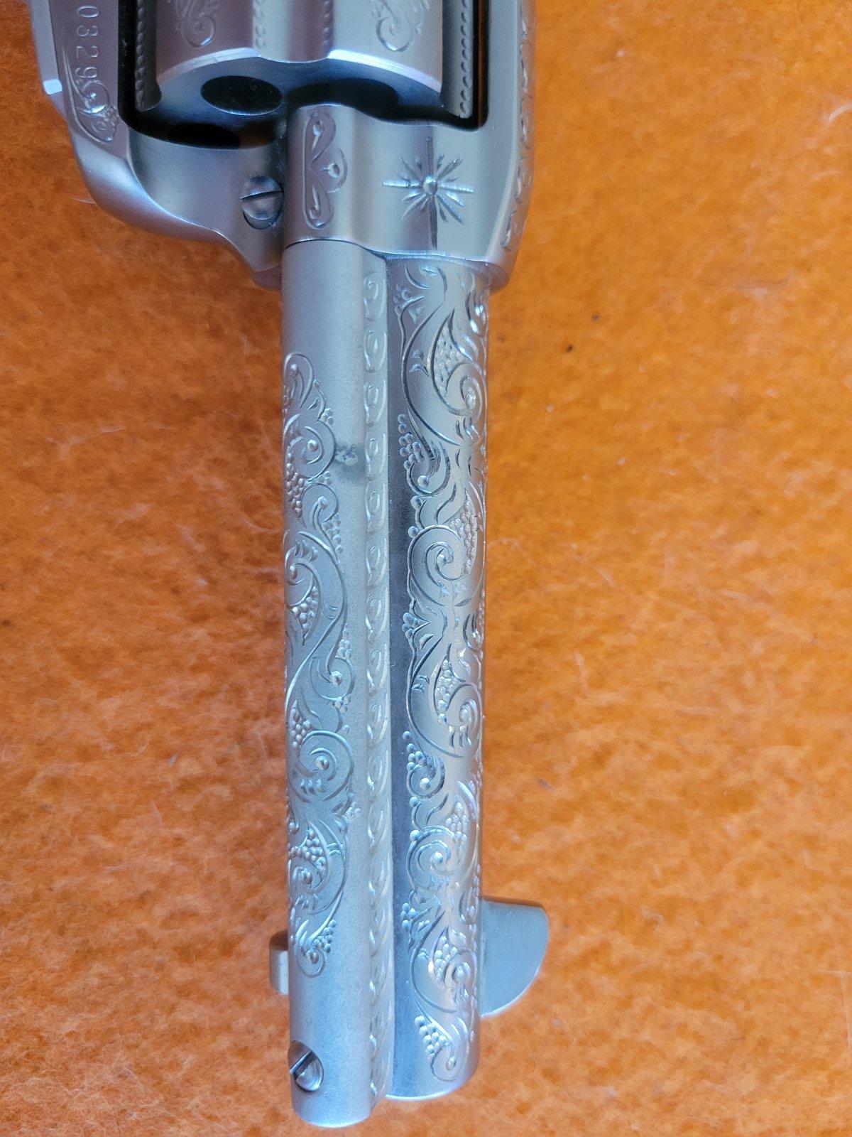

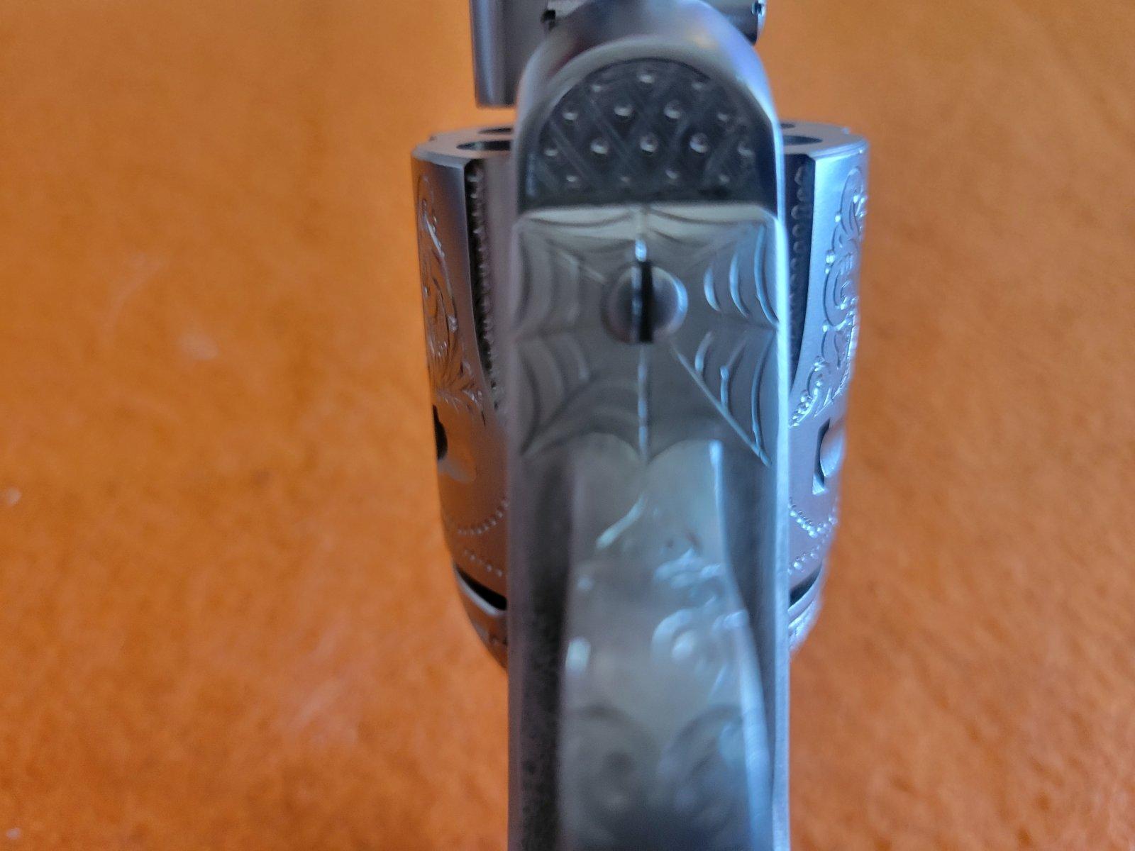

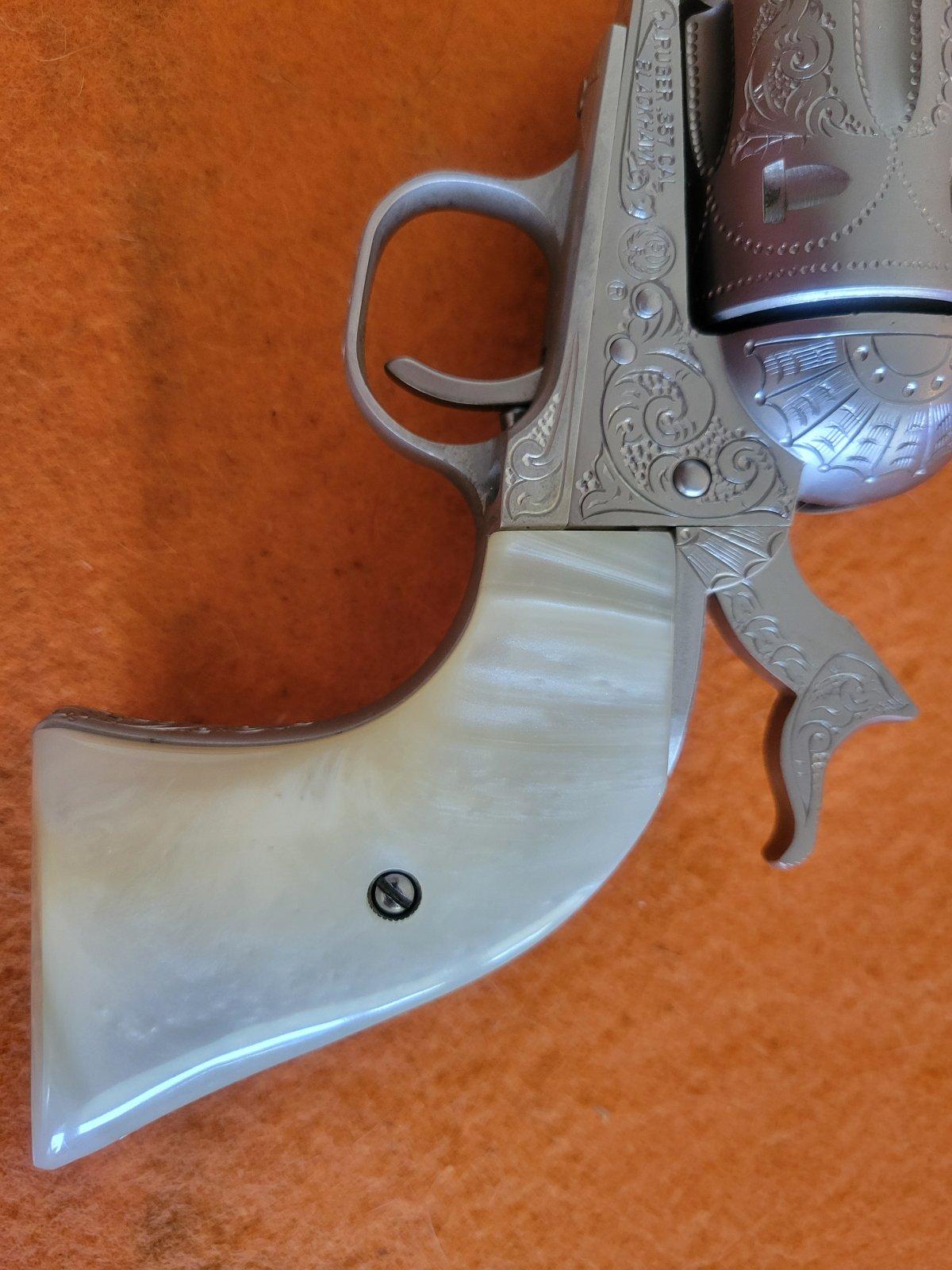

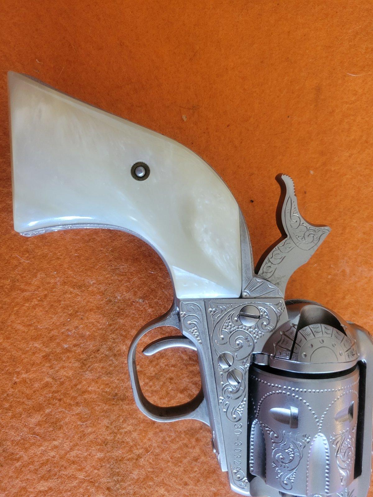

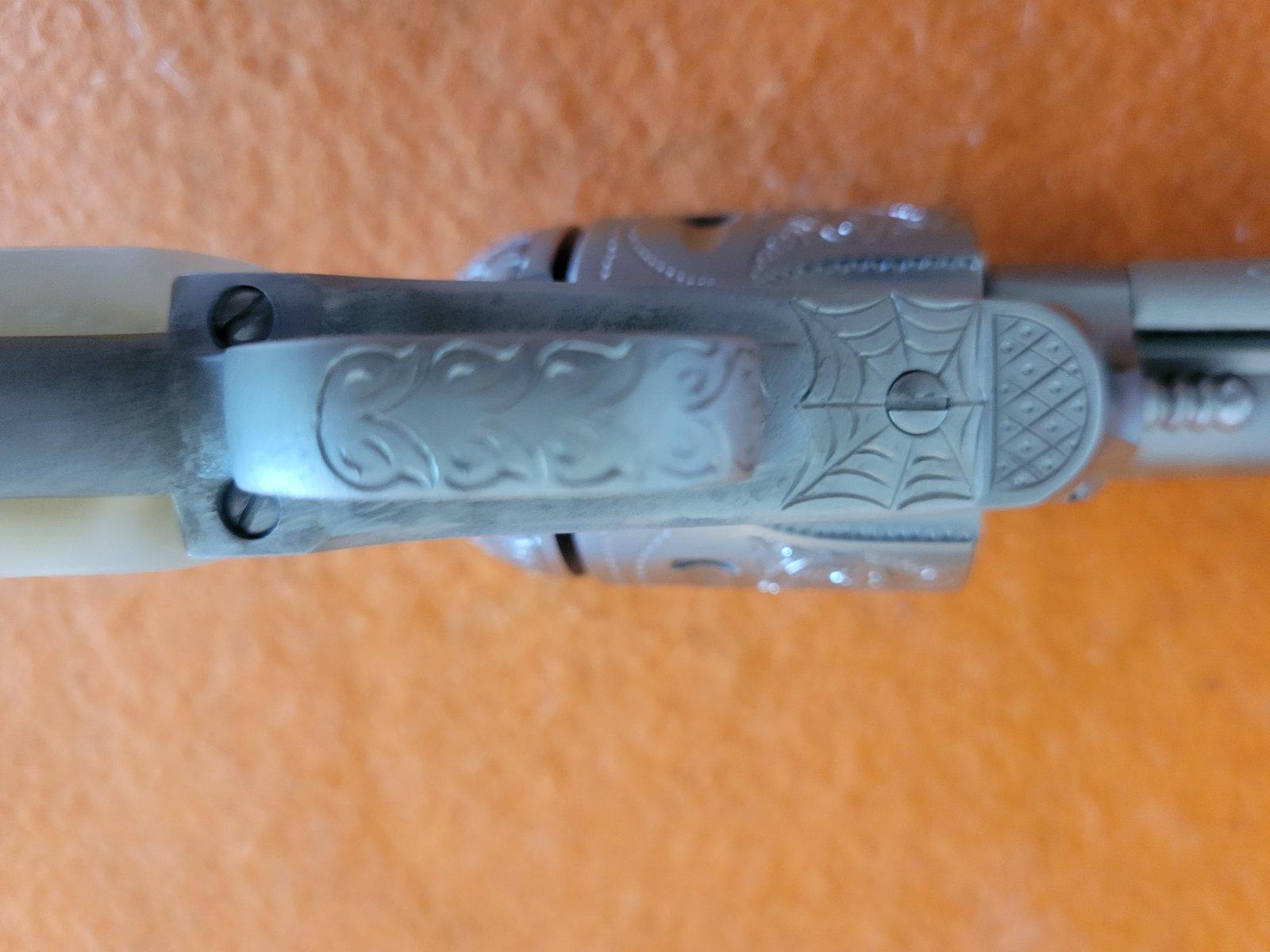

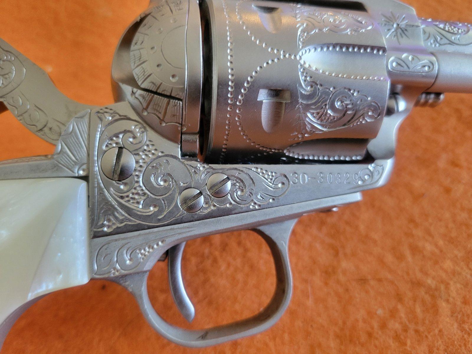

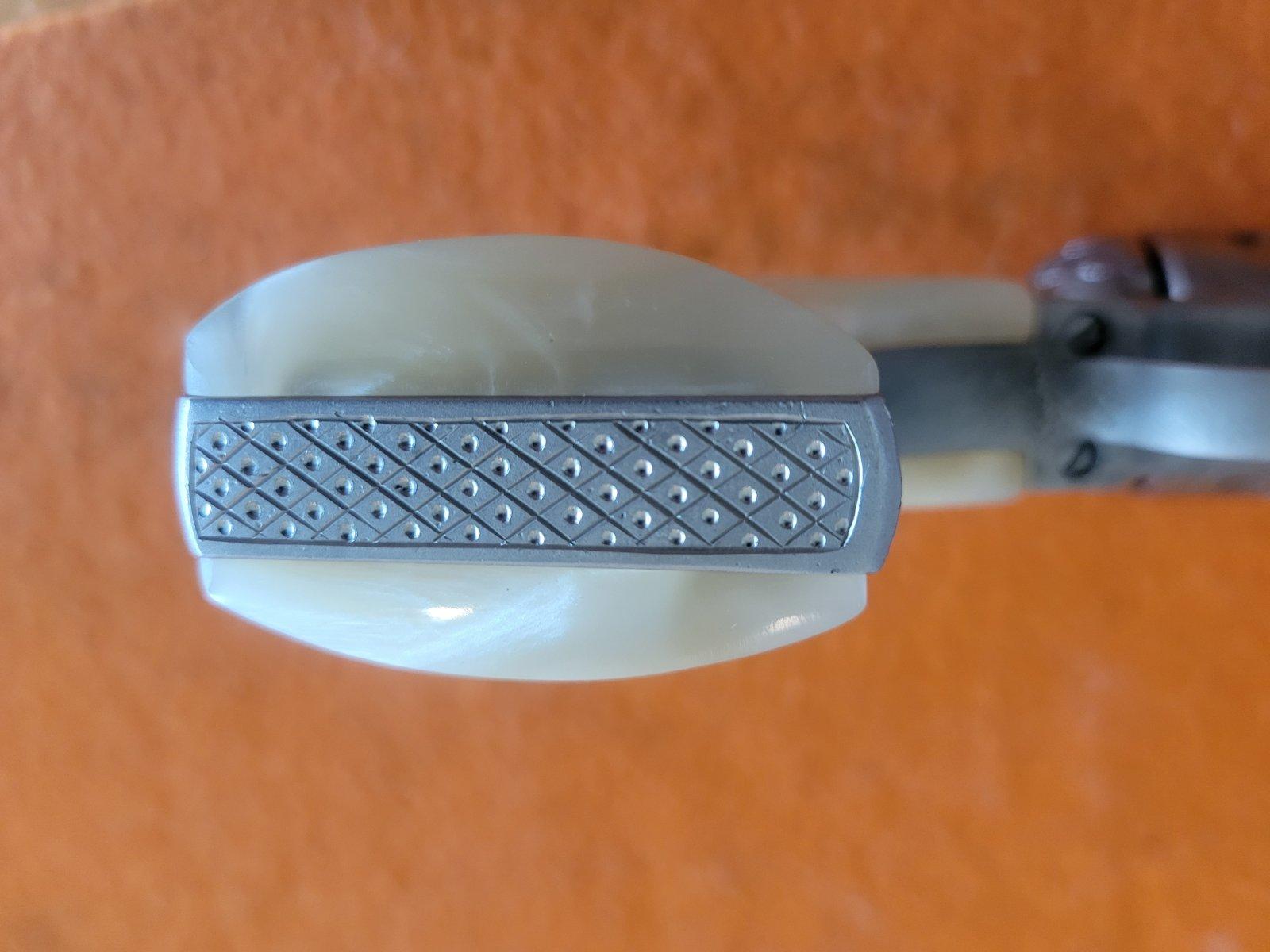

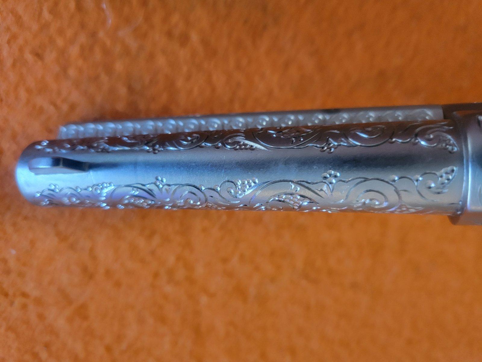

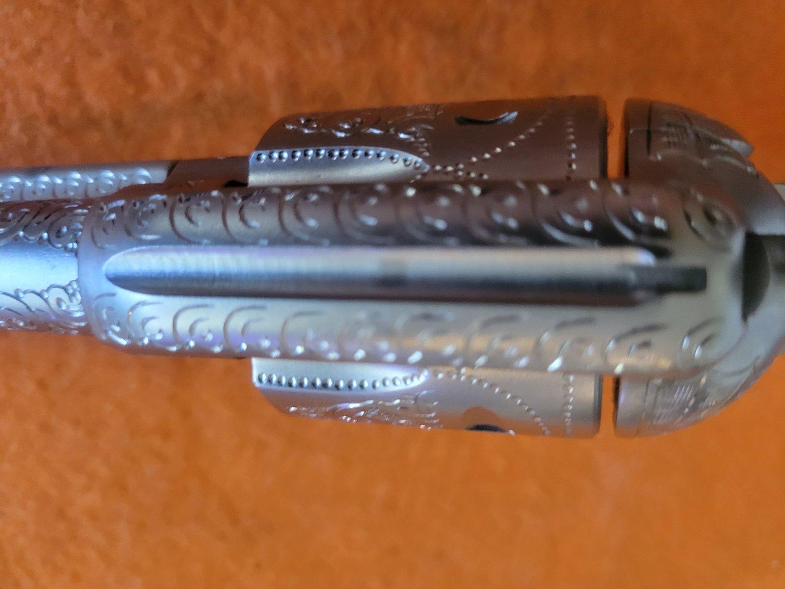

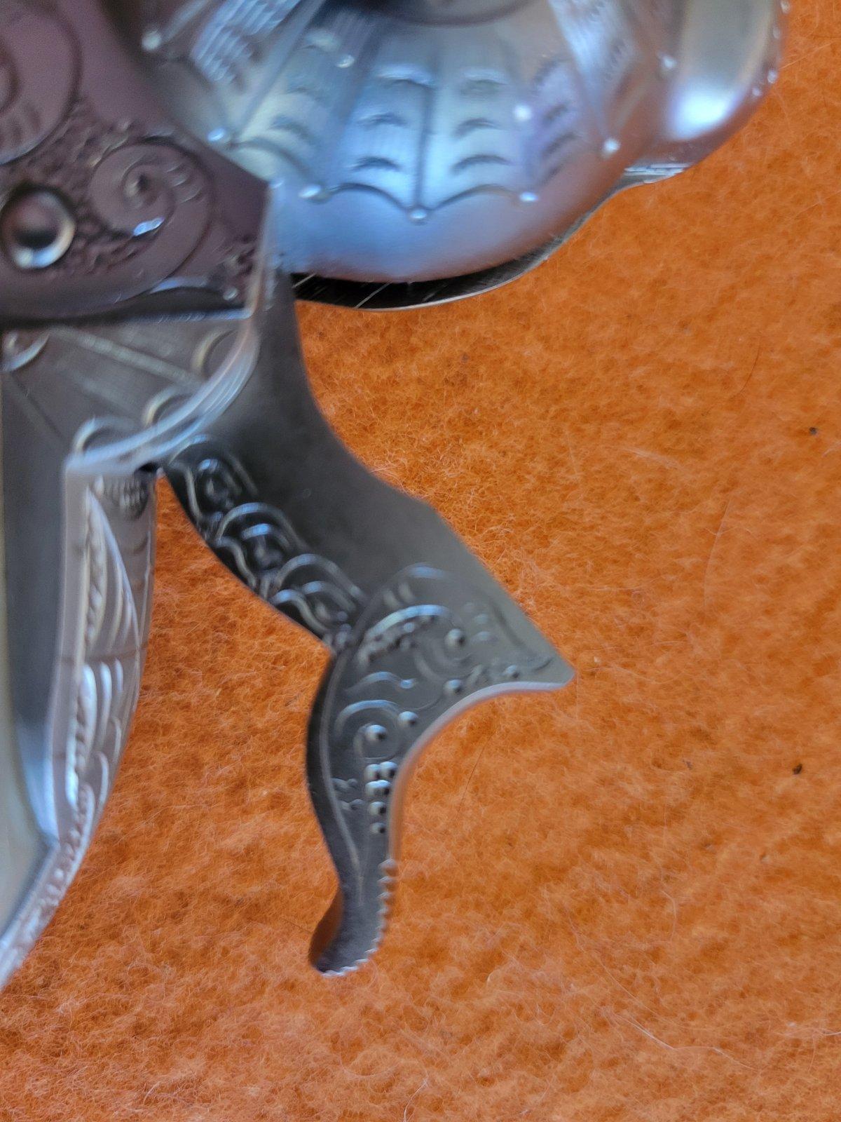

Hey folks,

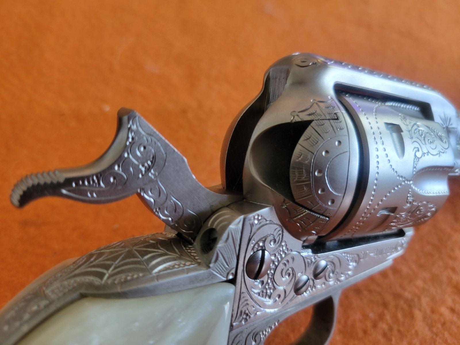

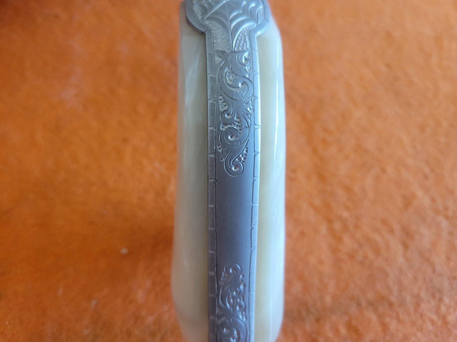

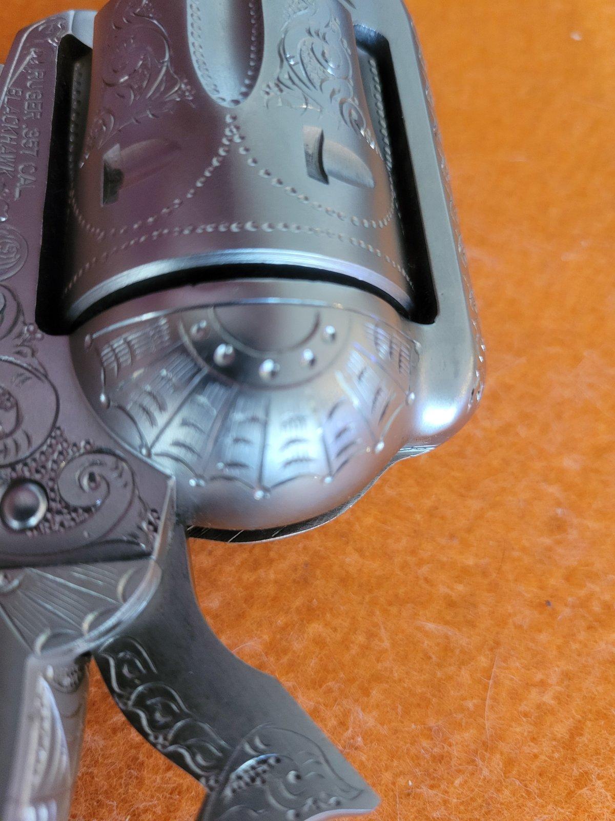

I finally got around to taking more detailed photos, especially the engraving.
The story goes that the guy who did the work was a government "engineer" from north Alabama who would occasionally do commissioned work like this. His job took him to some places where he was in the line of fire. Can't verify the story so I'll leave it there.
It was commissioned to celebrate some aspect of the Spiderman franchise, to which th detailed engraving alludes. Supposedly, there's a mate to it somewhere.
Anyone who could suggest a fair price (no commitment) would be very appreciated. I realize it's only the uniqueness which gives it value. I have a member who's shown interest, but we haven't discussed price. I'm simply looking to get some ideas about a 'fair' price (bigger than a breadbox, smaller than a barn).
Thanks for your thoughts and interest.
Enjoy the new photos !!

"Ruger, Blackhawk & 30-30328" (yes SN#) was put on by Sturm Ruger when the gun was originally made.
Fake, I wouldn't call it that, A Very Nice Custom Build, YES!
Zoomed in, the ser # appears to be 30-30329. Pics of cocked hammer reveal that it has NOT been converted.
And yes, a beautiful effort. 😁

Gorgeous gun, but I think your price is way too high... It would scratch a recent itch I have, but I still wouldn't pay half of what you are asking. IMHO, FWIW.
Bright chrome, straight out of the bumper shop. I hope the "donor" OM was beyond salvageable.
