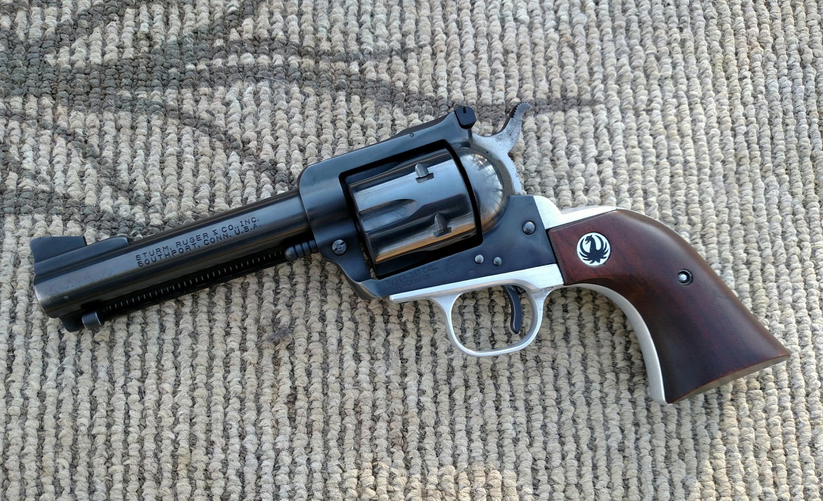

9mm ball ammo with .355 bullets is usually only good for minute of 6" steel plate with carefully aimed firing at 25-50 yards or so in my experience, but carefully tailored handloads, with properly sized .358 cast bullets (as well as properly adjusted reloading dies) have provided some rather outstanding accuracy in my favorite 3-Screw 357 Blackhawk. In fact, this outside sourced and fitted 9mm cylinder has been in place for several years now...And has provided me with much shooting enjoyment. 😉

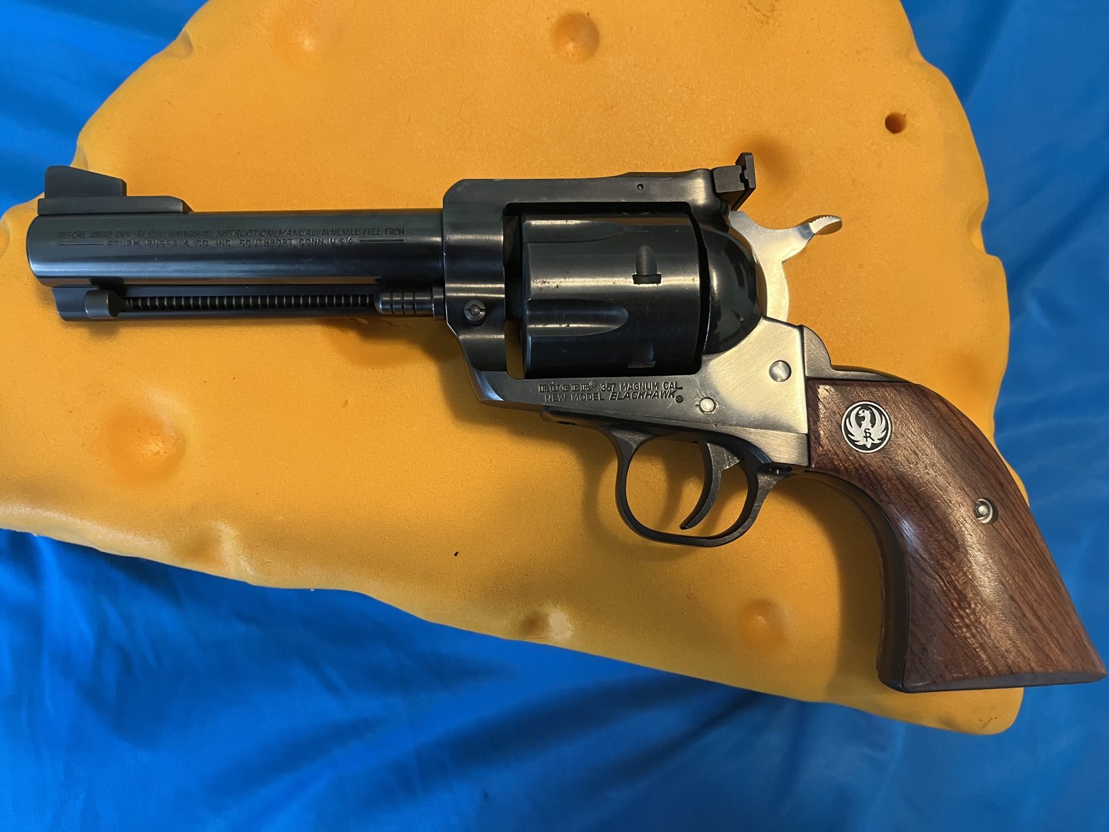

Last Monday I was hitting “Minute of Bowling Ball” at 50yds with both cylinders off hand with BFR rear sight (modified) for fixed front sight. Also has the tasty super Blackhawk hammer.
