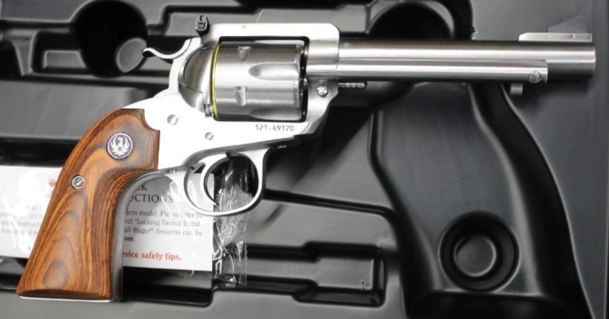

And here is one of the NEW Medium Frame Bisley 41 Magnum, same size as your NM 357 flattop. (Not my gun, stolen picture)
